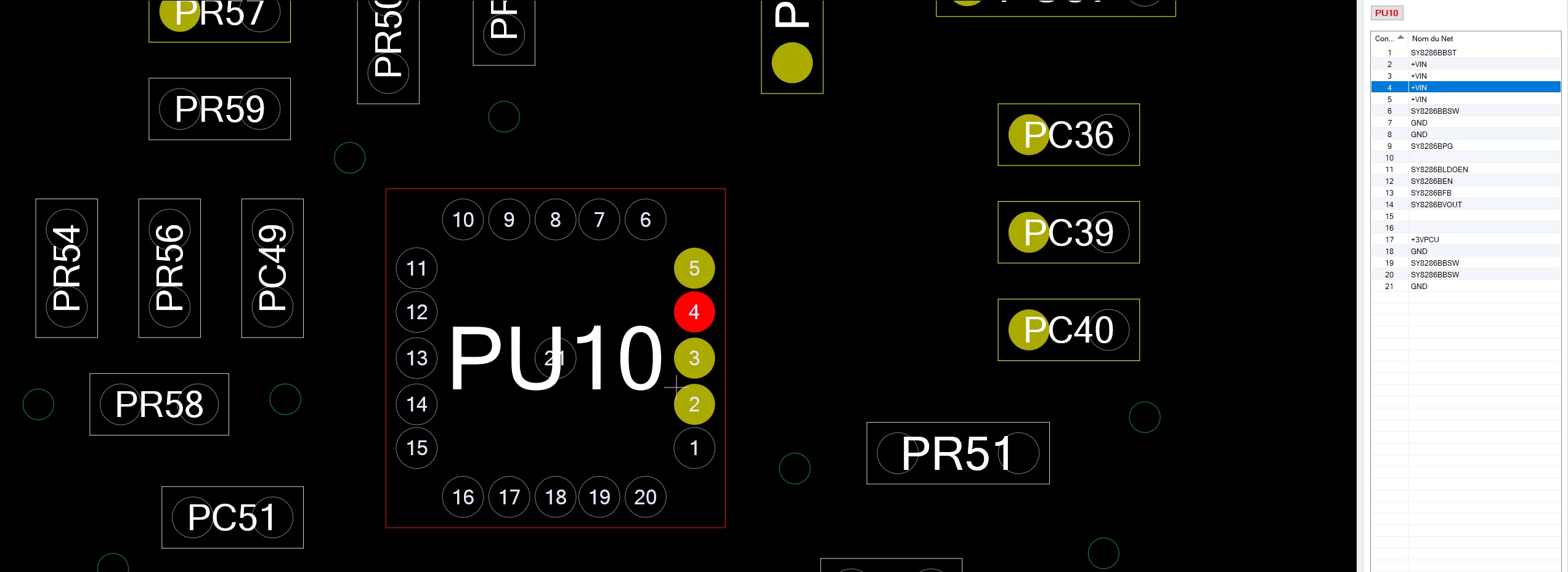

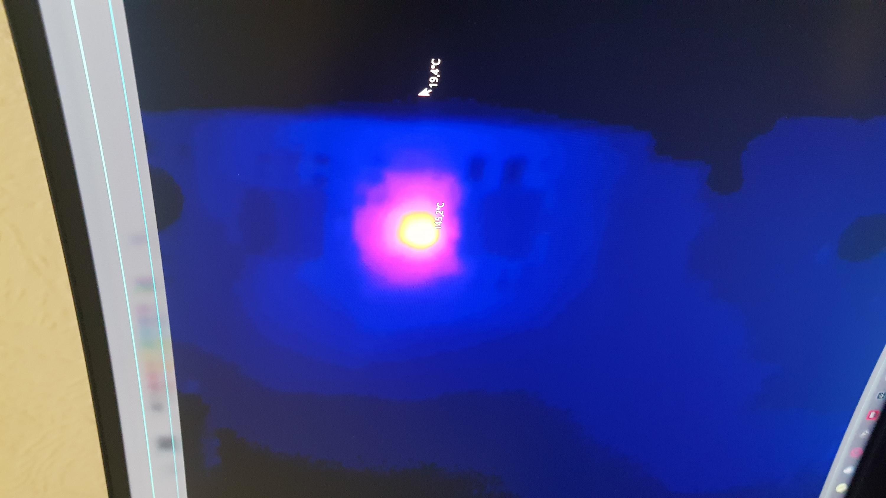

    I have a motherboard from an HP that does not start.
    This is a GLA-6L and when connecting the mains which is ok and after checking with the thermal camera shows that the 3volts chip (SY8286BRAC) at more than 100 degrees very quickly which is abnormal and no short circuit on the line after verification.
    Since aliexpress sells a SY8286A chip which is equivalent so I changed the chip for the second time and still the same problem.

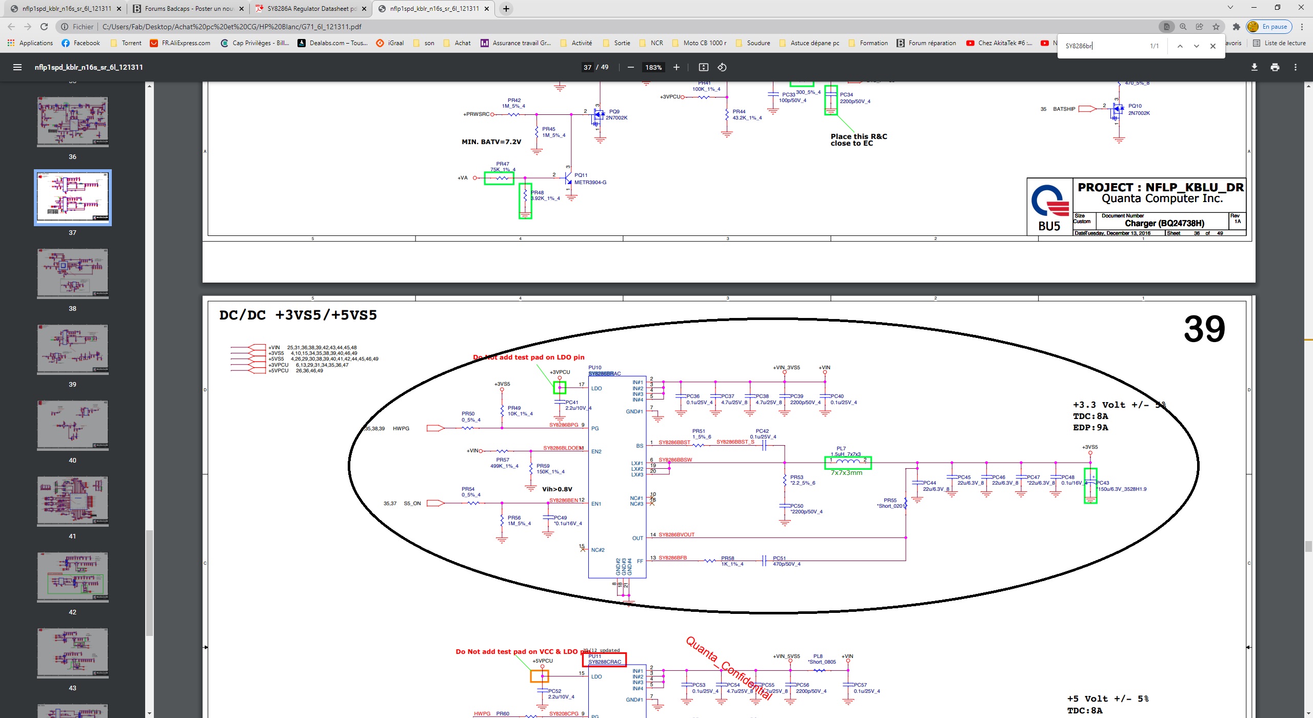

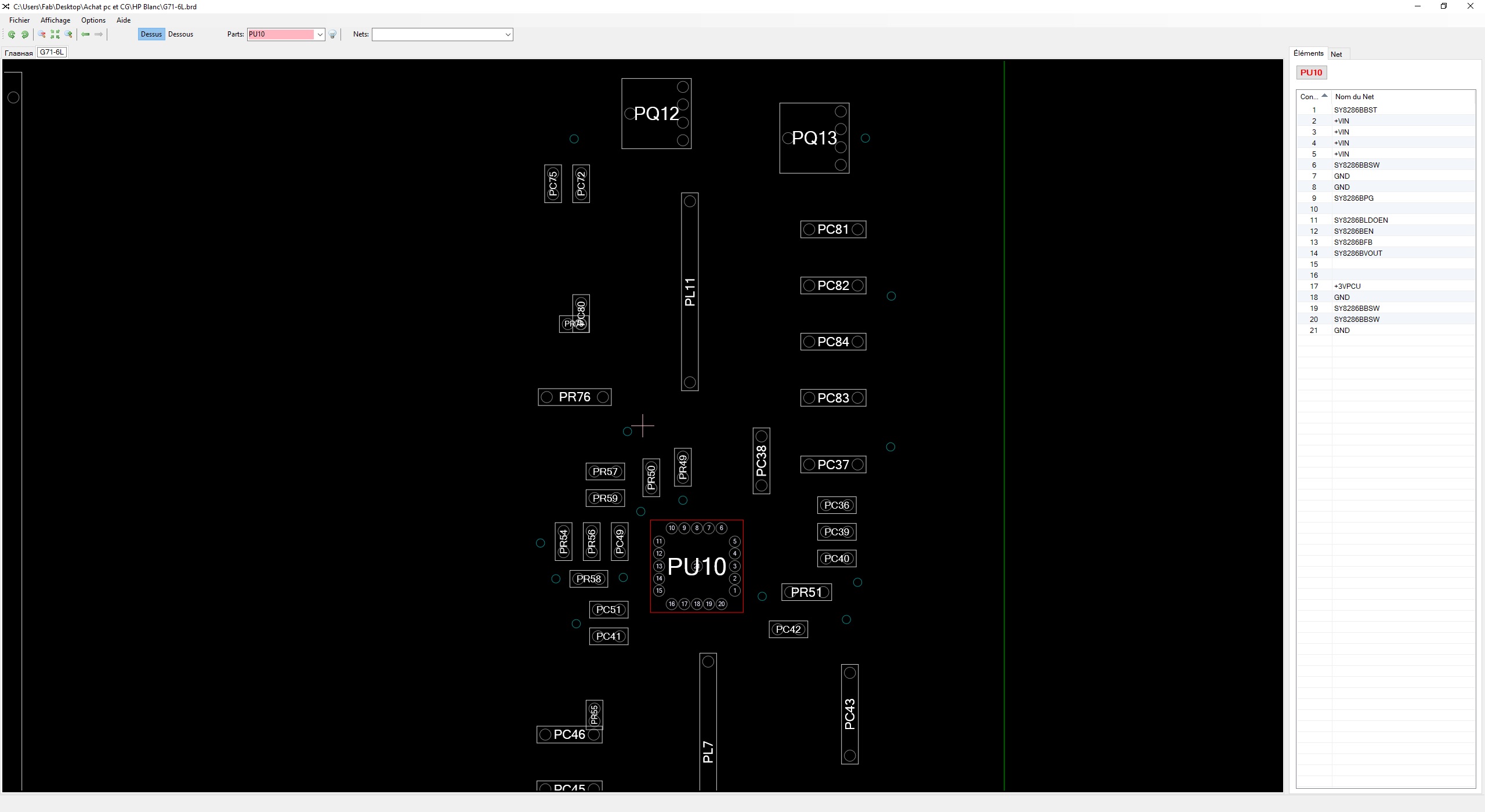

    You can see on the boardview that it is the PU10 chip as well as in the diagram.
    I did not inject current on this 3 volts line.
    I don't understand what is wrong, is it a resistor out of order? What should I do?
    Complete diagram of the motherboard.
    I will be happy to be able to find this functional pc = D
    And ready to answer any questions.
    thank you very much

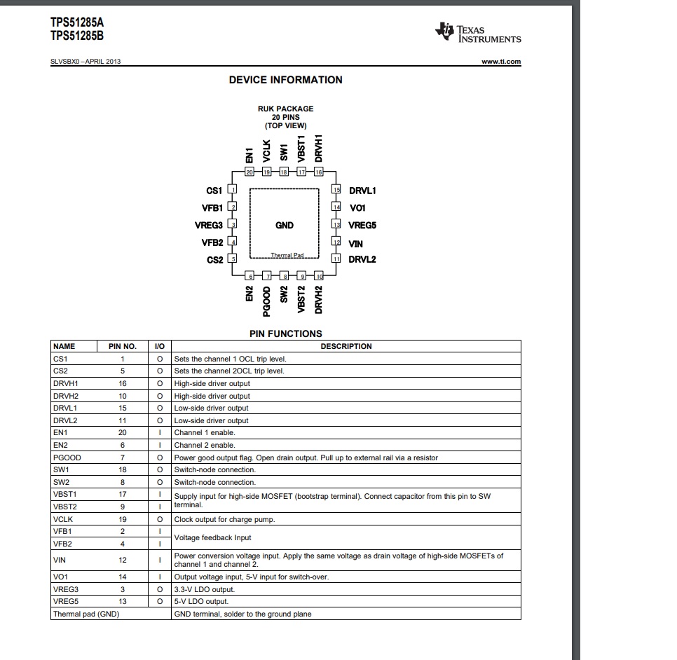

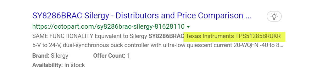

        Yes, I think so. According to the internet, the following part from TI is a drop in replacement for the original:
        TPS51285BRUKR
        See the attached datasheet. Respectively, note the difference between the 'A' and 'B' versions. This could be the fault for your replacement part as well.
        The TI datasheet can be used to determine the details of this IC.
        Respectively, the TI part is rare as the dodo bird so best to go check on Aliexpress for the original part with the proper suffix or order the above TI component from Asia.
        Win-Source is claiming they have the TI part in stock but they are charging an arm and a leg for the device. They used to be a nice company to work with but no longer.

          But one thing I do not understand on the datasheet of the TPS51285A or B does not seem to correspond to the diagrams and there are not 4 lines (pads 2,3,4,5) +VIN contrary to the SY8286BRAC chip (See boardview).
          On the TPS51285A/B there is pad 12 which has the VIN.
          Normally I should have the same thing no?
          Is it possible to replace with a SY8286B found on aliexpress?
          If not, which TPS51285A or TPS51285B chip to install?

              SY8286BRAC & TPS51285 is completely different IC.

                And yet the SY8682BRAC corresponds to the diagram of my motherboard. So which one to choose? Can I try to order and try the SY8286B (Waiting time 2 weeks to 3). The TPS51285A chip looks totally different on the rails. I'm a little lost ^^ and thank you for your feedback in advance

                      You probably have an LDO pin 17 shorted to ground by one of the bunch of components connected to that +3VPCU power rails, most likely this will be EC (IT8987). Measure the resistance to ground on +3VPCU LDO output pin 17 of SY8286B, and if it's low in Ohms, perform a short test on this pin. Read this trainings as it contains a lot of knowledge and helps to understand how to do the short test and what to expect https://www.elvikom.pl/szkolenie-nr-...opow-t986.html
                      SY8286A is NOT an equivalent of SY8286B since entirely different functions of pins 11-15 between them. There is no known equivalent for SY8286B so you must use the original SY8286BRAC chip.
