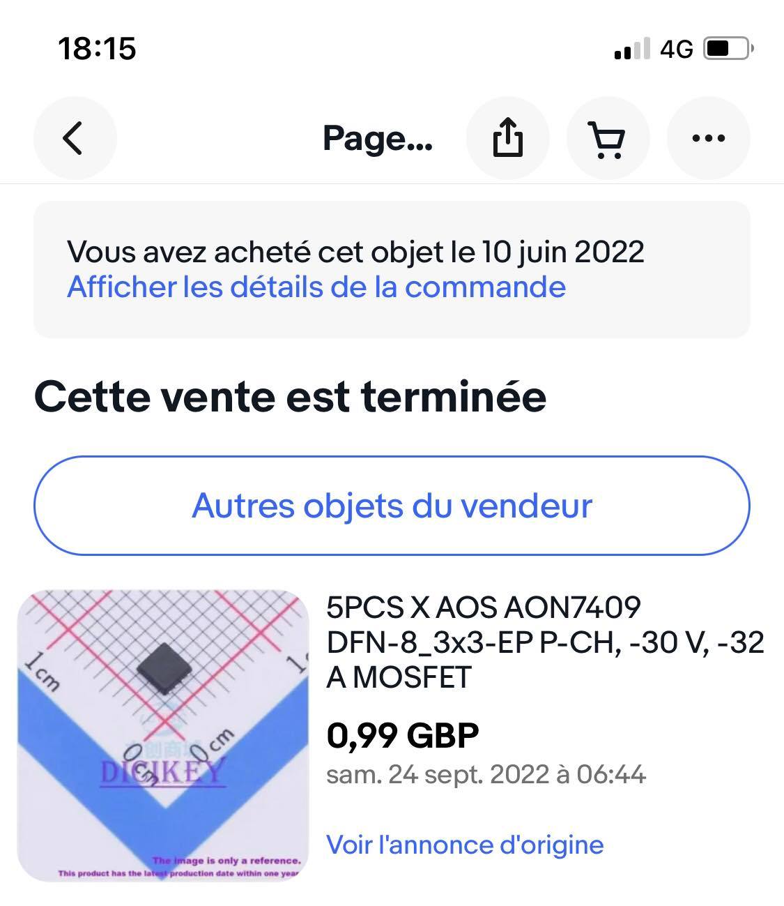

      Yes I replaced all (PQ200 PQ201 PQ207 PQ208 PQ209) aon 7409 P-chanel

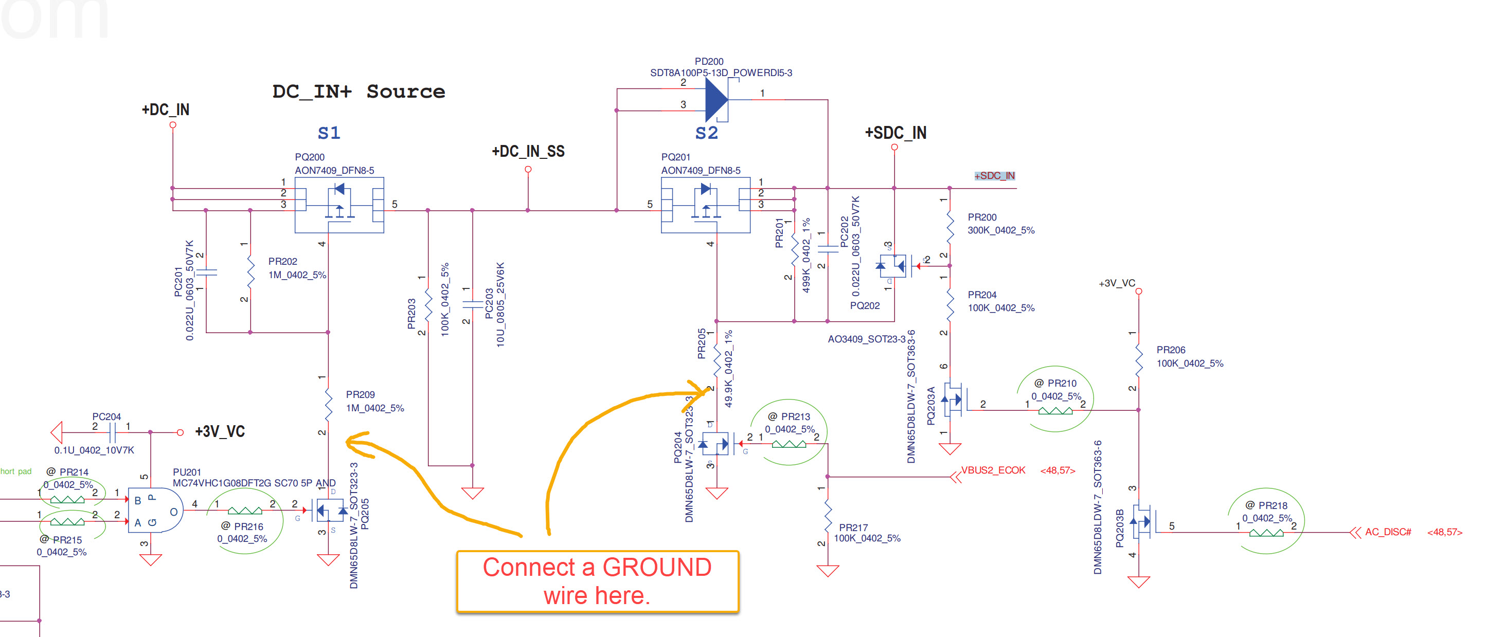

              #46
              Re: XPS 15 9570 will not charge but battery works
              See attached. The GATE pin must be lower to enable.
              Attach a ground wire to the bottom pin of the bottom resistor.
              Test with one mosfet first and see if the top replaced mosfet enables or not.

                #47
                PQ200 SOURCE 19V5 Gate 9V3 Drain 19V5
                PQ201 SOURCE 19V5 Gate 1V7 Drain 19V5
                PQ209 SOURCE 19V5 Gate 19V5 Drain 0V2

                  #48
                  So these 2 DCin mosfets do enable if the gate are at a lower voltage. Good.
                  To enable on their own, the mosfets @ PQ204 and PQ205 must enable.
                  PQ205 is enabled by the EC (MEC5105). Confirm that it is being powered.
                  Specifically, without our manual jumper, the voltage of VBUS2_ECOK must be a high enough voltage to enable the mosfet @ PQ204. Only then will the 2nd mosfet @ PQ201 enable.
                  Respectively, the dual-input AND gate must have BOTH inputs at a logic '1' (PU201) to enable the mosfet @ PQ205.
                  Measure the voltage to ground on each pin of the gate @ PU201.

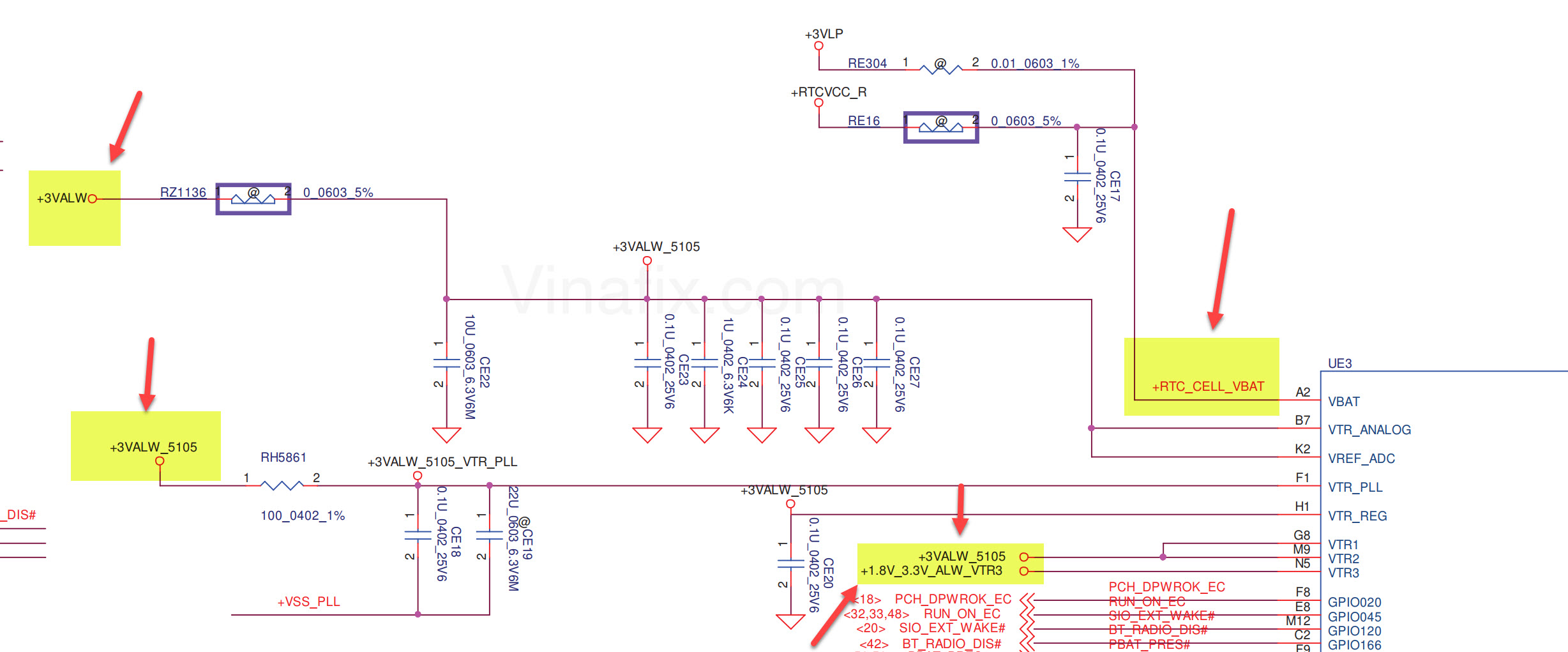

                      Confirm the (EC) MEC5105 is being powered.
                      See attached.

                        #51
                        See attached.
                        Hello to you,
                        here are the measurements:
                        +3VALW 0V
                        +RTC_CELL_VBAT 0V
                        +3VALW_5105 0V
                        +1.8V_3V3_ALW_VTR3 0V
                        so it is not powered, NO short all on the MEC5105

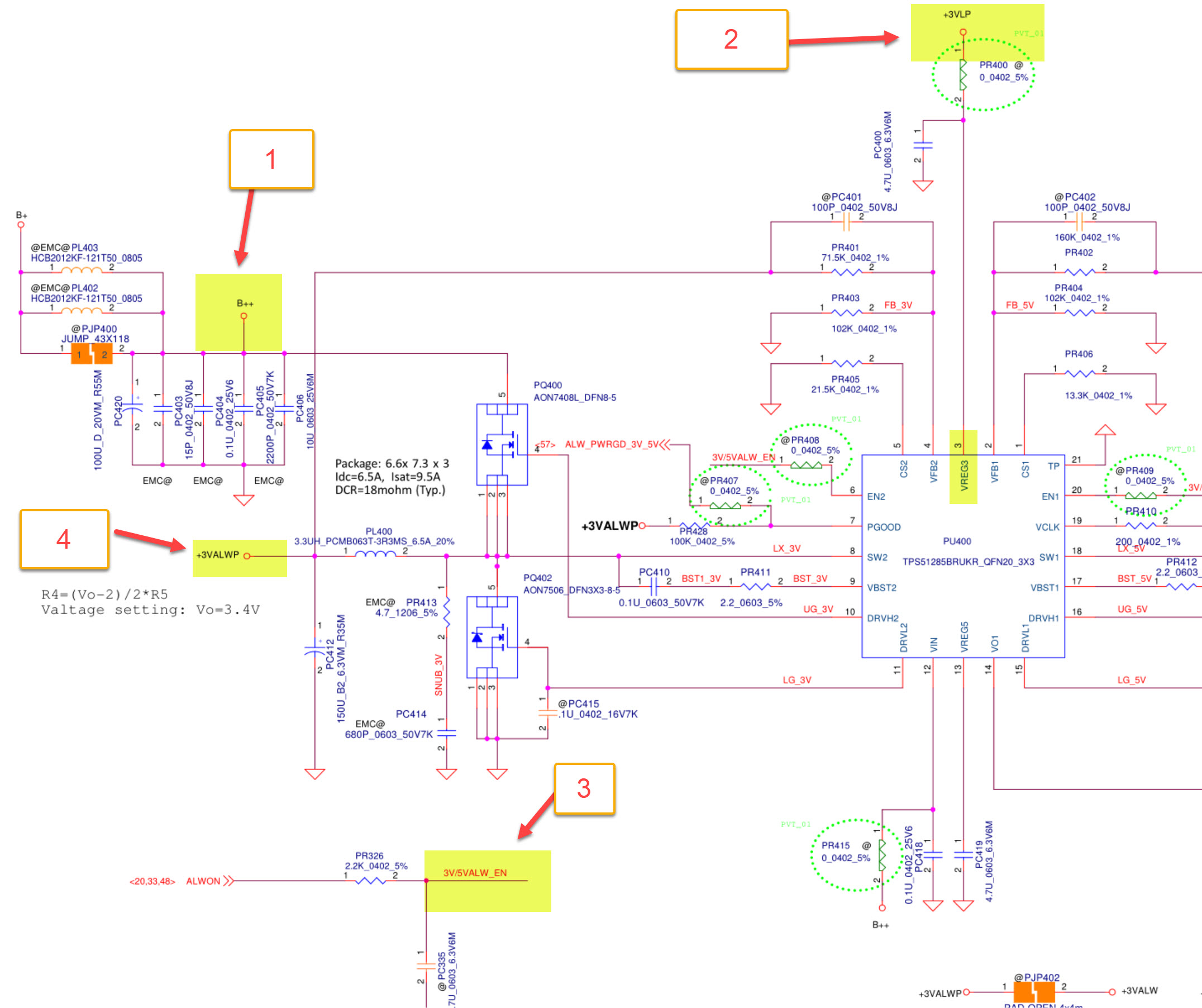

                          Ok. See attached. Check the voltage to ground for these 4 points of interest and post your measurements.
                          • madjid911
                            • Dec 2016
                            • 410
                            • France
                            #53
                            ok. See attached. Check the voltage to ground for these 4 points of interest and post your measurements.
                            b++ 3v29
                            +3vlp 0v
                            +3valwp 0v
                            3v/5valw_en 0v035

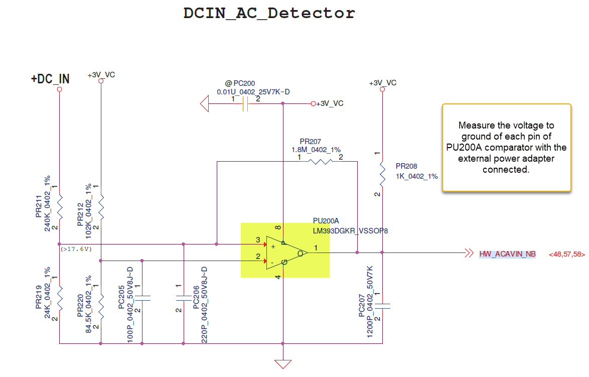

                              Was the external power adapter connected when taking these latest voltage checks?

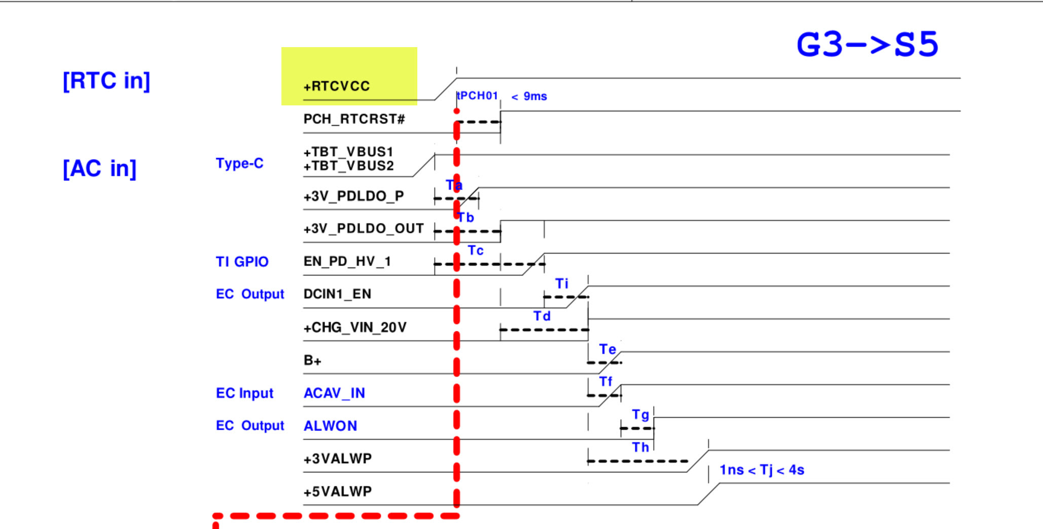

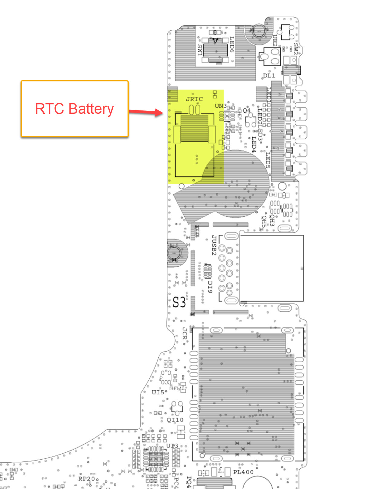

                                Measure the voltage to ground of RTCVCC.
                                This voltage rail is critical and is the first rail that must be present as shown on

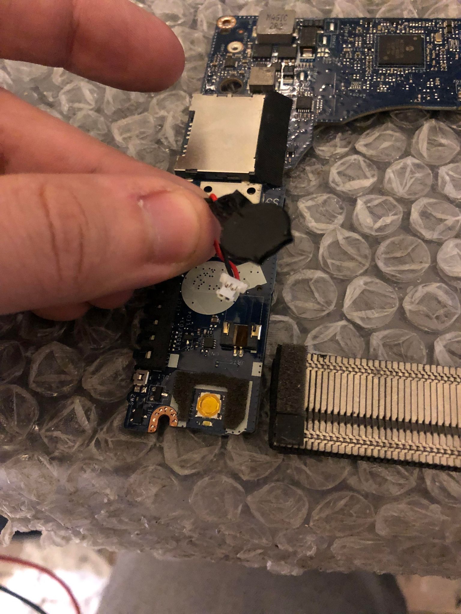

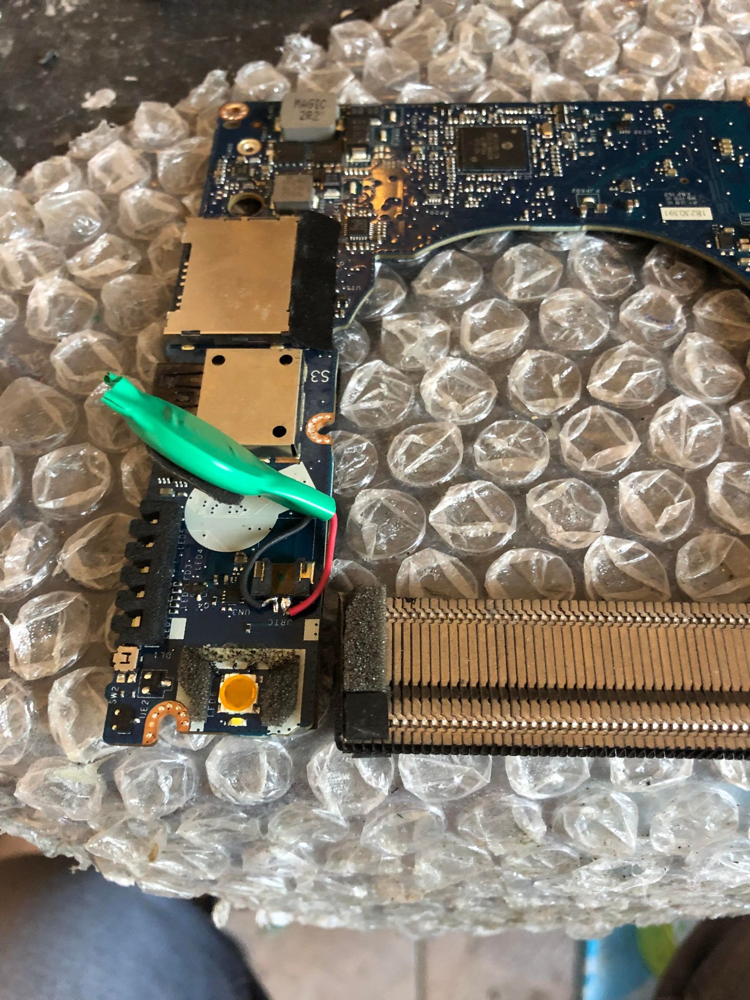

                                  yes the power adapter connected
                                  I hadn't connected the battery 3V, but it is discharged 0V5 instead of 3V.
                                  do i need to find a 3v battery?
                                  • mon2
                                    • Dec 2019
                                    • 14659
                                    #57
                                    The power up rail sequence notes that this battery is critical to the power up of the logic board so yes, do apply an external battery.
                                    If you have a DC power supply that you can dial up to 3v, that will work as well.
                                    CR2032 should be ok to use but not sure if you can solder to the package. Is the battery inside of a coin cell holder under that shrink wrap ?
                                    You must also watch the polarity of the battery with respect to the red and black wires when you are ready to apply onto the logic board.
                                    • madjid911
                                      • Dec 2016
                                      • 410
                                      • France
                                      #58
                                      b++ 0V3
                                      +3vlp 0v628
                                      +3valwp 0v
                                      3v/5valw_en 0v
                                      RTCVCC 2V8 with 3v battery connected (the battery is good at 3v if it is not connected)

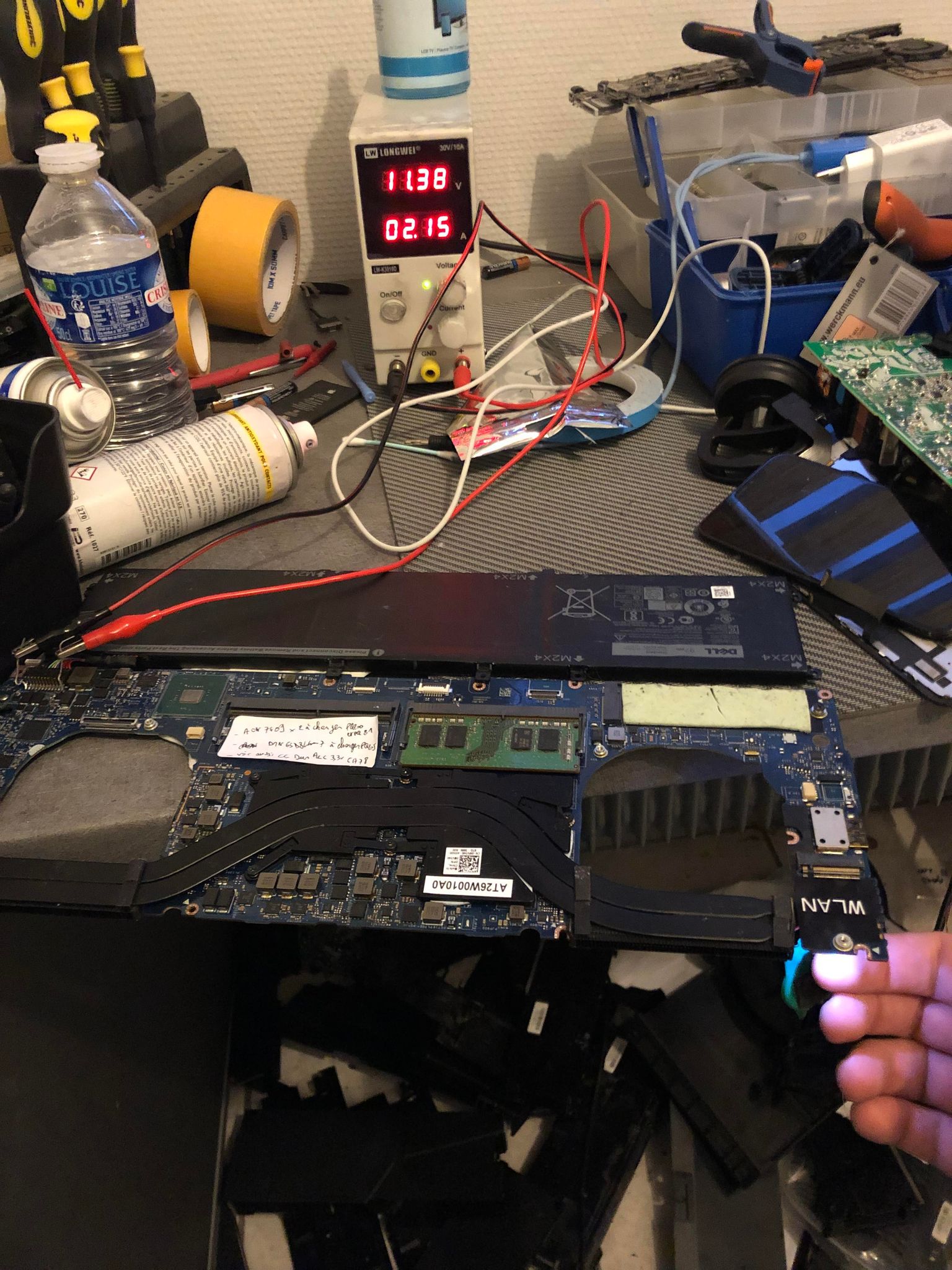

                                        #59
                                        With 11V4 battery it starts without problem

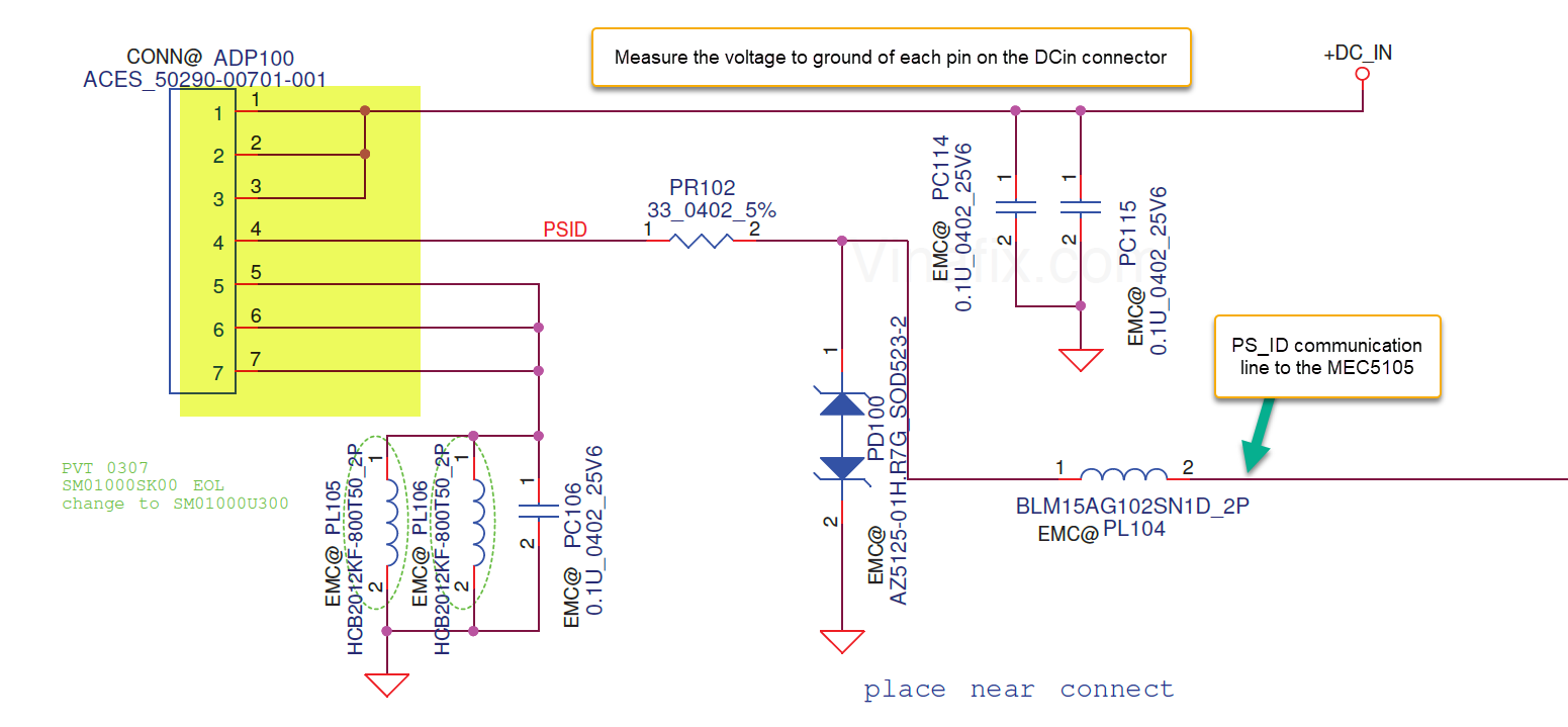

                                          #60
                                          Connect the laptop battery pack -> attach the power adapter -> turn on the unit -> does the BIOS report the power adapter is connected ?
                                          The power adapter must have the PS_ID (single wire) communication working to detect the power of the adapter.
                                          See attached. Measure the voltage to ground of the power adapter pins.
