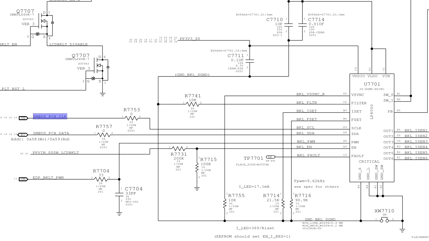

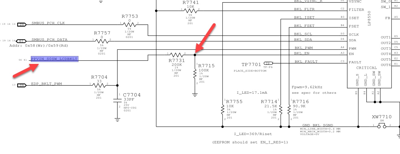

                            3) U7701 is the backlight IC. It operates over I2C (SMBUS) interface. Respectively, the SMBUS interface must be present and working to configure the backlight voltage setting.
                            Meter in DC volts scale (20V is ok).
                            With the battery on, what is the voltage reading for:
                            SMBUS_PCH_CLK
                            SMBUS_PCH_DATA
                            You can measure these at the 0 ohm resistors in series with each line (R7753 & R7757).
                            4) Post the voltages for the ENABLE pin of U7701.
                            a) Voltage @ PPVIN_S0SW_LCDBKLT ?
                            b) Voltage @ BKL_EN ? You can measure this voltage at the junction of R7731 & R7715.
                            We need to be sure that the BKL_EN voltage is high enough to enable the backlight.
                            If the above conditions are met and the resistance is not too low on the backlight rail then it is possible that U7701 is defective and needs to be replaced. This is a common failure and we have replaced the same a number of times. The part is available offshore but best to source from Arrow or TI.com directly to get the real deal.

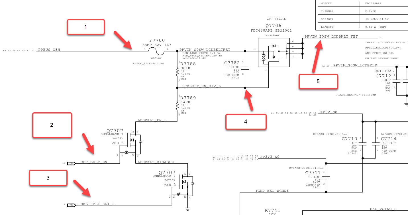

                            5) See attached - post the voltage readings for 1-5 test points.
