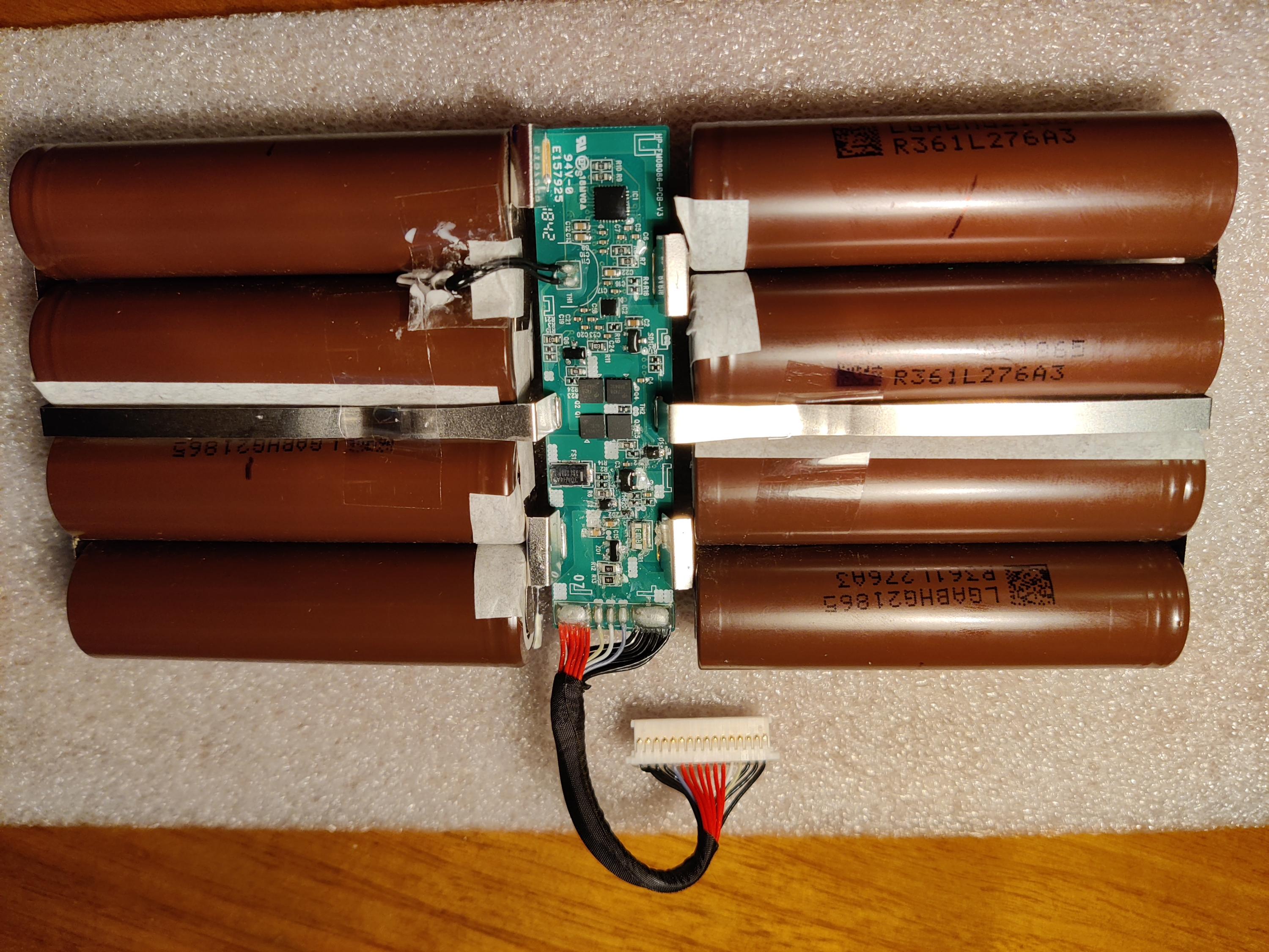

    Hi all, i have this laptop with message of blown fuse.

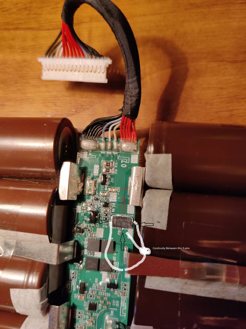

    i already opened the battery and i am assuming that this "FS1" its the fuse. correct me if i am wrong please.
    seaching info about this smart fuses i have read somewhere that to check them we do continuity test on the longer side pins. the multimiter beeps on the test.
    i have 14.6v and the closest 18650 pins from the cable, but on the actual cabe conector 0V.
    can someone help me to test the battery any further to fix my problem?
    thanks in advance to all

    mostly battery controller make blown this fuse when is something with battery,

      to bridge it can i solder the pin from top with the bottom?

        Don't mess with batteries, especially bridging fuses, firefighters have enough work as it is.

            Joking aside don`t mess with batteries they are dangerous,fuses should never be bridged. As you had continuity the fuse is probably ok, i`m not sure if resettable fuses are used in batteries.Two of the light coloured wires are SCL and SDA ,if you have a scope check them .The battery has most likely reached the end of its serviable life. The only way to really test a battery is with a hardware battery tester,there`s a few on the market

              you can easily check voltage on each cell.
