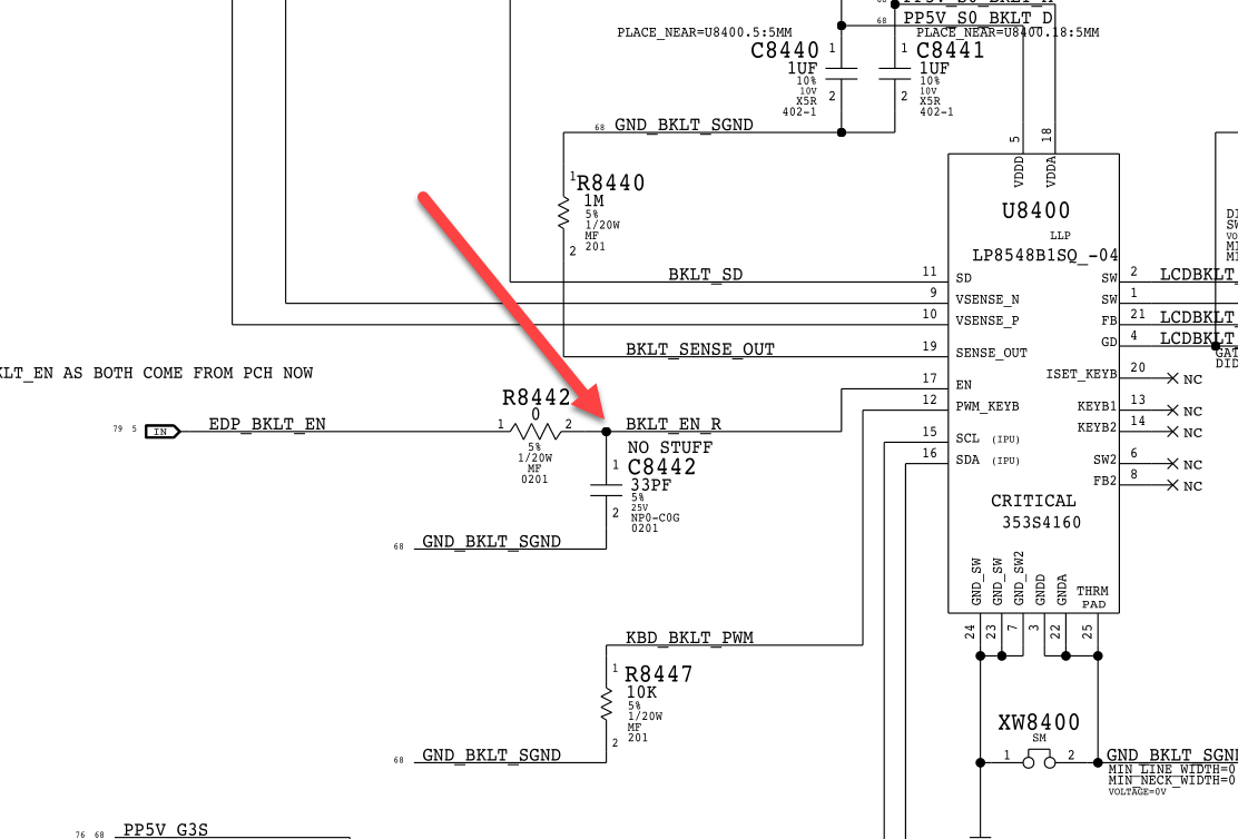

MacBook Air 820-01521 Backlight
  • eli302
    • Nov 2021
    • 27
    Re: MacBook Air 820-01521 Backlight
    I believe EDP_BKLT_EN comes from U0500 but I don't think I can test for it as it is a soldered on chip. Or should I try something else?
    • mon2
      • Dec 2019
      • 14666
      Yes, you can monitor @ R8442. Check both sides of R8442 for the logic level for this pin. Just in case, if R8442 is damaged then the logic level will be present on one side of this 0 ohm resistor but missing on the other side.
      What is the voltage reading ?
      See attached.
        Both sides of R8442 are reading 0V.
          This voltage implies that the backlight has been instructed to remain OFF.

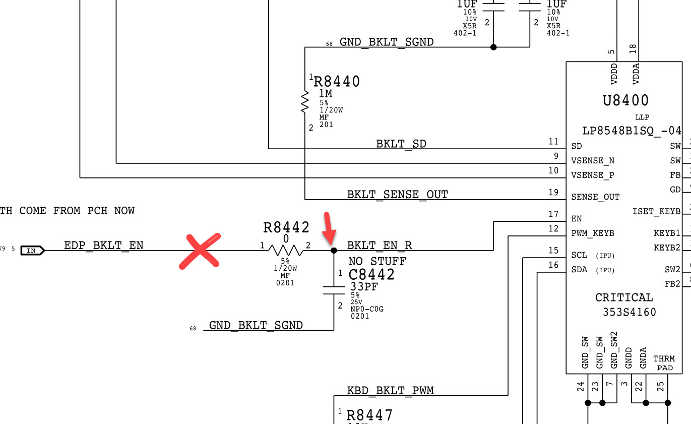

              Very good. Remove this resistor (R8442). Keep it in your toolbox for now.
              Then meter in resistance mode. Check the resistance to ground for the backlight enable pin. This is the side of the resistor that mates directly to the backlight IC.
              Confirm there is no low resistance on this pad.
              Then solder a wire from the resistor pad that connects to the backlight IC enable pin. The other side of the wire to +3v3 anywhere on the board.
              This is only to test if the backlight circuit works if the enable is manually changed to a logic '1' = +3v3.

                      #30
                      Yes. Confirming again that your manual logic '1' state is being applied onto pin #2 of R8442 (NOT pin # 1). Be sure of this as the other logic will be trying to send out a logic '0' and we do not wish to assert our +3v3 onto that pin.
                      See attached.
                      Moving forward, the PCH component drives this backlight ENABLE pin.
                      Given that the backlight ENABLE pin = '0', there may be a sensor issue for the lid open function.
                      Measure and post the voltage readings for:
                      IPD_LID_OPEN
                      LID_OPEN_LEFT
                      LID_OPEN_RIGHT
                      Take these measurements with the lid open. If the logic board is out of the enclosure, then the raw board should reflect the same 'open lid' status.
