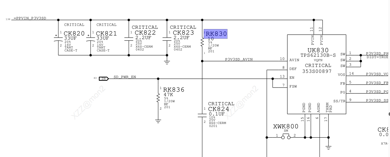

    We're working on an A2485 MacBook with no backlight after liquid damage. The damage occurred near the backlight IC (UP800). We've checked all the nearby resistors and capacitors, and everything seems fine. We replaced UP800 from a donor board.
    However, UP830 was also liquid damaged, and after cleaning, resistor RK830 came off. Unfortunately, I can't find its value, and the schematic doesn't indicate it as a critical component.
    Would anyone have insights or a way to confirm the RK830 value?

    See attached. I see this as 10 ohms, 0201 resistor.

      I've replaced this resistor, still no backlight -

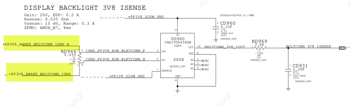

          • mon2
            • Dec 2019
            • 14753
            Good. So the logic board is attempting to turn on the backlight but then turns it off. This could be due to an excessive current draw of this display load and is being sensed by the circuit to power it down.
            Remove all power. Measure the resistance between:
            PP3V8_AWAKE_BKLTCONN_ISNS and PP3V8_AWAKE_BKLTCONN_ISNS_R

            • tommy97
              • Mar 2023
              • 172
              • United Kingdom
              I couldn't locate either of the section on the boardview, i checked by RD966 in between leg 1&2 - Short/OL 0.01Ohm.
              isns_pp3v8_aon_blktconn_p TO isns_pp3v8_aon_blktconn_n - no connection in between​

                Apparently there are 2 versions of boards for the A2485 chassis.
                There is:
                820-02100
                820-02382
                Which one is yours? The 820-02382 does feature this current sensor for the backlight. Appears to be present in the schematic but in the boardview for the 820-02100.
                Moving forward, with no power to the board, measure the resistance to ground of this backlight power rail. Do you have UP730 onboard? This is the LDO used to power the backlight.
