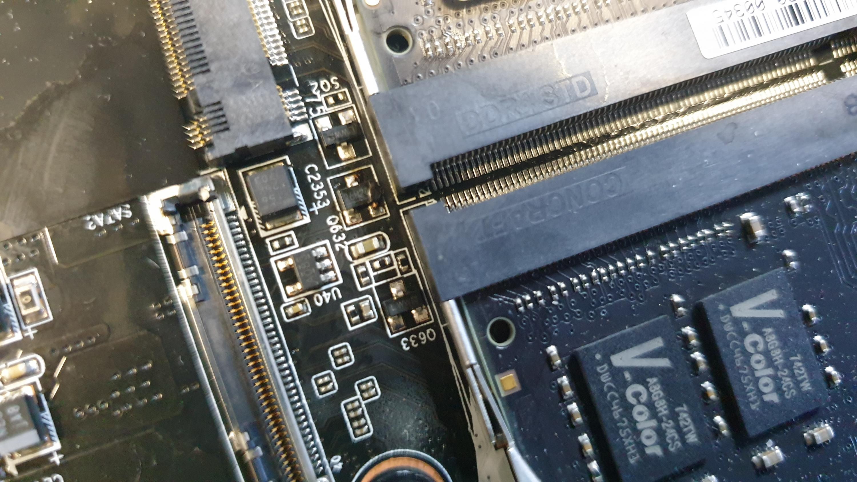

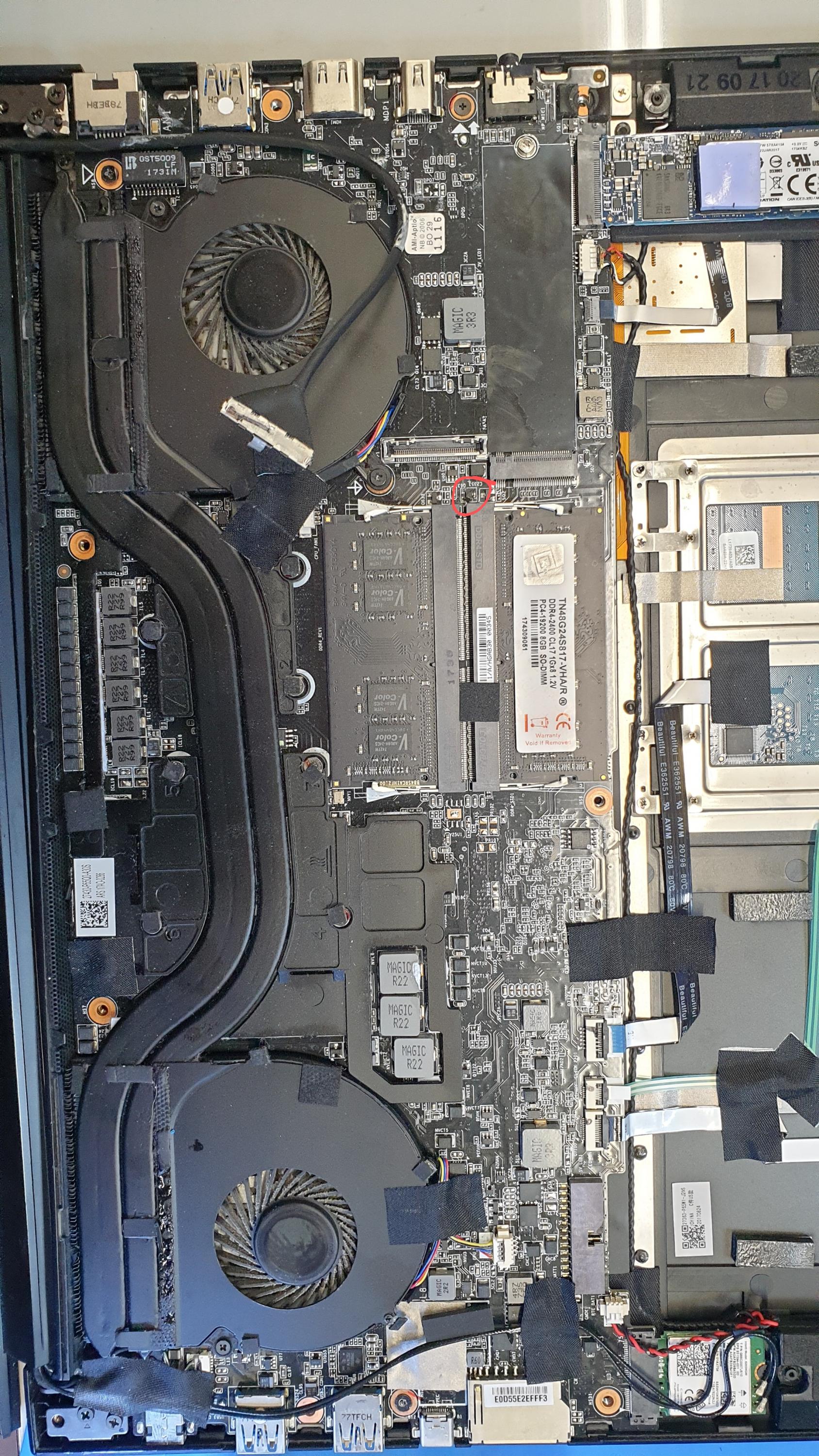

Gigabyte GA-RP65X8 Identify the chip: 26H24
  • sikocan
    • Oct 2019
    • 344
    Location Q632
    Pictures attached
    It relates to backlight of LCD.

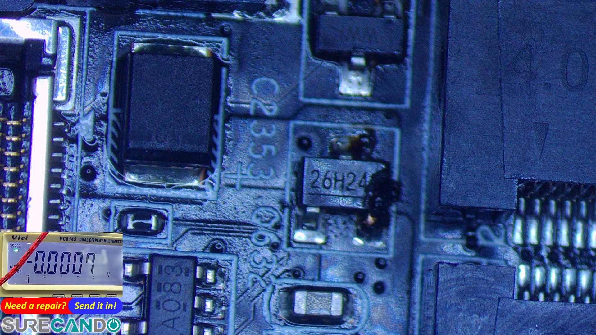

    Re: Identify the chip: 26H24
    by layout of board u can see there is two thick traces and one thin. so it is mosfet/switch/ which connect thick traces between them by voltage aplied on thin trace
    so u just need to try if it is P or N channel. more of them is Nchannel so try that first. but offcourse check resistance why it burn
      Thank you, I suspect a MOSFET. I'll try.
        Found it
        EMB50P03J/SOT23/820pF/50m

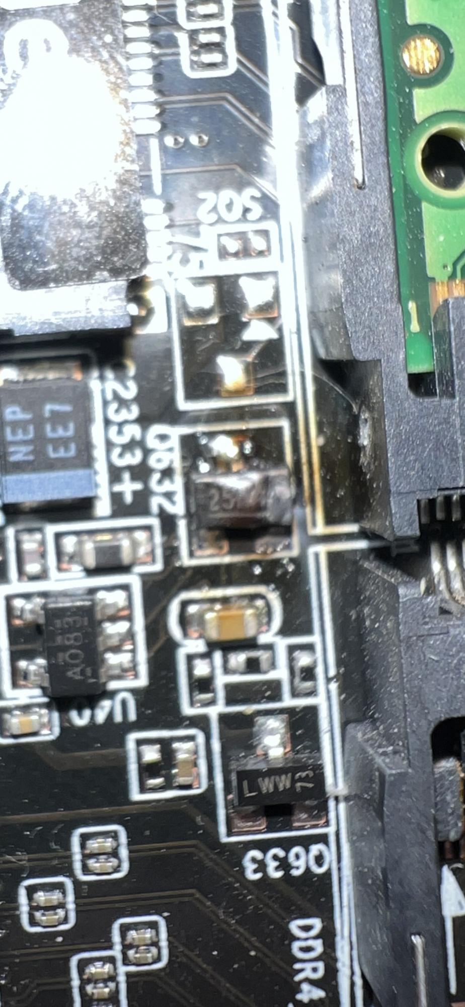

          Re: Gigabyte GA-RP65X8 Identify the chip: 26H24
          Hey,
          I have the same problem, so i am looking to buy a mosfet. Does changing it worked ?
              thanks a lot
              I bought thie part on alibaba : https://www.alibaba.com/product-deta...408b2fc2akfS6b
              DO you think it's ok ? I am in france I can only find this part on alibaba

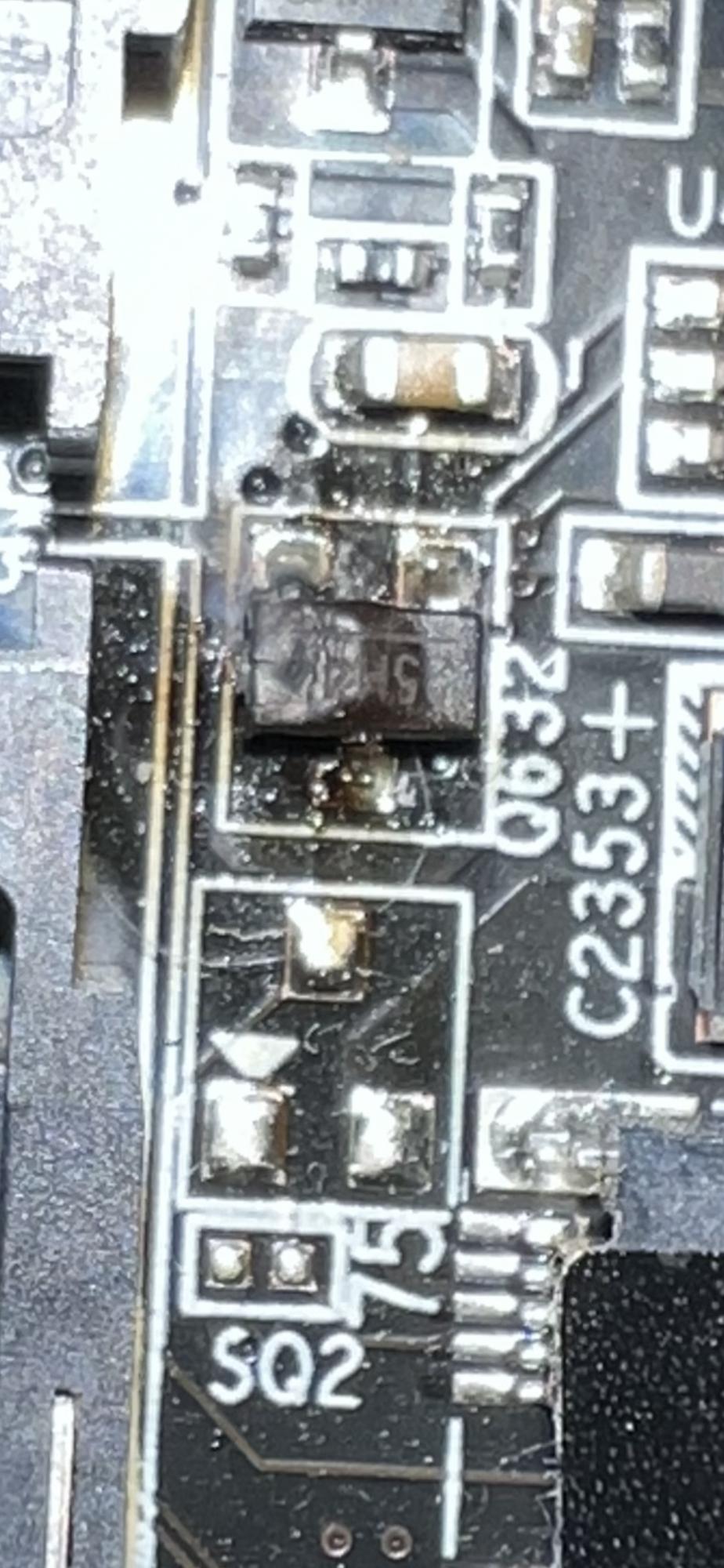

                Mine look like this
