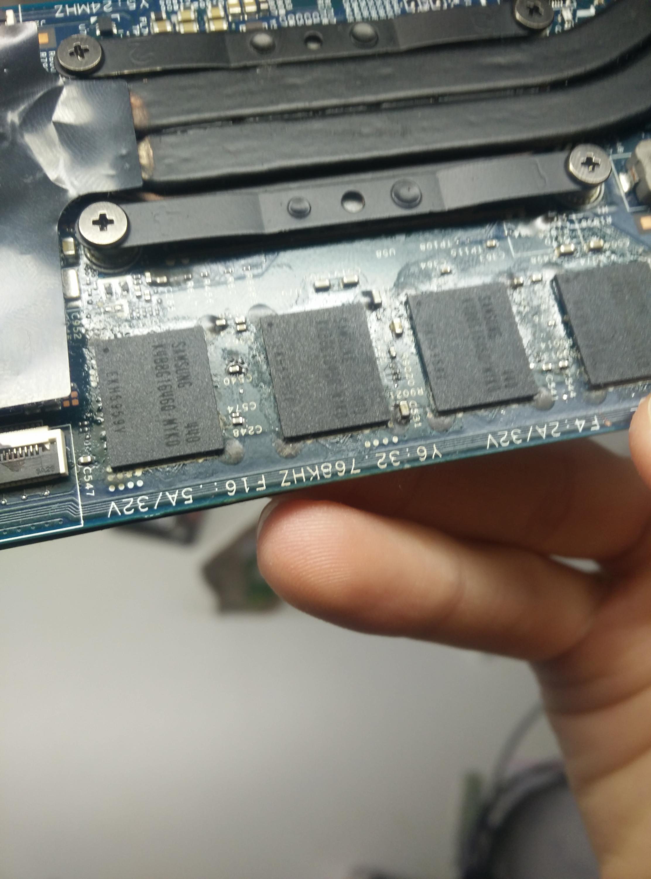

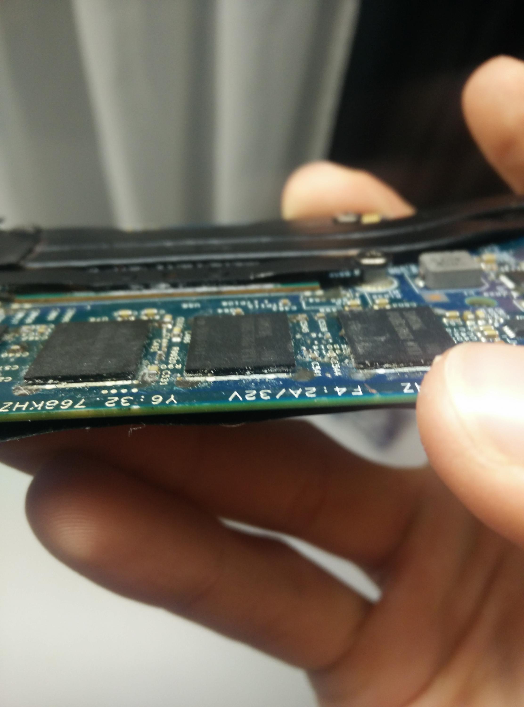

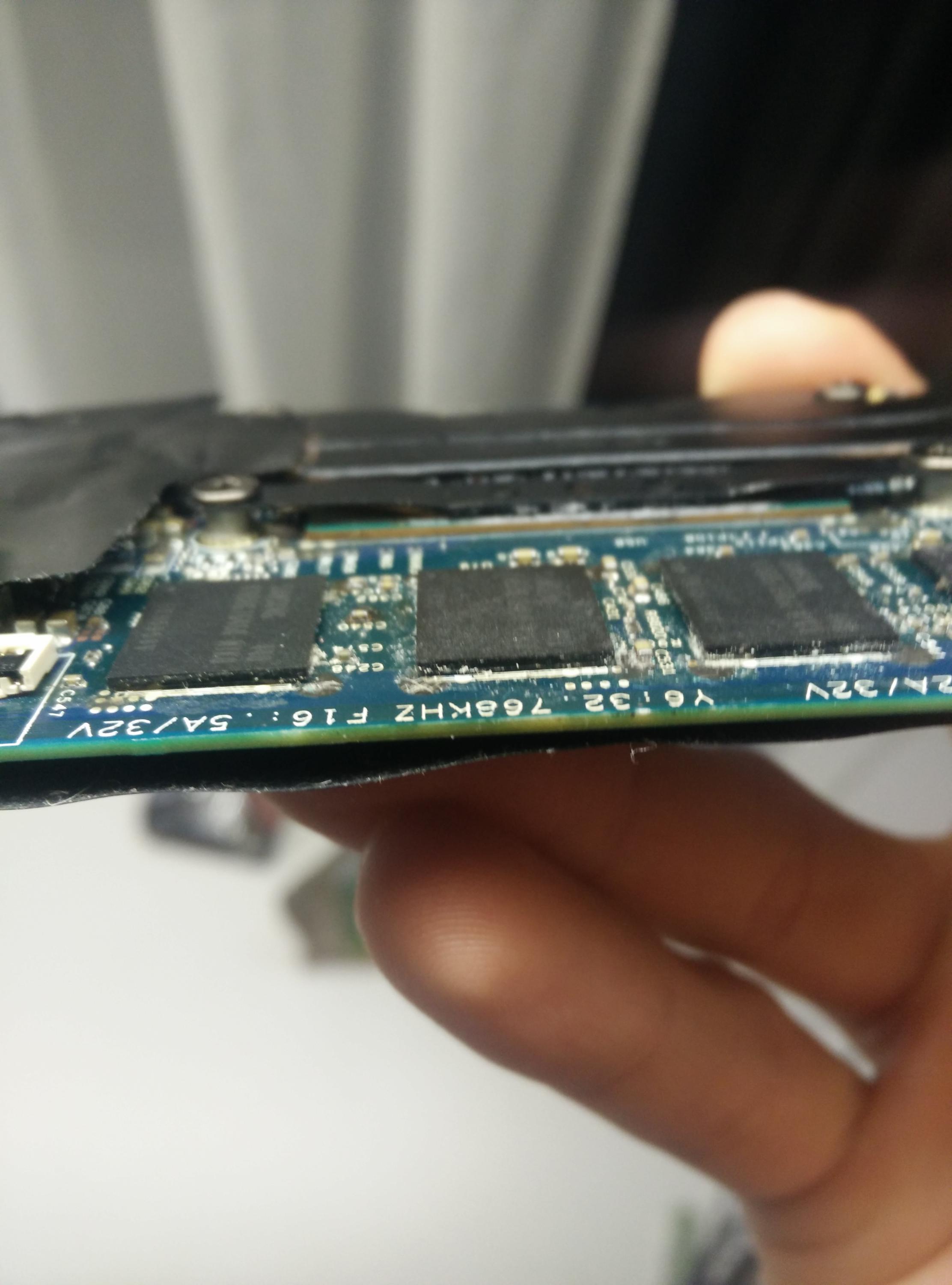

    Hey there,
    I am currently working on a hobby project of mine where I try to replace a set of soldered on rams to 16GB just for the heck of it, but I've encountered a problem in the form of a nasty underfill.
    Look at the images
    What do you suggest?
    I've tried to scrape it off with a Qian Li 007, and even to move under a hot air station, but no luck.

    Is it Lenovo which uses a black colored glue to seal all bga's. Its very hard to remove them without damaging the foil on mb.

      Has anyone managed to do it?
      Also I've read that you could just "mill it down", could that work?

        That's a 2nd gen carbon, yes?
        One method would be to heat it long enough to be sure that solder has melted and then use qianli to pry it off. Takes a bit of force.
        The other would be milling, indeed. Look for videos of iphone milling. They do it with CPU-s.
        Neither method is great or easy but it's not an easy task anyway.

          Gathering that you are using a bottom side pre-heater to assist in the removal?
          Email Rewa with the details. They most likely have a solution for this by now in Shenzhen / China.
          Do update your progress here.
