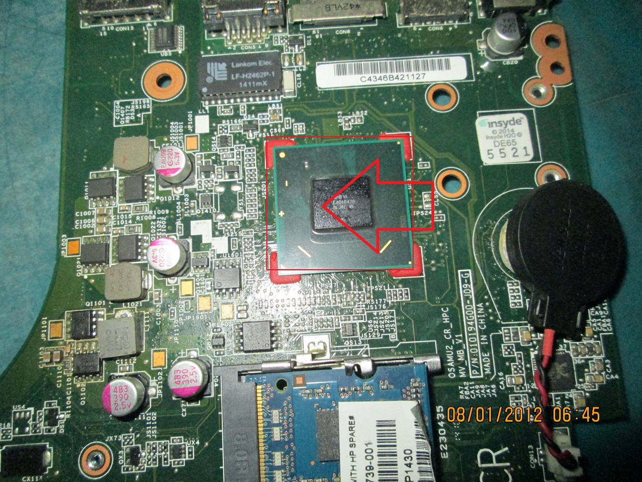

    I have HP 250 laptop which recently developed intermittent shutdown. I disassembled the laptop motherboard and found out that the display chip gets very hot, and the system eventually won't come on or its fan spin or display anything. Please, professional assistance is needed. Thanks.

      @mcplslg123. My mb is PALWONN 88 M3 E230435. The chip is labelled US1 (maybe PCH). Yes, it is getting hot without turning on. Sorry, I am a newbie. Thanks for your assistance.

        There should be some other marking as well. maybe its OSAMU_xxx mb for which schematic is not avlbl. Can you post a clear photo of the chip getting hot without turning on. What is the marking on chip??

          @mcplslg123. View of board. I am sorry, if I am not giving the best information as to get your professional assistance sir. Thanks

              Ok so its OSAMU2_HPC mb for which schematic is not available. The chip marked with arrow is indeed PCH. If its getting hot without even powering on, there can be 2-3 reasons
              01.3V rail is shorted. You can measure the resistance on 3V coil. Its located near PCH.
              02.VS voltage is being transferred without turnig on-so you need to findout the mosfet/IC for dc-dc transfer.
              03.PCH itself is shorted.
              To start with, measure resistance on 3v coil and if it shows low resistance, remove the coil and again measure resistance on both sides of the coil.
              Give these feedback and we may be able to pinpoint the fault

                @mcplslg123. (1) I don't really understand how to set my metre to be able to read resistance on coils, though I know how to read voltages. (please, assist me in this regard). (2) I don't know how to find MOSFET/IC for dc-dc transfer. (3) How do I know when the PCH is shorted? I've tried these and have not been able to succeed, hence, late feedback. Thank you, Veteran.

                    Okay, I found that one of the coils (a little close to PCH) shorts when on board and doesn't short when off board. Same coil also showed 6.67 ohms. Can it be causing my woes? Thank you, Mentor.

                      You need to measure resistance on both pads of the coil while its removed. Perhaps you are measuring only one pad.

                        Yes, I did measure resistance on both pads and eventually got 6.67 ohmns on both of them.

                          If the resistance measurement is correct, you have a shorted PCH+ shorted 3V regulator. May be even kbc is shorted. If you have bga rework machine, you can try removing the pch. Elase get in touch with some professional repair shop. The cost of repair will be almost close to a new replacement mb. So i'll suggest look for a replacement mb as long as its available and not expensive.
