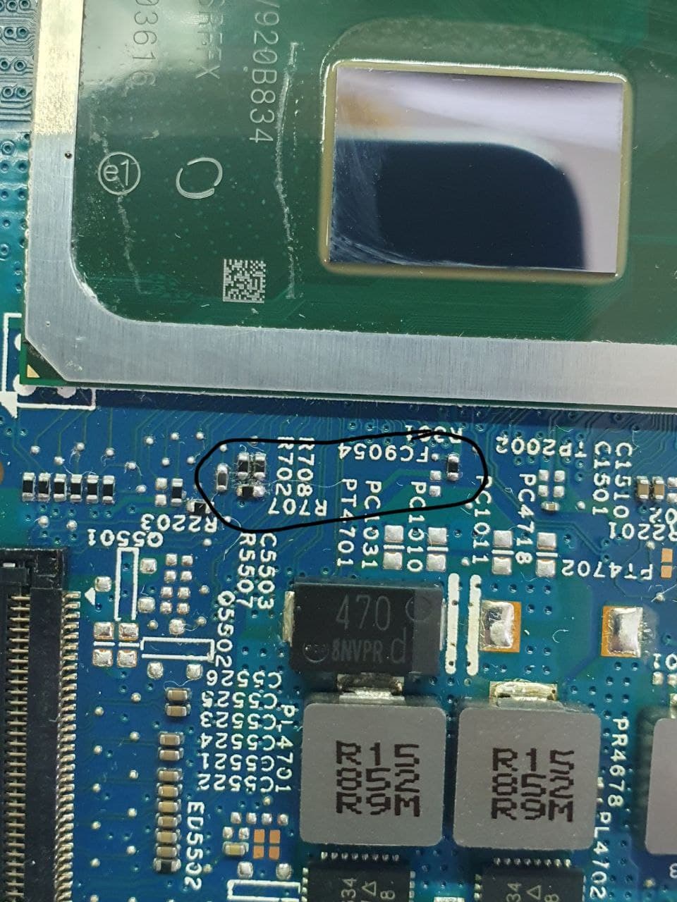

15m-dr0012dx (15.6 SABA MB WHL_4 VRAM 18748-1) help with the resistor values

    In the process of replacing the combine, I accidentally shifted the resistors near it, after installation I put everything back in place, but now I am tormented by doubts whether I put them correctly. There is no documentation for this platform, who can help with the resistor values?
    Interested in R301, R708, R702, R707 and the one below R702.

    Re: 15m-dr0012dx (15.6 SABA MB WHL_4 VRAM 18748-1) help with the resistor values
    R708=50ohms, R707=56ohms, R702=220ohms, R703=25ohms and below 702=490ohms approximately read on board.
