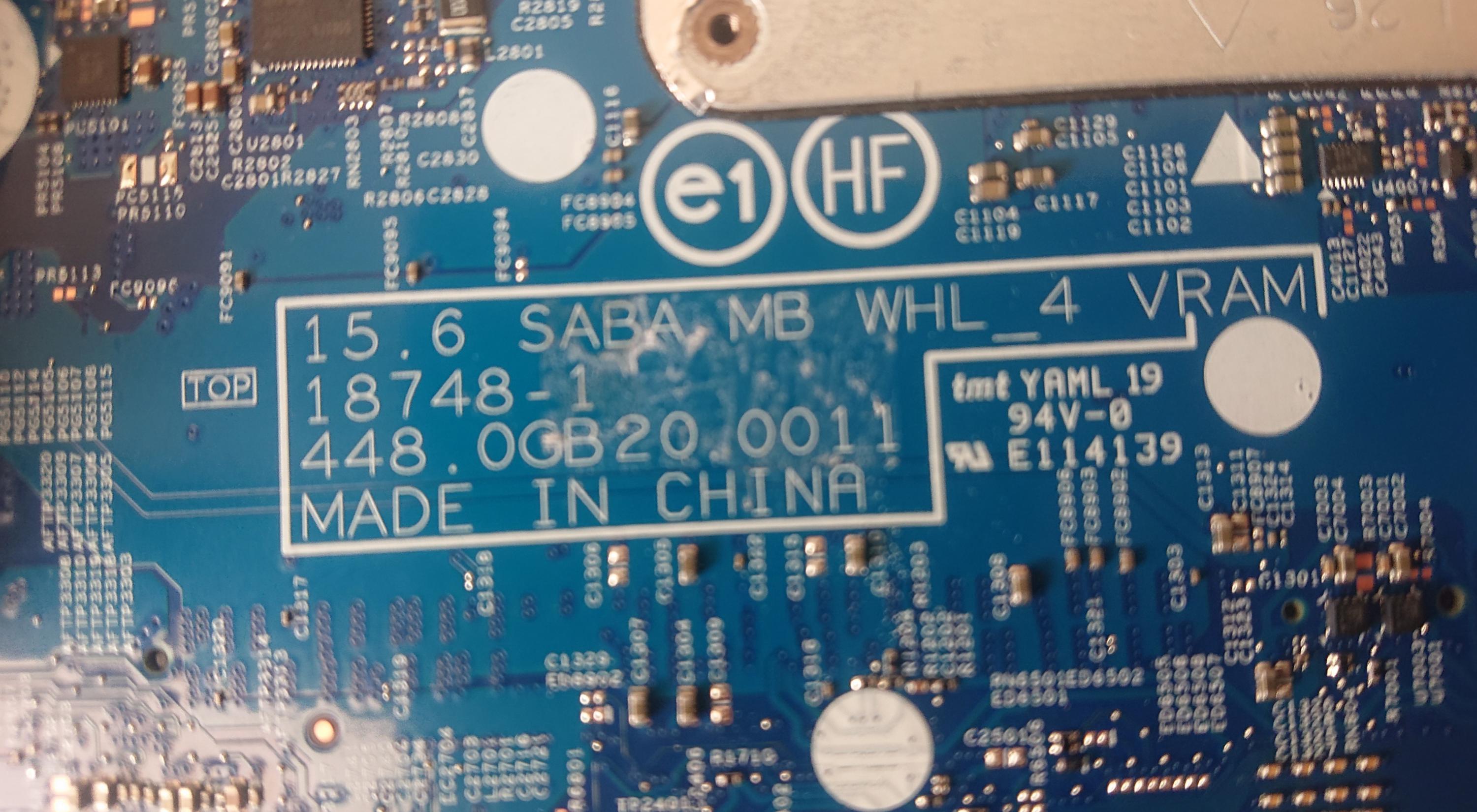

    HP ENVY x360 - 15-dr1017tx 15.6 SABA MB WHL_4 VRAM 18748-1
    Any one with a working bios bin file for HP ENVY x360 - 15-dr1017tx (15.6 SABA MB WHL_4 VRAM 18748-1) Product number 8QW26PA. Powers on but no display. Tried to clean me region but not sure if i did it right. Many thanks in advance.

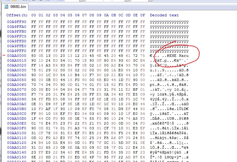

              please can doesanyone has the EC backup to share ?
                • 22077
                Re: HP ENVY x360 - 15-dr1017tx 15.6 SABA MB WHL_4 VRAM 18748-1

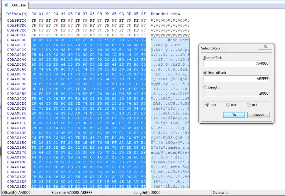

                Open the bios from post #2 with a hex editor. Search for the word HARU .
                These are the offsets to copy the EC to a new file AA0000 - ABFFFF ,choose "Select block" and enter the start offset AA0000 and end offset ABFFFF ,select copy ,paste into a new file and save.
