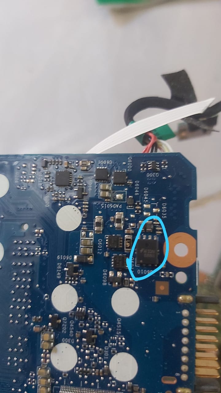

    Hp 14-ac 6050a2730601-mb-a01 no power
    19v connection decreases and becomes 6v, and this is the measurement result of the charger ic BQ728 IC CHARGER PIN1(ACN) = 6.85V PIN2(ACP) = 6.85V PIN3(CMRSC) = 2.94V PIN4(ACDRV) = 3.03V PIN5(ACOK) = 0.08V PIN6 (ACDET) = 3.49V PIN7(iOUT) = 0.04V PIN8(SDA) = 0.01V PIN9(SCL) = 0.01V PIN10 (ILIM) = 0.19V PIN11(BATDRV) = 2.20V PIN12(SRN) = 2.11V PIN13(SRP) = 2.14V PIN14 (GND) PIN15(LODRV) = 0V PIN16(REGN) = 6.10V PIN17(BTST) = 6.08V PIN18(HIDRV) = 2.35V PIN19(PHASE) = 2.15V PIN20(VCC) = 19.14V

    Re: Hp 14-ac 6050a2730601-mb-a01 no power
    Remove all power.
    Meter in resistance mode.
    Check & post the resistance on the first mosfet that is connected to the external adapter:
    a) resistance between SOURCE & DRAIN ?
    b) resistance between SOURCE & GATE ?
    c) resistance between GATE & DRAIN ?
      first mosfet measurement result
      S - D = 470
      S - G = 0
      G - D = 0
      DOES THIS PROBLEM NOT MEAN FROM CHARGING IC Fault?
        this is the first mosfet circuit on the 19v line that drops at the output
          1) post the full markings of this first mosfet.
          2) see the resistance chart at this URL:
          http://electronicsbeliever.com/how-t...-is-defective/
            okay thanks ..let me try first..
              thank you friend, the motherboard has been successfully repaired
