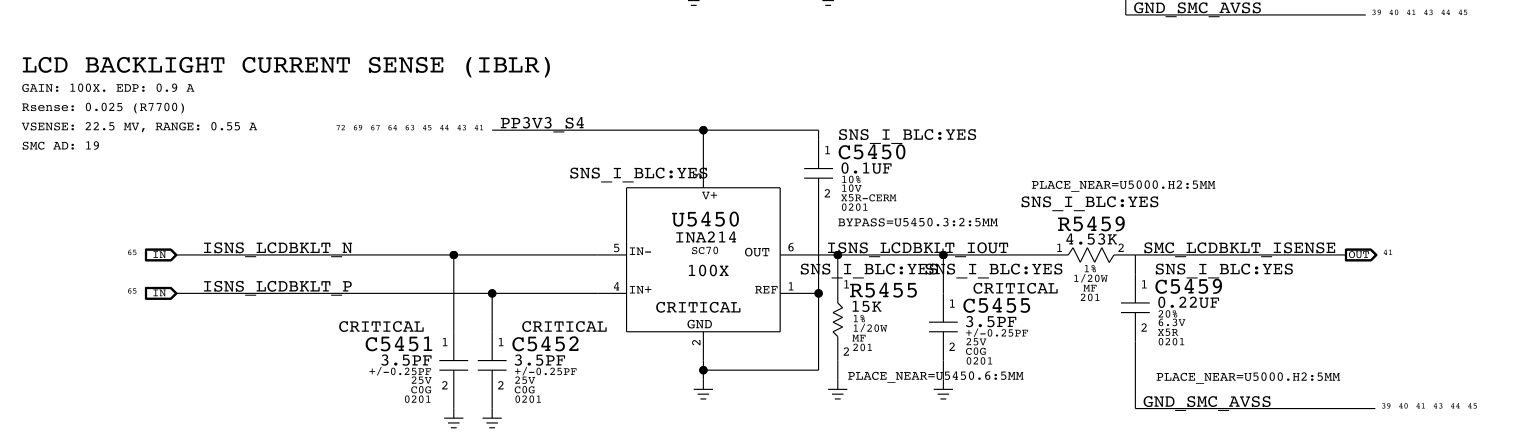

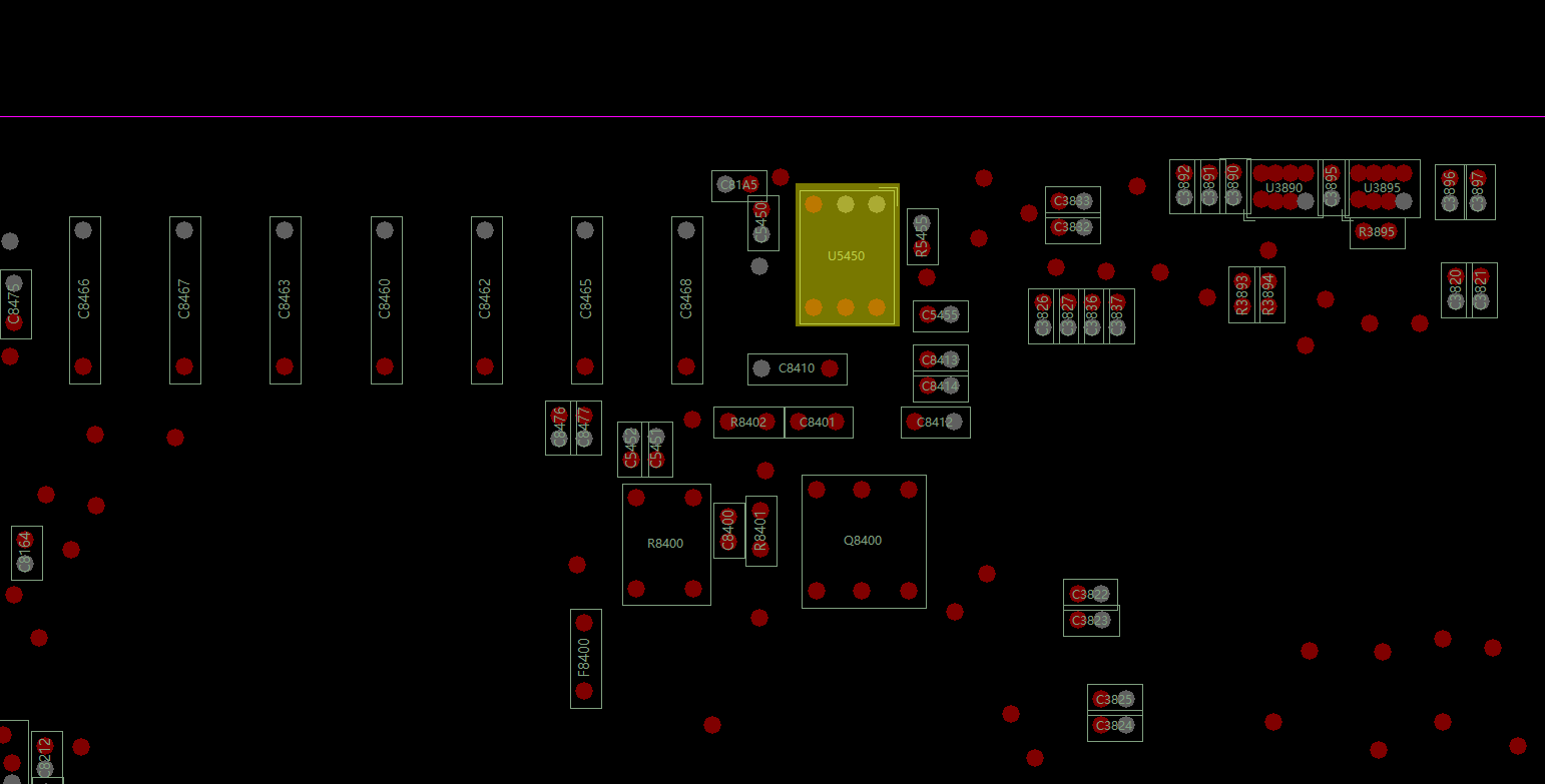

                      1) Check on the resistor values of R8401 (80k6) & R8402 (63k4).
                      2) Check that mosfet Q8400 is not shorted.
                      3) What is the value of LCDBKLT_EN_L when backlight is working & not-working?
                      4) Monitor and post the OUTPUT voltage of U5450 (pin 6)(current sense for the backlight rail; ISNS_LCDBKLT_N and ISNS_LCDBKLT_P) when backlight is working & not-working.
                      • luckydip
                        • Aug 2016
                        • 165
                        • uk
                        Re: 820-00840 no backlight after sleep
                        R8401 (72k) & R8402 (64k)
                        Q8400 ok - not shorted
                        Backlight on
                        LCDBKLT_EN_L 7.2-8.4v
                        U5450
                        4 13v
                        5 13v
                        6 1.2-1.3v
                        Backlight off
                        LCDBKLT_EN_L 11v
                        U5450
                        4 13v
                        5 13v
                        6 1.8-2v
                        There is physically no U5450 on the board (no stuff?)
                        • mon2
                          • Dec 2019
                          • 14634
                          As far as I can tell, U5450 is required to operate the logic board correctly. Perhaps someone can check as well.
                          Review the U5450 support parts and region again. This could be the show stopper.
                          • piernov
                            • Jan 2016
                            • 4437
                            • France
                            U5450 is no stuff on production, BOM option SNS_I_BLC for development only.
