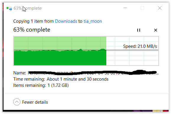

    I'm having issues with this laptop transferring files to external HDD 8 TB which on desktop PCs gives me transfer of up to 100-120 MB/s constantly.
    On laptop is not HDD it's some sort of an SSD so that should not be an issue.
    Ofc is not issue with external HDD since it gives me max speed.

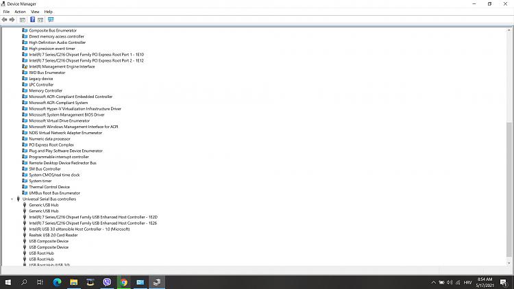

    All the drivers are installed I suppose okay (device manager pics).
    There are no official drivers on website for laptop,so only W10 drivers are installed.
    But 21-25 MB/s is not even USB 2.0 transfer rate.
    So can anyone help me resolve this issue and get max speed over this usb 3.0?

              USB 3.0 controller is integrated into 7-series PCH. Native Windows 10 drivers should work fine.
              Try from Linux to see if it is a software issue only with Windows.
