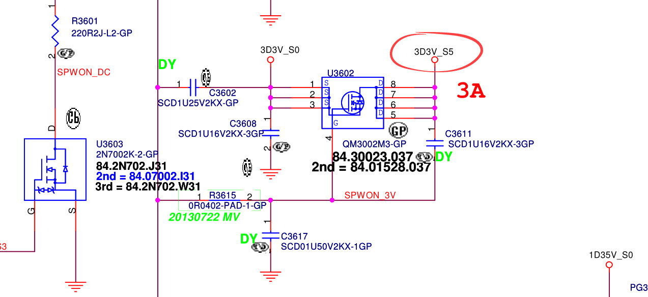

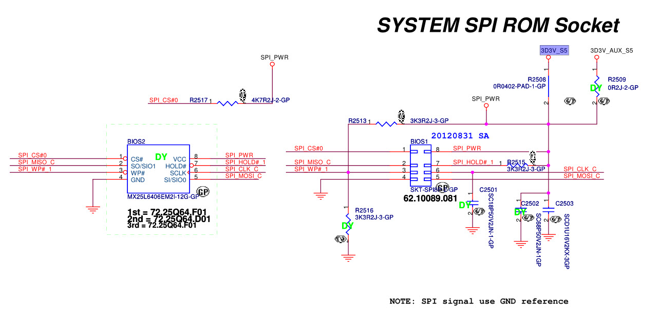

    Can somebody explain how the power to the flash memory is controlled on a HP 450 G5? It is not directly permanently connected to 3.3V.
  • piernov
    • Jan 2016
    • 4439
    • France
    Re: Spi VCC HP 450 G5
    On newer platforms it's often connected to +3VSUS rail, derived from the 3V S5 rail (3VALW usually) and enabled by SLP_SUS# from the PCH.
    Try to find schematics matching board model number to confirm.
    • mon2
      • Dec 2019
      • 14677
      SPI flash VCC is mated to 3D3V_S5 rail.
      What voltage do you see @ 3D3V_S5 when the laptop is ON ?
