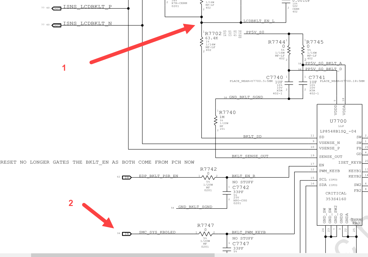

    Macbook Pro A1502 No Picture no Backlight
    Hi guys am working on a 820-4924 that is giving me some serious headache. I have picture on external display. But nothing on the internal. I don't have pin 1 on lvds connector PPVOUT_S0_LCDBKLT and i don't have pins 28,29,30 . I have voltages 5v on U7700 pins 5 ,18 , But i am missing pins 17 which should be the enable pin. Can you all please guide me further on what to check? I also replaced U7700 from a donor board and nothing changed. Can you guys tell me if maybe U7700 is dead ?

        Re: Macbook Pro A1502 No Picture no Backlight
        Hi.
        1) Please see and post the voltage values for the attached locations.
        2) power down and remove battery. Meter in resistance mode (200 ohms).
        Red probe on PPVOUT_S0_LCDBKLT.
        Black probe on ground.
        What is the resistance reading on PPVOUT_S0_LCDBKLT rail ?

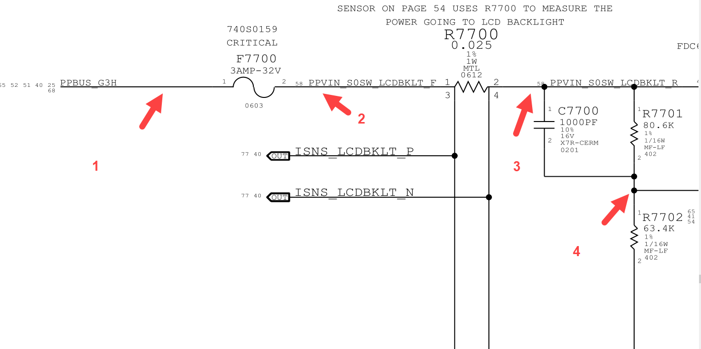

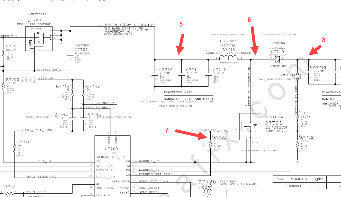

            New requests.
            Voltage readings for each ?
            • platinumsteel
              • May 2019
              • 234
              • Trinidad&Tobago
              Voltage readings of new request

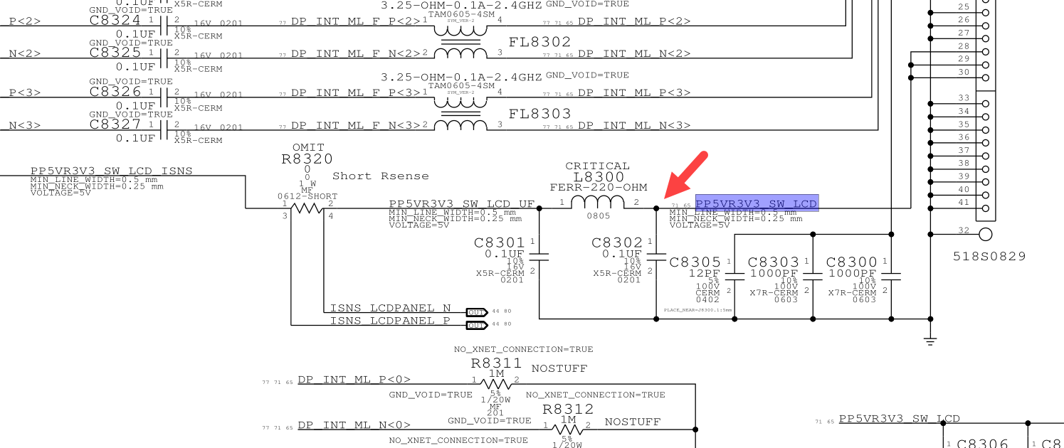

                  • mon2
                    • Dec 2019
                    • 14368
                    Meter in resistance mode (200 ohms),
                    Red meter lead on L8300, pin # 2 = PP5VR3V3_SW_LCD.
                    Black meter lead to ground.
                    What is the resistance to ground reading of the PP5VR3V3_SW_LCD rail ?
                    • platinumsteel
                      • May 2019
                      • 234
                      • Trinidad&Tobago
                      1.945M and it keeps rising.PP5VR3V3_SW_LCD
                      3.455M and rising. PP5VR3V3_SW_LCD rail

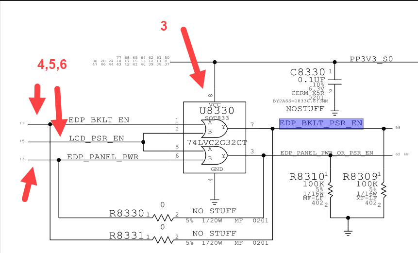

                                    Okay guys I just thought i would post back since I think i now realize my problem. The issue is I do not have Pin 17 of U7700 which is the enable Pin.I believe It's is because of U8330 which generates the 3.3v for Pin 17 is not functioning properly. If you look at the picture below I don't have input voltage for U8330 and that input voltages comes from the PCH. Is their anyway I can inject and maybe provide input voltage for U8330 and do the job of the PCH?
                                    There is no short in and around there.I had already replaced U8330 but still the same.
                                    • mon2
                                      • Dec 2019
                                      • 14368
                                      Hi. I am sure to get flamed for this but personally do not see any issues on a possible work around.
                                      A key concern is why is the PCH is not sending the proper signal for this dual-gate OR IC to output the desired logic high "1" on pins 7 & 3 ?
                                      From many readings, suspecting that most techs will stop the repair upon reaching a serious PCH issue due to the large # of balls on the BGA device?
                                      We hope to get into PCH / CPU replacements in the near future but still need to make the room for our BGA rework station.
                                      You can consider to:
                                      1) remove U8330 off the logic board - this will then isolate the PCH signals to the LCD display connector.
                                      2) Then locate a 3v3 rail and apply it with a small wire to the 0201 pad @ R8330, pin # 2. Do the same for R8331, pin # 2. You will leave U8330 OFF for this "hack".
                                      So you are manually applying the logic high to enable each leg of the LCD display. The PCH will have no role in this.
                                      Be sure that pin # 1 of each of the no-stuff resistors @ R8330 & R8331 are NOT used nor shorted to the +3v3. We DO NOT want to feed this voltage back to the PCH.
                                      Not sure how this will turn out with respect to lid closing, etc. - it is possible that the display will now remain always on but not sure.
                                      You can at least test the idea and post your findings. Curious to know.
                                      PS: Is it possible that you have had liquid damage to the PCH area ?
