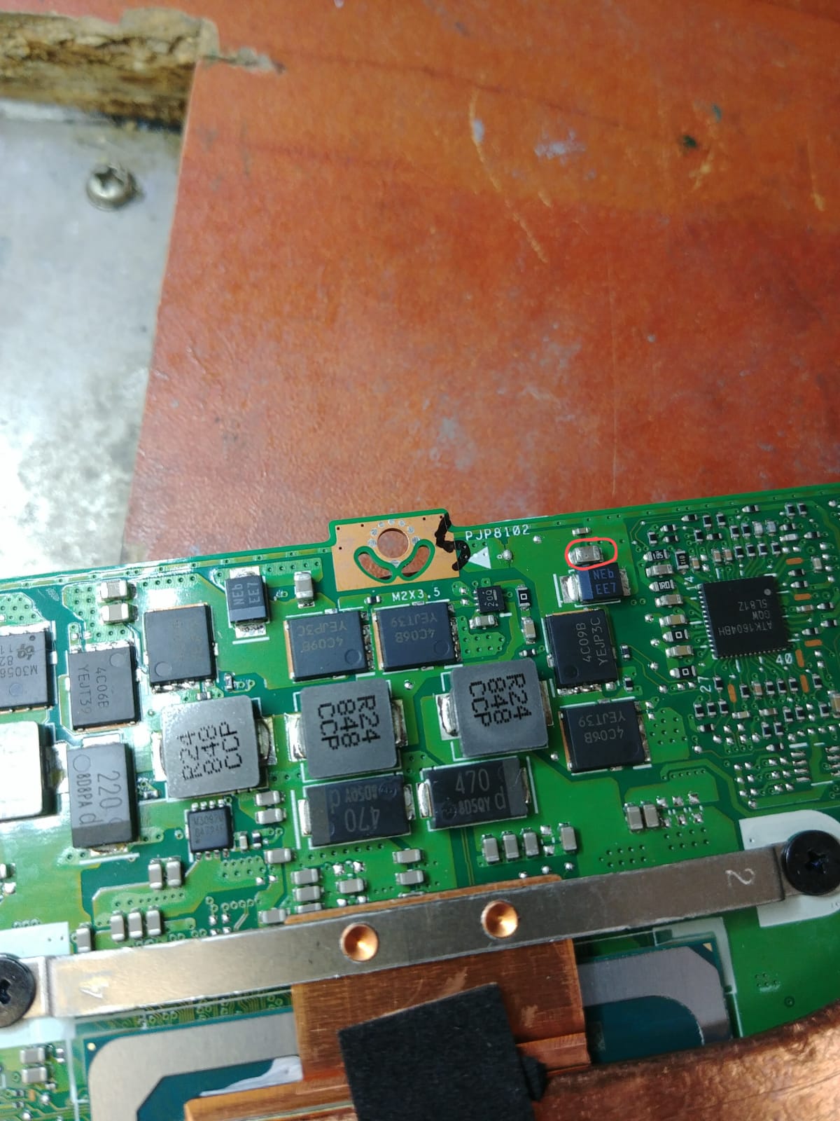

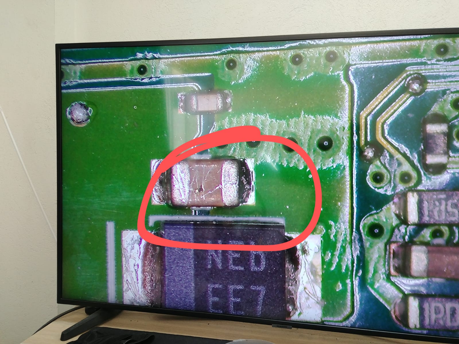

s430f x430fa capacitor short
  • shuky
    • Dec 2010
    • 49
    some1 know the value of the capacitor ?
    the cap was shorting after removing laptop is working but battery not charging
    asus s430f x430fa motherboard

    Re: s430f x430fa capacitor short
    The cap can be left off the logic board. It will not affect the charging support.
    Locate the charging IC on the board and share clear, zoomed pictures.
    What is the voltage reading on the battery connector for the charger IC ?
