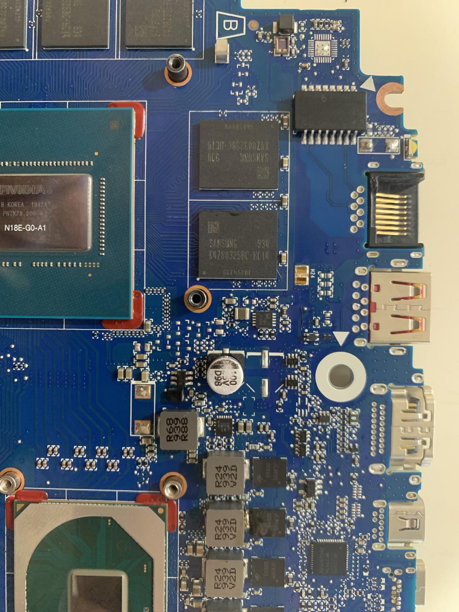

    hi everyone

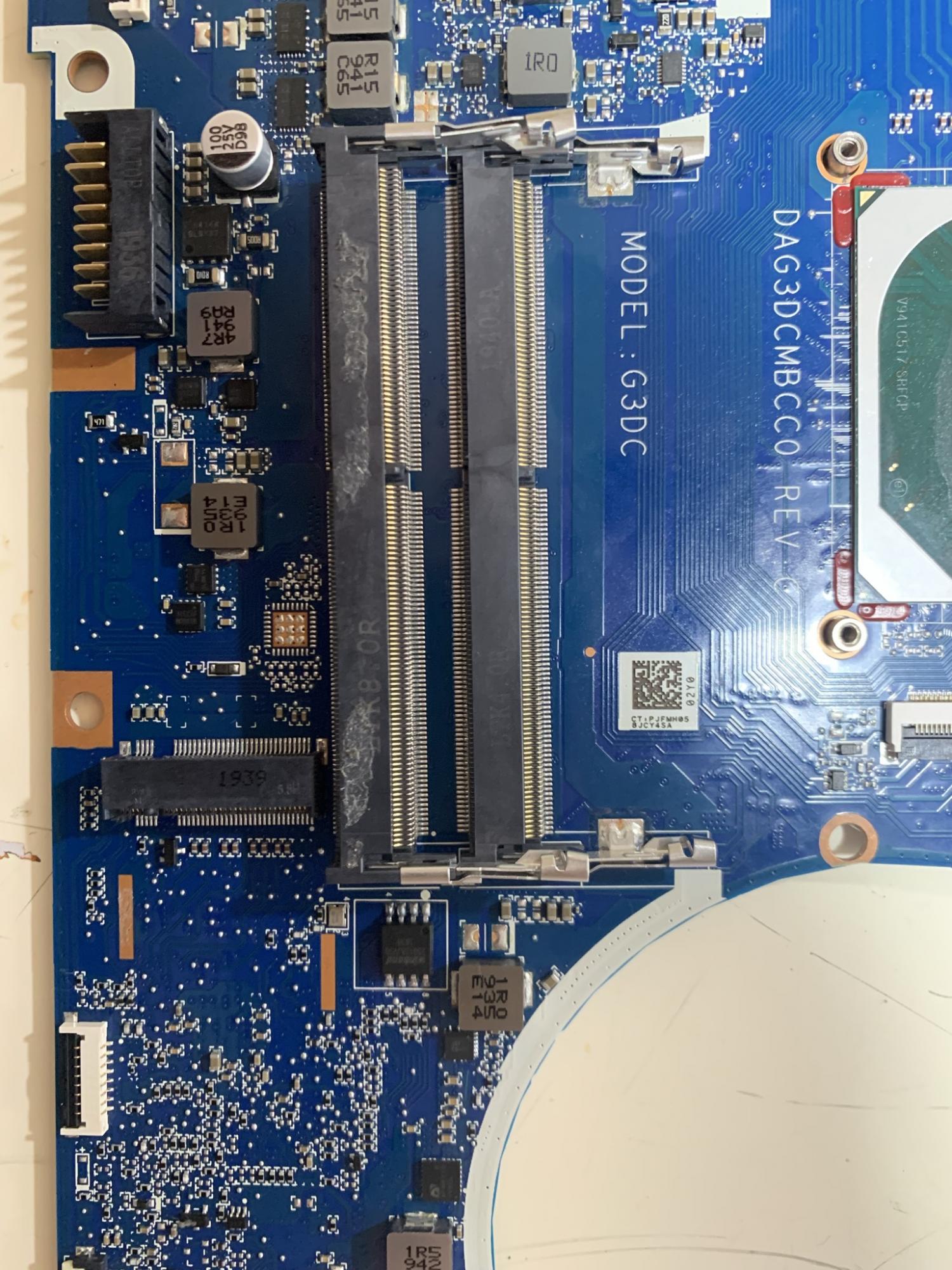

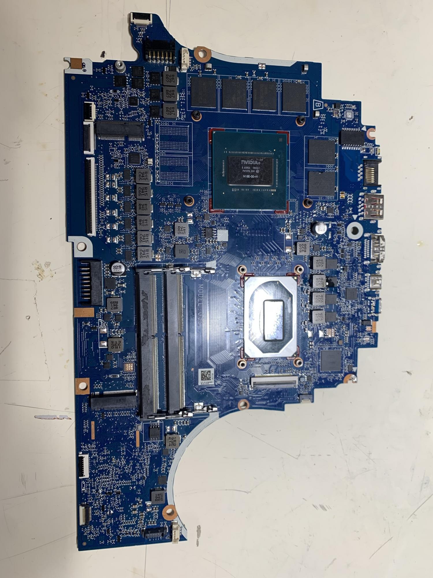

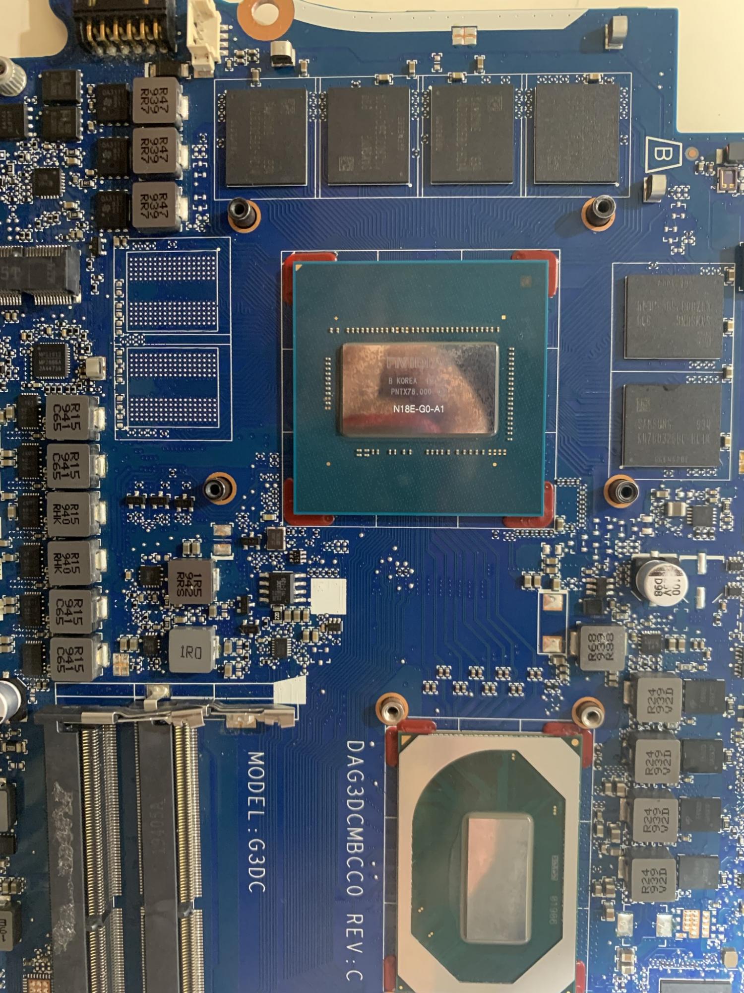

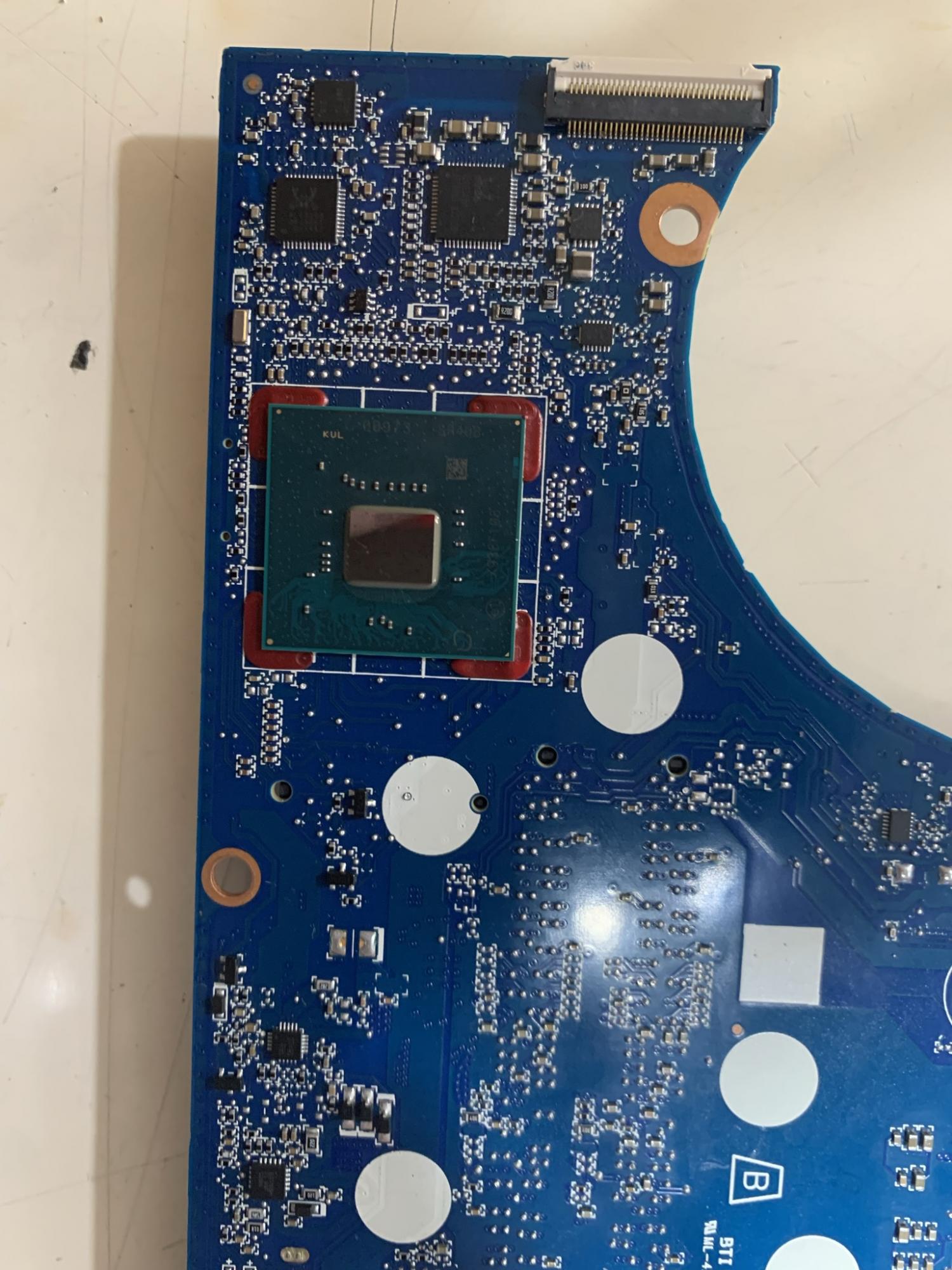

    as the title says i got this board with a possible short in cpu
    when i connect the power supply the laptop draws 0.015 amps and when press the power button the light in the same button turns on and quickly turn off at the same time that power input ligth do the same
    its a hp omen dc1003la with a i7 9750h and a 1660 ti
    when push the button the laptop max amp draw is 0.120 amps and turn off
    measurement near the cpu show me a full short ill attach the image
    how can confirm that cpu is shorted
    i tried injecting 1volt and 1 amp limited but nothing get hot even cpu still cold , should inject more current?
    the only low measurement is near the cpu other parts on the board sems to be fine
    thanks in advance

    What is exact ohm reading on that cpu coils relative to ground?

      hi
      relative to ground is 0.2 ohm

        I would remove those vcore coils and check on which side resistence is 0.2 ohm

            0.2 Ohms is too low even for a 9th gen cpu though i'm not 100% sure.

              yes i measured an i5-8300h wich was functional and in the same line in that laptop has an 2.9 ohm value
              the strange thing here is that i inject 1v and 1.6a to this i7-9750h and doesnt get hot, any component, should inject more cutrrent or volt?
                Re: DAG3DCMBCC0 REV C cpu shorted?
                More current, not volt. You can pump upto 5Amp. If SOC is shorted it will consume almost 1A or higher current and u cant feel the heat so easily. U leave with current injected for 10 mins and then it may be slightly warm.

                  This is not shorted, i've seen even0.1 ohm and the machine was working 100%

                      I think that board is missing 1.05v please check

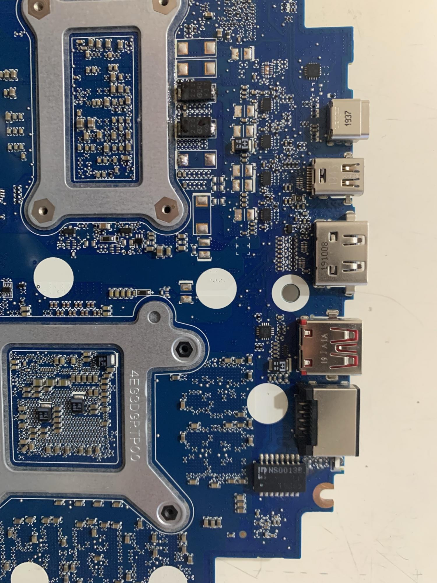

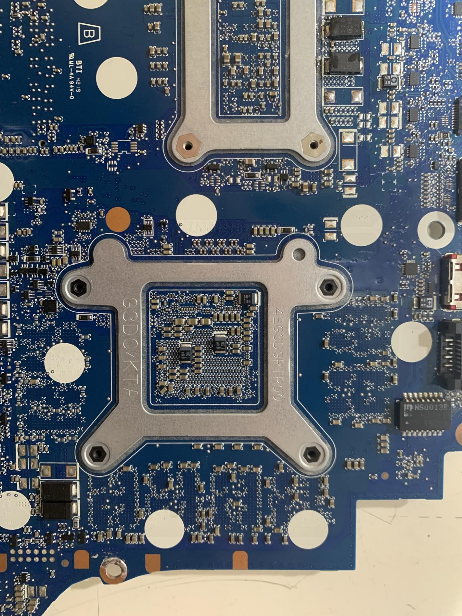

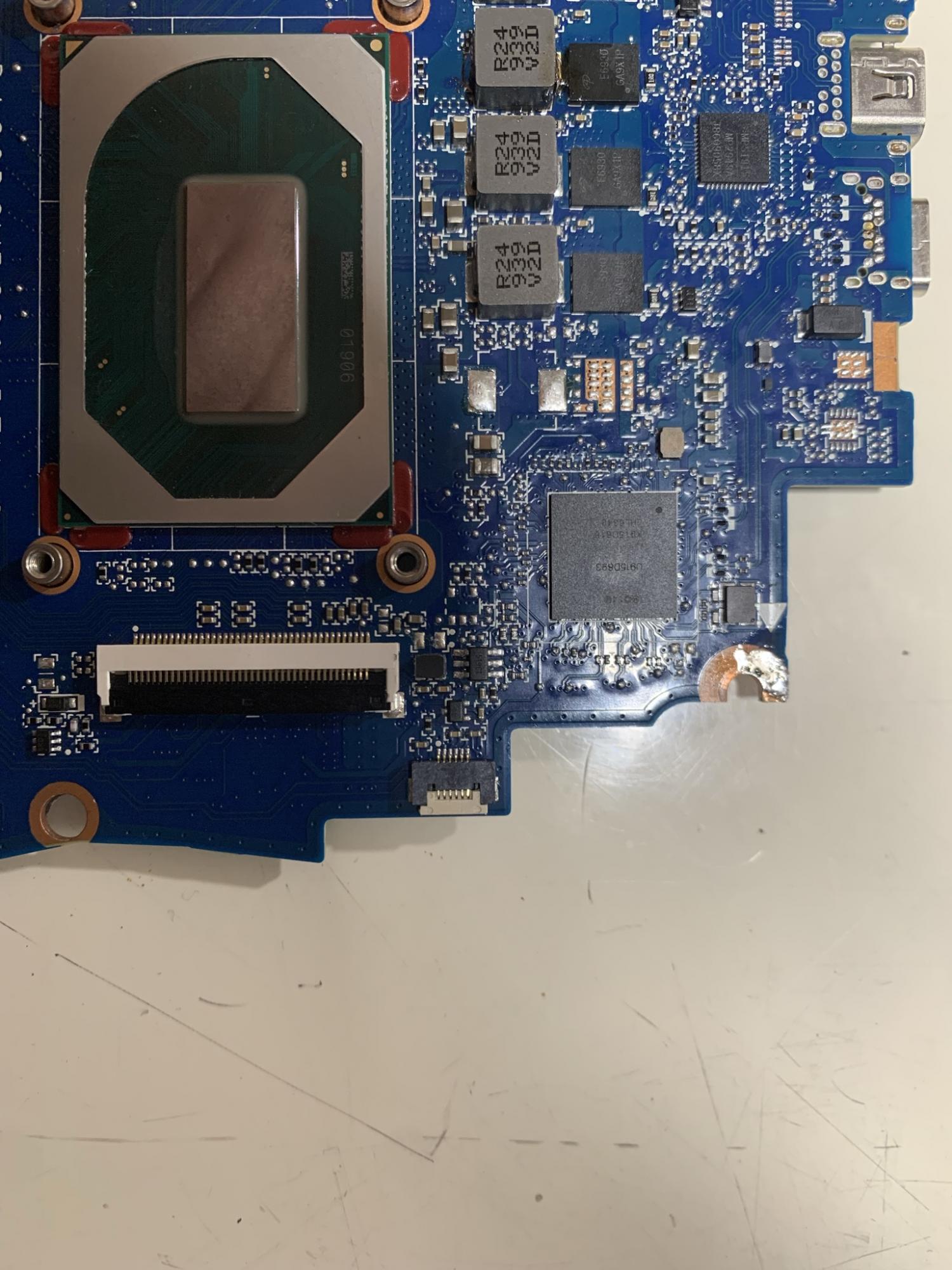

                              yes 1.05v is mising
                              is this voltage always?
                              where i can find the source of this voltage? there is no scheme of this board

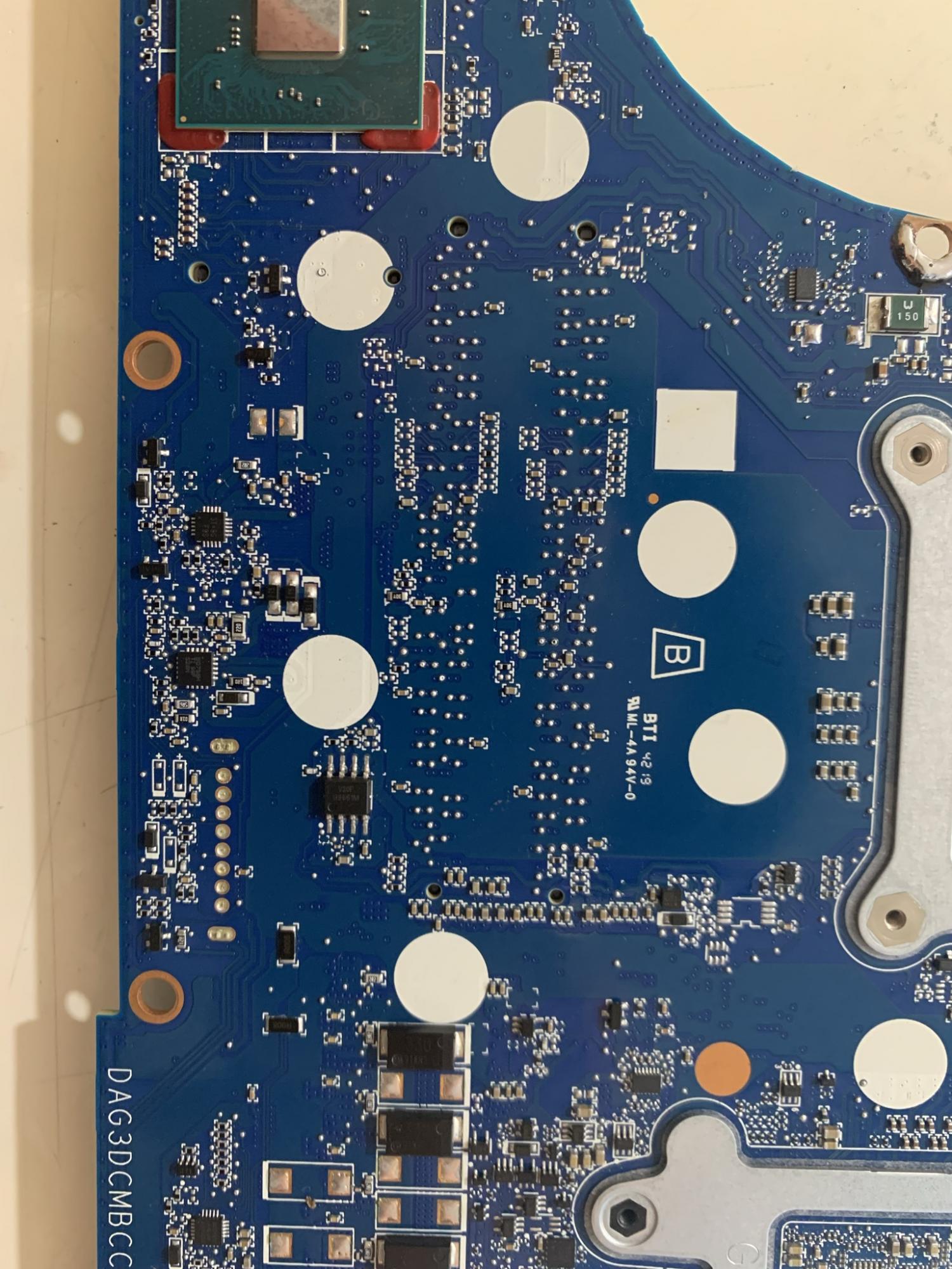

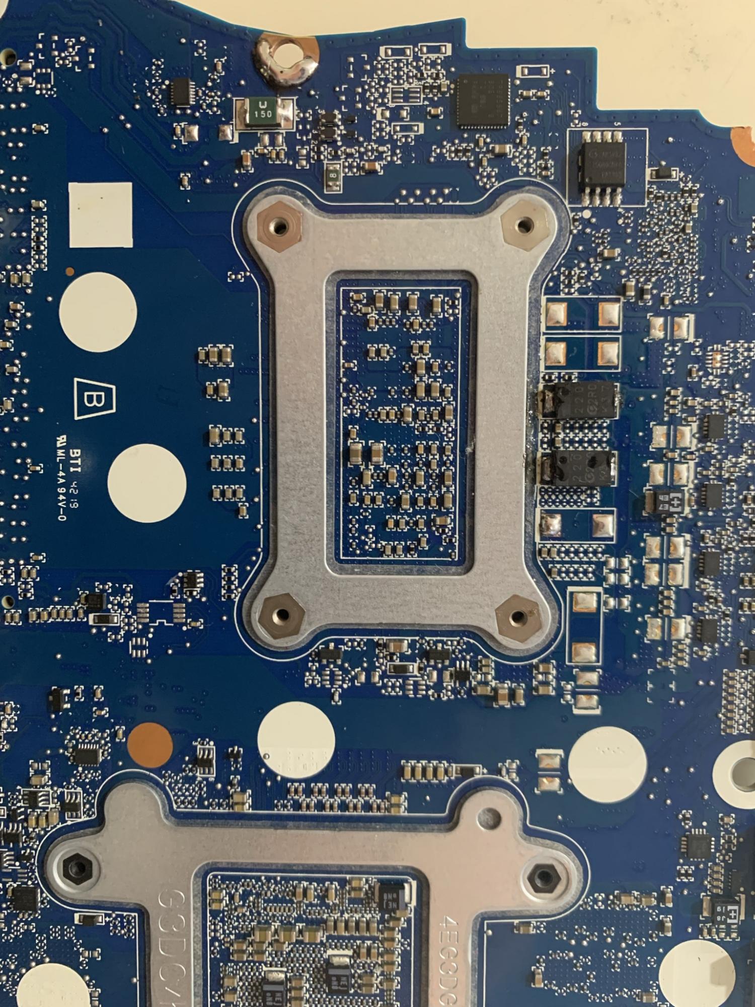

                              There is more photos of the board

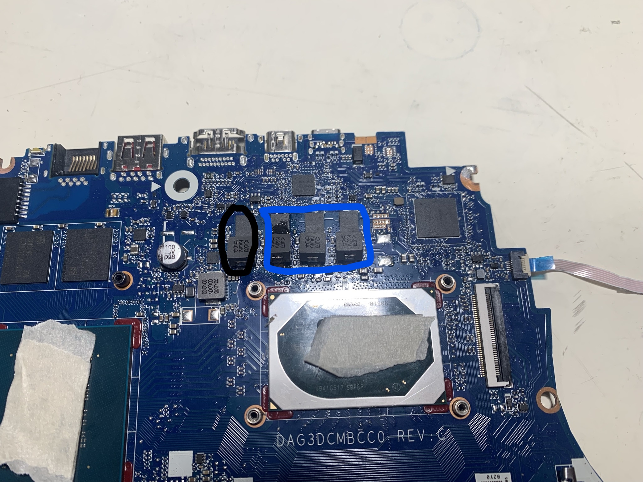

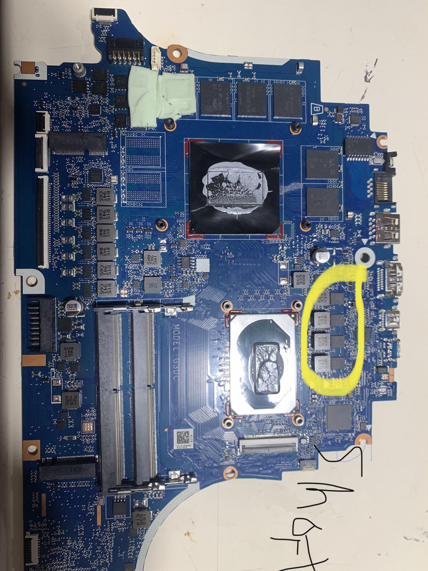

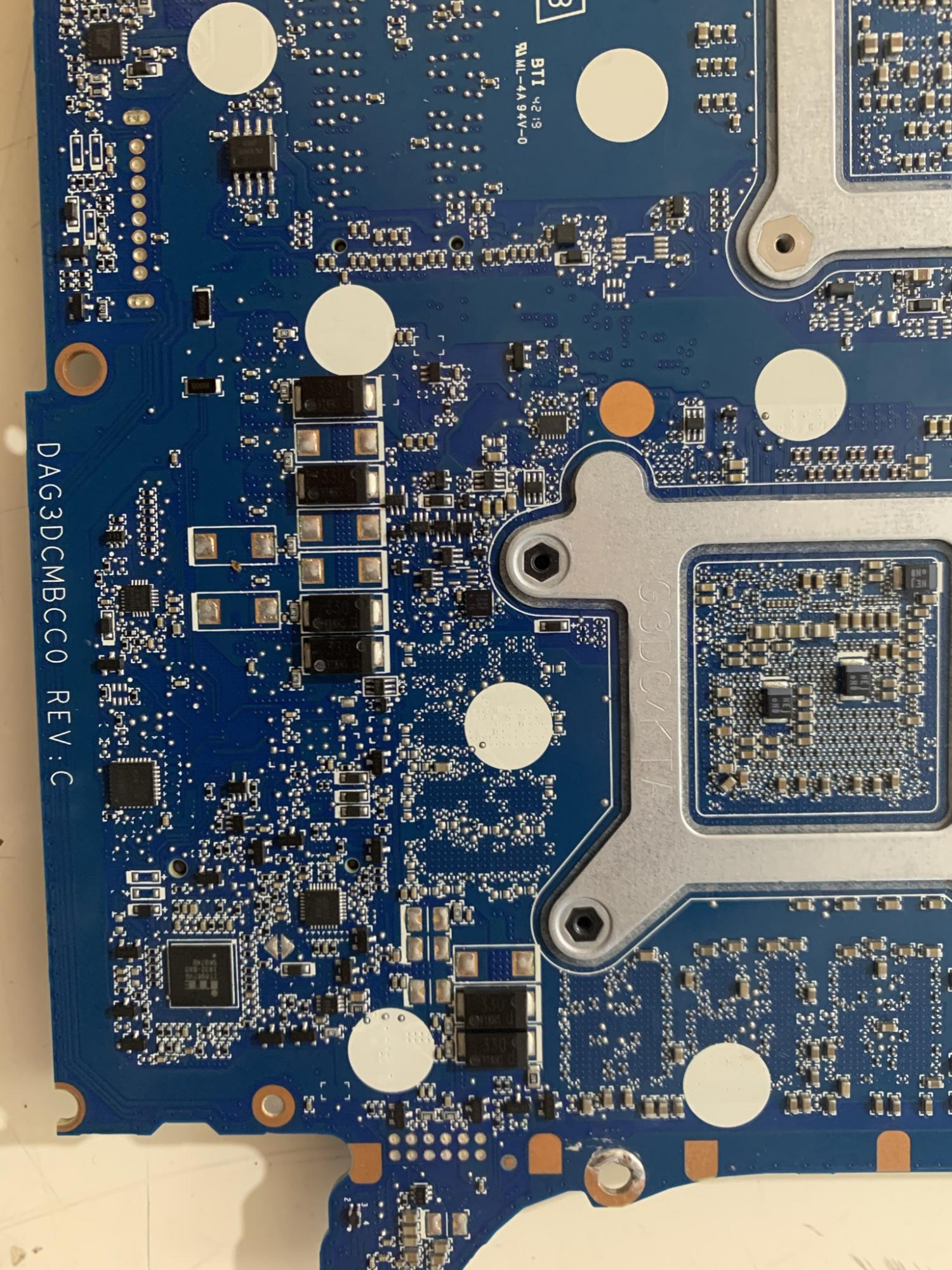

                                  ok guys so...
                                  i decided to turn up these coils that gives power to cpu and now the cpu measurement is 2.3 ohm so thats normal
                                  in the image that i attached see in black one coil tha gives full ground and in the blue these coils give 511 each in diode mode so i think that the mosfet or something in that line is causing the short
                                  ill inject some voltage and i will keep you update
                                    Not shorted likely. Meter will buzz in diode mode as its supposed to be very low resistance. Measue in ohms mode and not in diode mode.
                                      yes this measurement was in diode mode an resistance an resistance shows 0.002 ohm i think is full short
                                        For sure.
