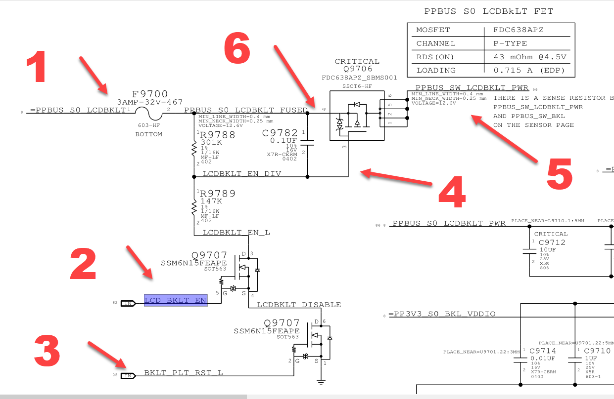

    Hey guys, i received this 15" MBP Retina previously touched by other messy hands. They previously attempted to disable graphics card but i removed the jumpers and took everything back as it was, I resoldered U8900 and got video output through the screen and loaded to operating system (throught HDMI it does give picture but somewhy it crashes before it can even load the progress bar, gray screen appears with "Your computer restarted because there was a problem").
    Getting back to the issue, the chime sounds distorted, and still don´t have backlight (the water indicator on the backlight zone is red, client says it never got liquids spilled ).
    No voltage at Pin 1 of J9000, PPVOUT_S0_LCDBKLT.
    Backlight diodes, and filter caps are not shorted to GND neither show low resistance. I´ve got this readings on the Backlight IC:
    U9701:
    Pin 2 (LVDS_BKL_PWM_RC) :1,44v
    Pin 4 (BKLT_EN): 0v
    Pin 6 (BKL_FET_CNTL): 0v
    Pin 8 (PP3V3_S0): 3.3v
    Pin 10 & 11: (BKL_SDA & BKL SCL): both 3.3v
    Pin 22 & 23(PP5V_S0): 5v
    Pin 24(BKL_SW): 0.3v
    D9701: 0v
    Q9706:
    Pin 1: 12.57v
    Pin 2: 12.57v
    Pin 3: 4.11v
    Pin 4: 12.57v
    Pin 5: 12.57v
    Pin 6: 12.57v
    Appreciate any clue or help, I suspected of backlight IC but unluckly havent got any to test

    Re: A1390 820-3332-A No Backlight
    hi.
    1) I think that 820-3332-A = A1398
    2)
    U9701:
    Pin 4 (BKLT_EN): 0v
    So backlight will be disabled.
    Review and post the voltage values for the referenced locations.
    3) voltage on PPBUS_S0_LCDBKLT_PWR = L9710, pin 1 ?
    4) voltage on R9731, pin 1 = PPBUS_S0_LCDBKLT_PWR ?

      Hey!
      1) right
      2) Reference voltages;
      1> 12.56v / 2> 0.023v / 3> 3.33v / 4> 12.201v / 5> 0.001v / 6> 12.56v
      3) 0v on L9710
      4) 0v on pin 1 R9731

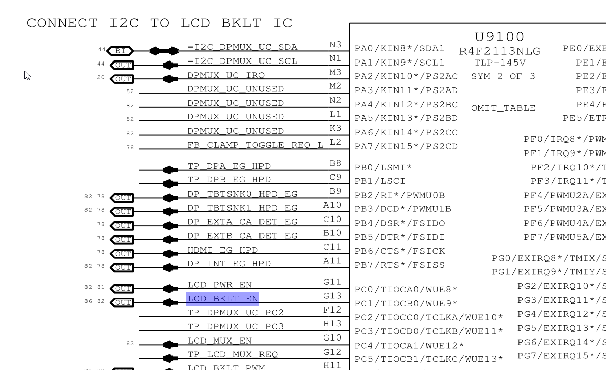

        If it helps I previously attempted this: I jumped (LCD_BKLT_EN) to PP3V3_S0 in the U9100 area, and at pin 1 of LCD connector (PPVOUT_S0_LCDBKLT) I got 12.54v.

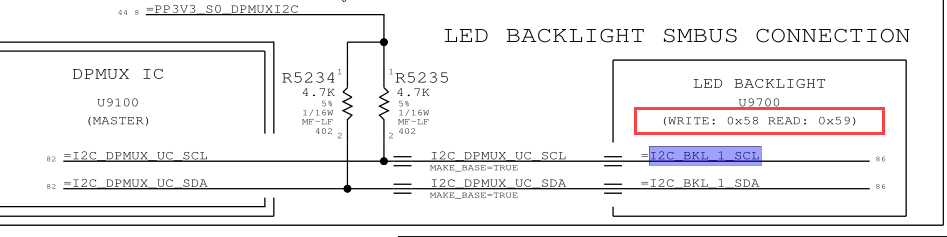

            PPVOUT_S0_LCDBKLT - I got 12.54v
            With the bypass trick, this rail is still too low for the backlight.
            Perhaps consider to replace U9701 (LP8545SQX-EXTJ).
            From assorted other posts, the backlight will enable only if the LCD is detected. However, if you are bypassing the turn on logic with your own external logic levels then this boost power supply should just enable and generate the much higher boosted voltage.
            Suggest to continue to try your bypass method but remove the LCD display till the backlight voltage is deemed to be a safe and 'normal' value. In my opinion, U9701 is only a boost power supply that should operate as designed once the enable and supporting components are functional.
            https://www.aliexpress.com/item/4000...archweb201603_
            I think you can source the same part (different suffix) directly from TI.com webstore:
            https://www.ti.com/store/ti/en/p/pro...-findchips-wwe
            Not sure if Apple had a custom version of this component manufactured for them but confirmed through the datasheet that at least the I2C slave address for this device matches the Apple schematics. Perhaps someone in the forum has sourced the original TI to replace this component with success ? It is worth a try and may be easily available through your local electronic parts resellers.
