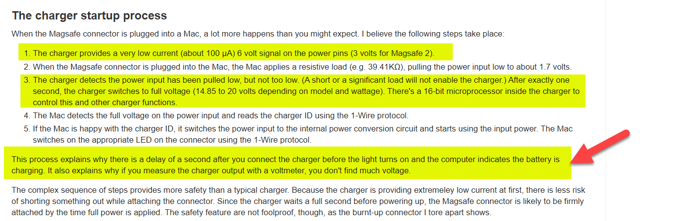

                    @Askic, measure the magsafe connector pins on your homebrew charger and plug in the AC.
                    What voltages do you read on each contact?
                    If you see a high voltage on any contact, then the custom charger you have built is still not following the Apple spec and is dangerous as the fakes from Asia.
                    The adapter must do a soft start to the max power rail only when it is safe to do so.

                      The point of trying with fake Magsafe or lab power supply is that they don't have a sleep mode.
                      https://logi.wiki/index.php/Magsafe_Sleep_Mode

                              The point of the Magsafe sleep mode is to:
                              1/ prevent sparks when plugging the Magsafe into the machine, which can accelerate the degradation of the Magsafe port,
                              2/ prevent creating short circuit if a metal piece shorts the pins, remember that it is magnetic so something can get stuck inside it and not necessarily trigger OCP but still cause overheating,
                              3/ prevent sending 14.5V-20V to the 1-wire circuit if the connector gets misaligned, and even though there is a protection on the board sometimes the 1-wire circuit still gets damaged.
                              Note that this has nothing to do with the original topic. I was only asking to try with a fake Magsafe because an original one will not go out of sleep mode properly if it does not measure the correct standby current.

                                    If I understood correctly, you used HP charger with 19 V output, and original charger is 14.65V? I know that Paul Daniels uses 18V for A1466 also, but I didn't use 19 V charger, because I was afraid that some of the input caps can go short. I know that on PC laptops, input filter capacitors are 25V, but I'm not sure about Macbooks and never tried 19V, but I'm glad it works.
                                    Piernov and mon2 have explained what is the difference between original and modified charger. I hope piernov can help use fully understand what could be wrong on the board to cause such delay with original charger.
                                    I know this is not original question, but I'd like to know one more thing.
                                    If I cut low voltage cable with magsafe2 connector at about half length, there will be only two wires.
                                    Now because of the sleep functionality of the original charger, if I measure voltage, there shoud be only about 0.6 or 0.7V and 15V would show up only after negotiation with the board. Is that right?
