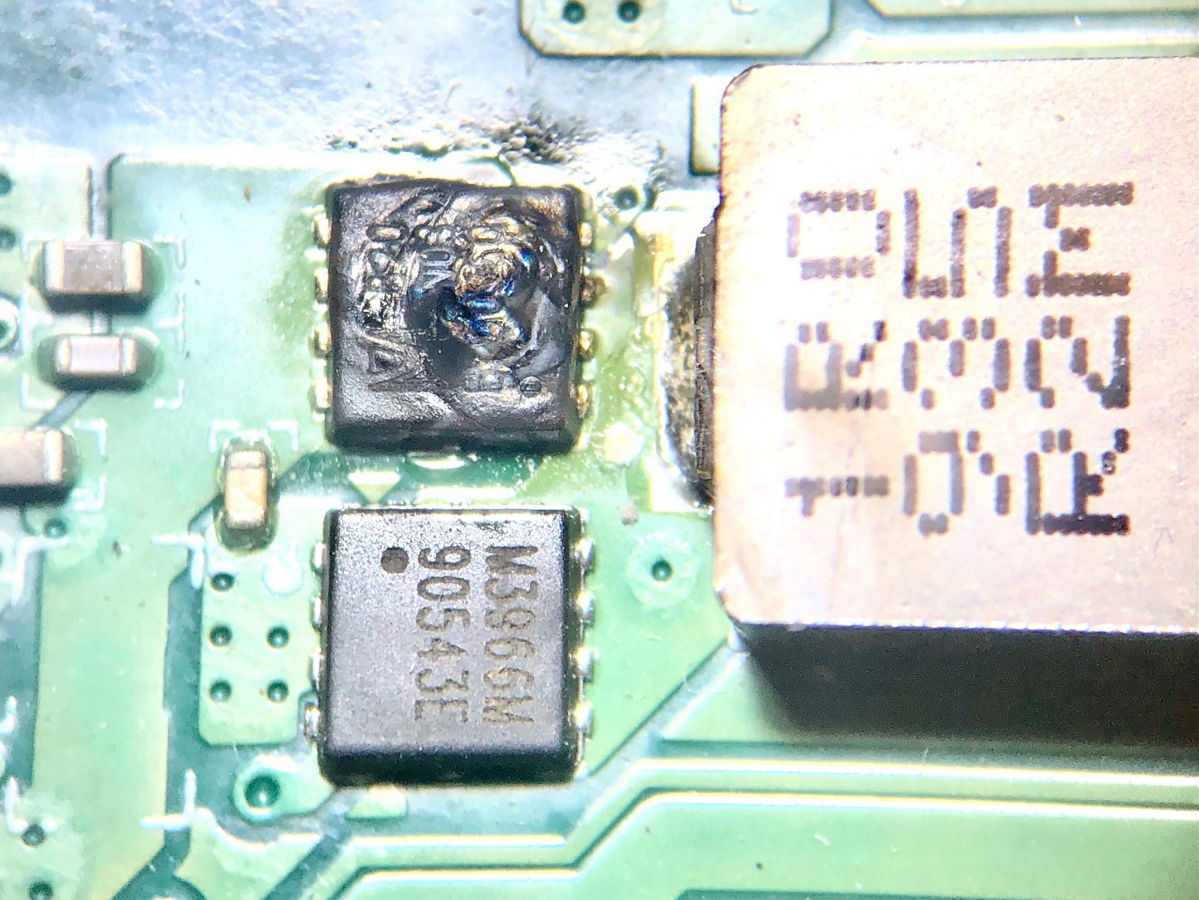

    I have a HP 15s-fq1512sa with a blown element next to M3966M. Markings not readable any more, but I suspect it's the same chip, just want to be 100% sure (pic attached).
    Also, what are the chances of finding a boardview / schematics for this laptop?
    Thanks!

    High-side and low-side MOSFETs are often different.

      What's my best bet of identifying the mosfet ?

        Re: HP 15s-fq1512sa Help identify the chip / boardview needed
        The picture shows the n-channel hi-mosfet. mosfets used in a similar circuit on the board will be effective. On the +19 line.
              @Sametbey posted above:
              Can confirm if you can post more markings of your logic board. The HP model schematic does not appear in my database of drawings.
                Hi, this mosfet is a AON32320C and this is N-ch
