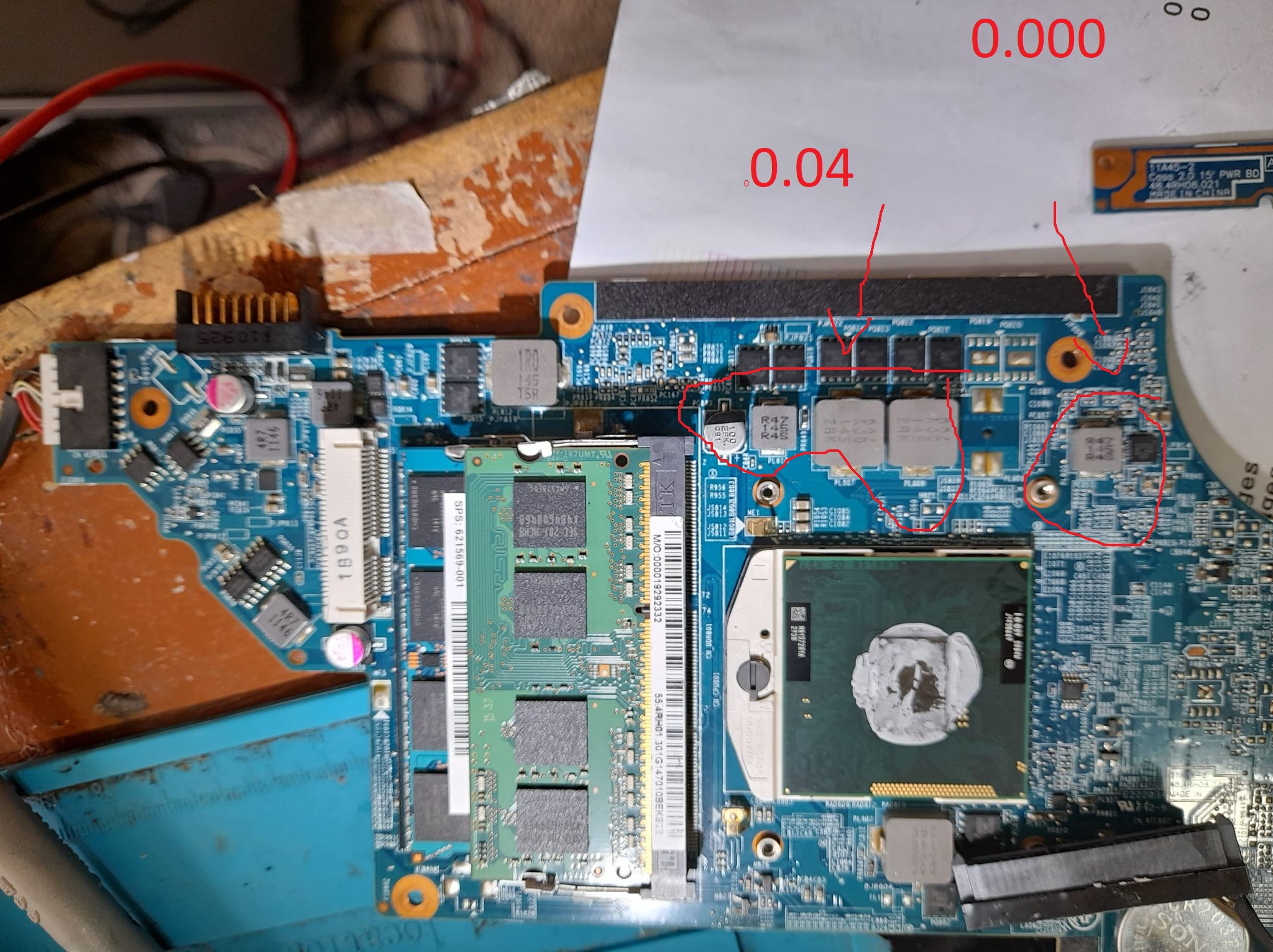

          Re: HP DV6 cannot turn on
          Post any schematics/boardview files if you have them.
          Any liquid damage?
          If not, post clear close up pix for the logic board near the dcin connector.
          Power down and check the resistance to ground on all coils.

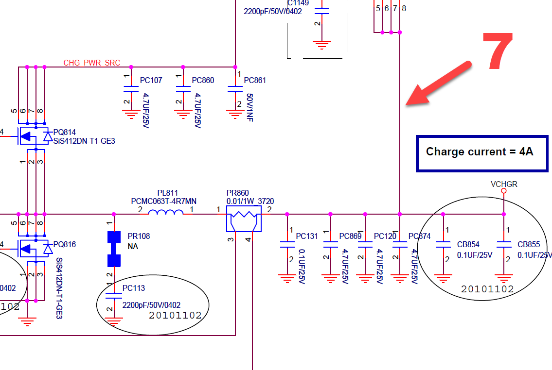

            thanks attached is the schematic and picture

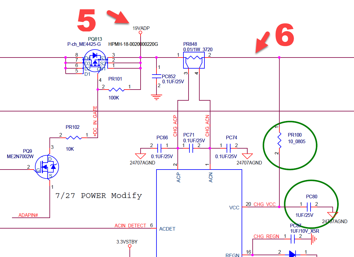

              i check pc78 pc88 pc84 pc100 for short pc 100 is shorted i will try to replaced if the prob is gone
                Replacing pc 100 still same issue cannot turn on

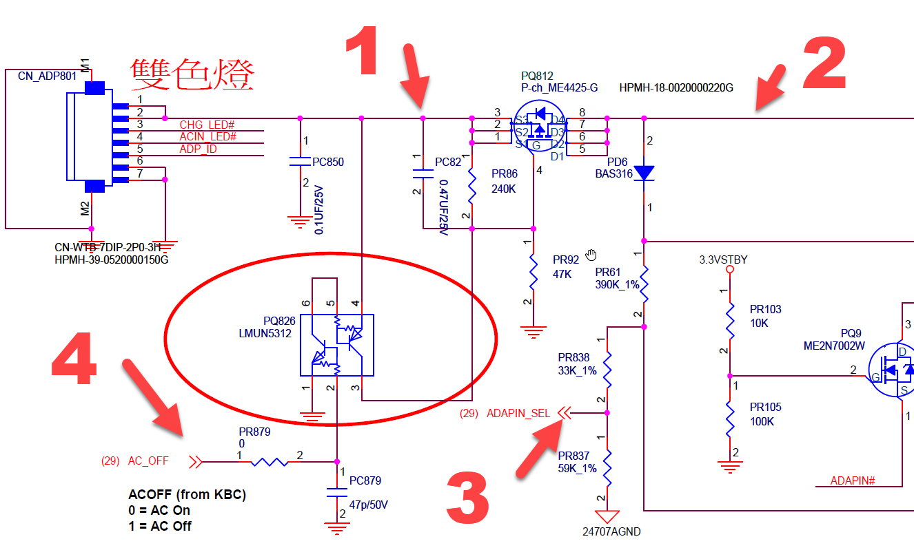

                    1) Study page 40 of your posted schematics. Any chance you have the boardview file for this logic board? Please post it if you do.
                    2) post the voltage readings with your external adapter attached. Check if the power switch is working or not on location 4.
                    3) With the reported 5 mA current draw from your power supply, your DCIN to logic board is not working. Issue is most likely on page 40 of the schematics.
                      all that mentioned at page 40 have voltages, i flashed the bios not the amps is drawing 0.003 and when i press the power button it goes to 0.007
                        have you checked the power jack and the AD_ID circuit
                          @smdflea pin 5 on the dc in ADP_ID has 0.965v

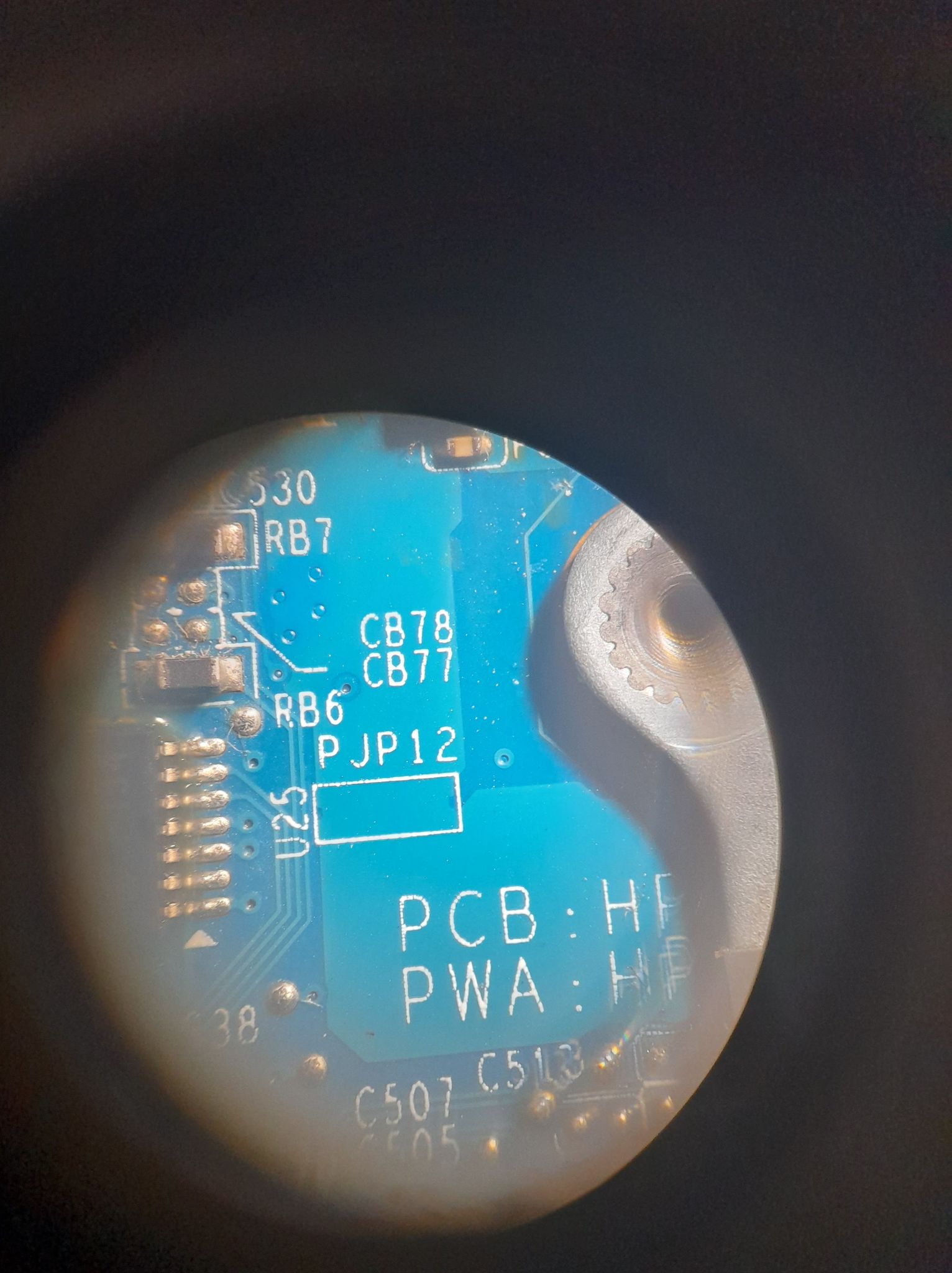

                                  Hi
                                  open PJP12 Jumper and messure resistance on both side
                                    @MIELTA pjp12 no component on the board
                                      right it is only an solderjoint
                                        on the image where is the soldere joint?
