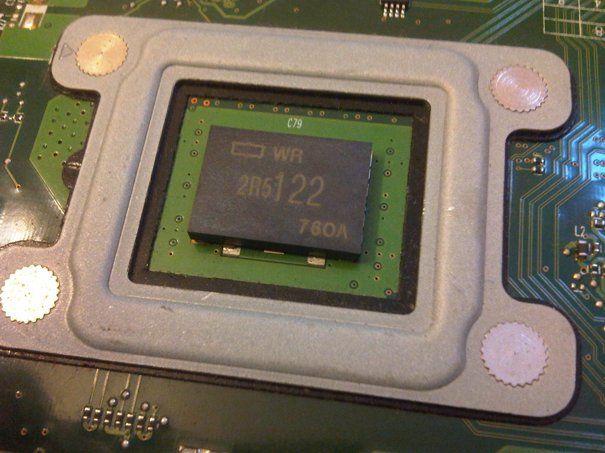

    and one last question if you don't mind, how can i check the capacitance of the NEC/Token while it is on-board? thank you so much
    2000uF is fine, as I said desktop motherboards regularly use >10,000uF.

      thanks boss...i will try to find some capacitors online..as my area doesn't have electronics shops selling the SMD tantalum capacitors..but can I check/test if my NEC/TOKIN capacitance is not as good as it was?? as i see the place of the NEC/TOKIN is hard to test using a multitester..how can i check the capacitance since it's under the CPU??

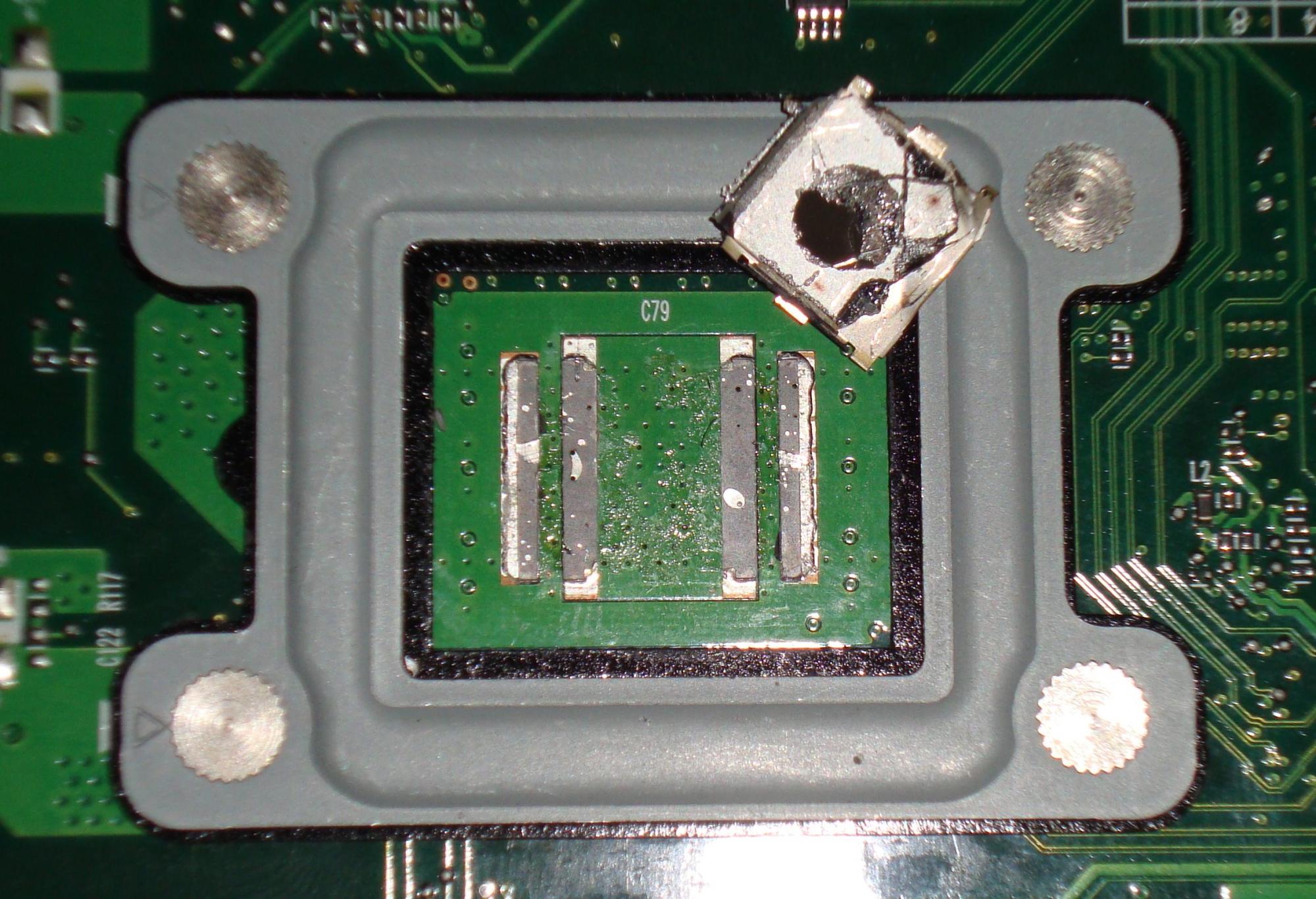

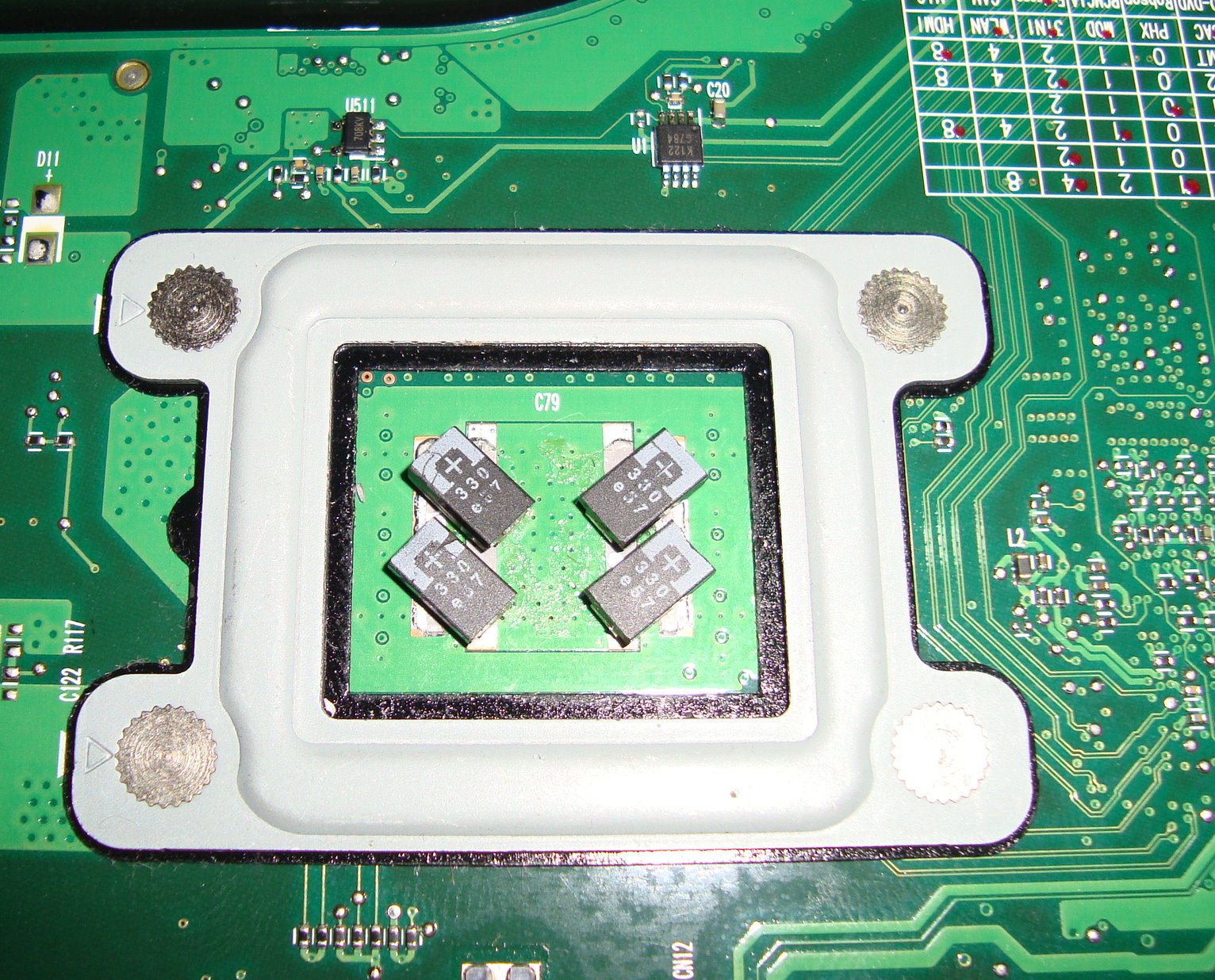

            OK, I got it. I used 4 smd caps 330uf of 2,5V that I took from an old scrap board. The Nec/Tokin caps came out in layers from top to bottom. Using a tiny flat head screw driver to pry it off. The soldering was bit more difficult, but nothing that a bit of acid and 60W soldering iron couldn't do. Patience is a virtue in this type of job.

              "acid"? Acid flux?
              You should clean the board if you haven't done so, or the flux will eat the traces and cause even more problems later on.

                I did clean, as you can see on the picture. I don't know the name in English... but it's a type of soldering paste used to help the solder to "stick" to the parts to be soldered... I believe it's some sort of acid paste. Thanks for the heads up.

                  b700029, he probably meant flux paste.
                  PVH, congrats, perfect job!

                    I also got the problem solved using 4 capacitors. Thank you ablacon64 and all other guys contribute in this thread.
                    BTW i also added some flux, how do i clean them (flux) after the soldering is done? If i dont do will it cause problems later?

                        Most good fluxes are no clean. But you can clean with isopropyl alcohol. I use ethyl acetate (CH3COOCH2CH3). It's a very strong solvent and does not damage the board. It's more expensive than isopropyl alcohol but only 2 drops can clean a 4x4cm area easyly. I use 100% pure ethyl acetate, but the diluted version that is found in drugstores will do the job just fine.

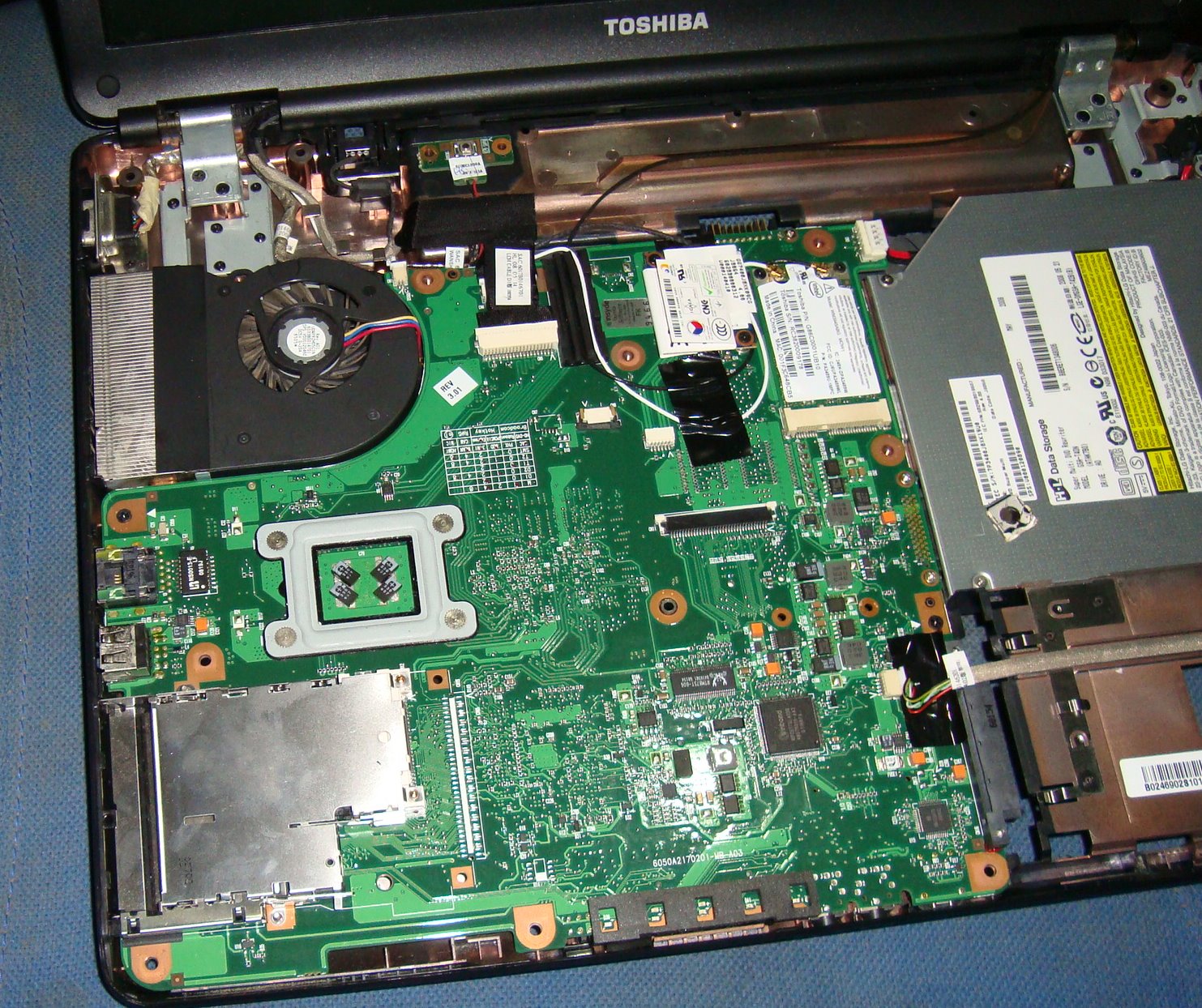

                                    hey PVH, Thanks for the reply. Somehow I managed to get those screws driven out. Here is the picture of the cap.
                                    Now whats the next step? I am really not good with the technical stuff. What hardware should I get from Digikey or any other electronics shop?

                                      Hey, I noticed that you have a different caps there... it would be good to have some input about that, as for what I know the Nec/Tokin was the bad guy.
                                      Hang on, let us hear from the tech guys... you're not very far concerning the replacement procedure.

                                        ^^ Yes its a different cap. But the values should be same right? P.S- Its a Toshiba L300.

                                          Not exactly, as there are different processors for the same model... in my case it's a Intel Core2 Duo T5870 @2.00Ghz. Anyway, I haven't research yours but if it has the same values and the symptoms are the ones described on this thread, just go ahead and pry it off.
