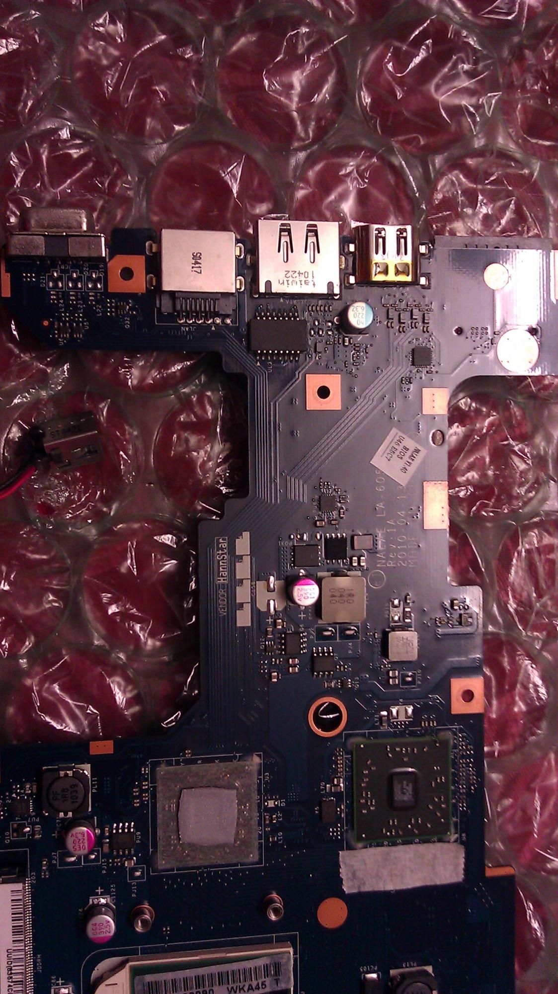

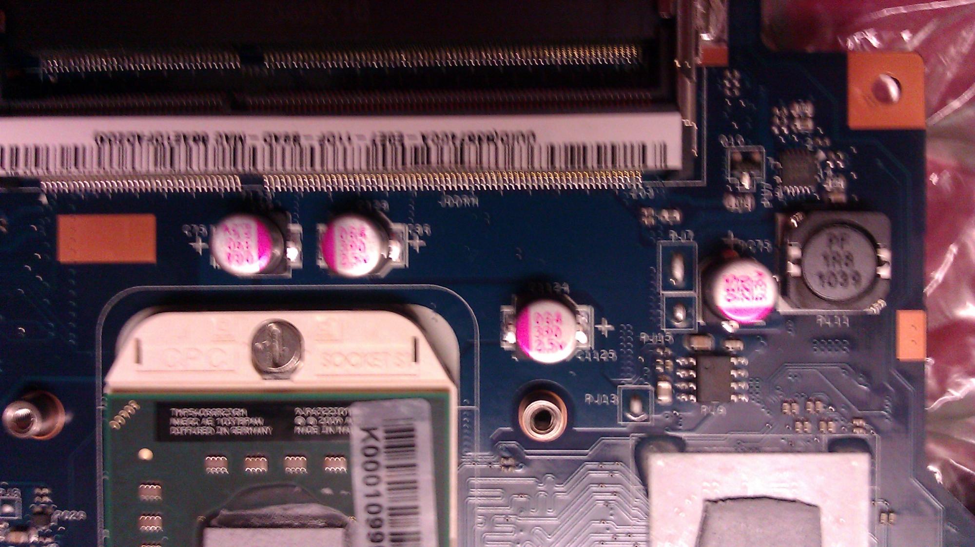

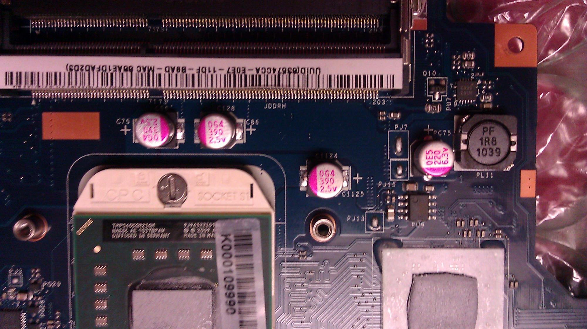

          #204

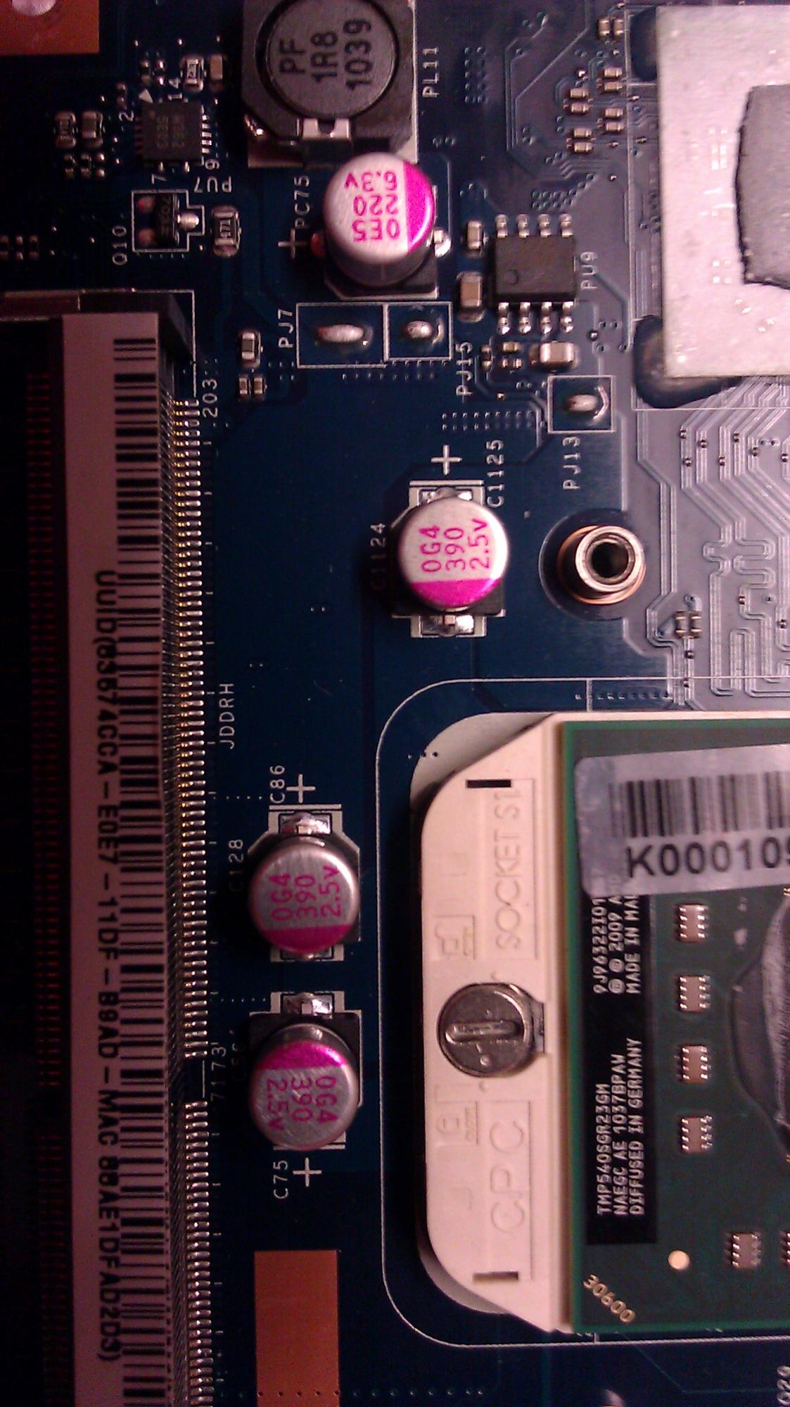

          Re: Toshiba Satellite - Locks up when plugged in
          EXPERTS - Please look at attached.
          I have the same issue, Toshiba L675D-S7049 laptop works perfectly fine on battery. However, once plugged in, either immediately or after a bit of time, laptop completely freezes and only hard power shutdown does anything.
          I have tried countless remedies to no avail. I opened up laptop & attachments R pics of mobo. It does not have da NEC/TOKIN caps, however, there are:
          Mobo: NALAE LA-6053P
          Rev: 1A
          3 0E5 220 6.3V
          3 0G4 390 2.5V
          3 0J4 VLPS 330 2.5V
          (the little round metallic partially purple items in the picture attachments)
          If I am focusing on da wrong items, please let me know. Otherwise, which ones should I change and with what??? Please help, your assistance would be greatly appreciated!!
          If needed, I can take additional photos of different areas & post.
          PLEASE HELP....

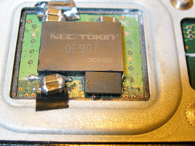

              #206
              Hello to all.
              I followed the instructions of the post with excellent results (no more artefacts), but the notebook still shut down occasionally.
              In the pictures you can find my solution
              Foto 1 - Removing Tokin with Dark IR
              Foto 2 - Removed
              Foto 3 - Cleaning
              Foto 4 - My solution
              Best regard,
              Daniele

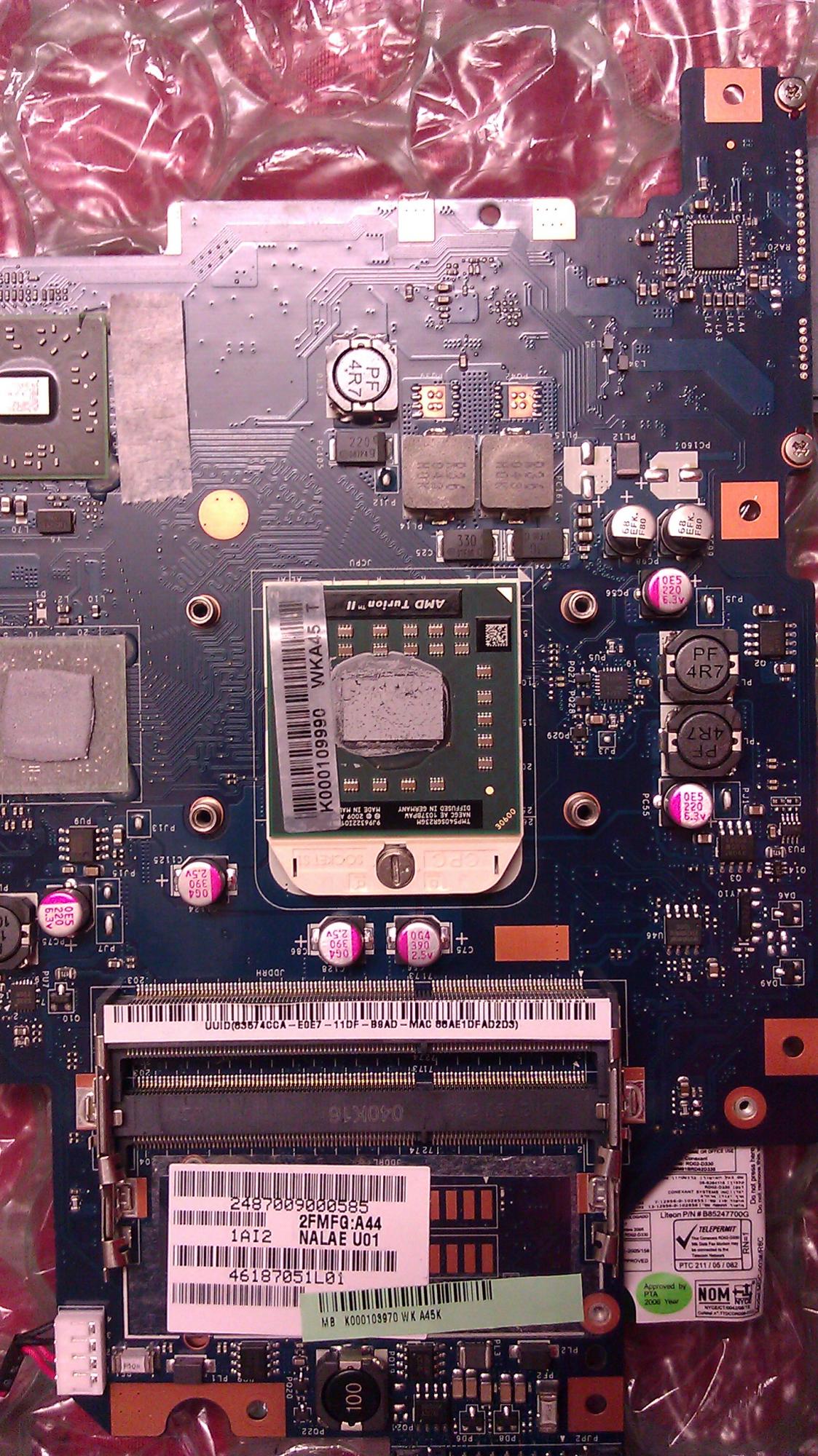

                hi , yep u r in the wrong area , the TOKEN/NEC is located in
                the other side of the mobo , directly UNDER the processor ,
                check that area and upload some photos .
                your laptop is AMD , that have more known issue
                regarding heat desipation , you may need to address.

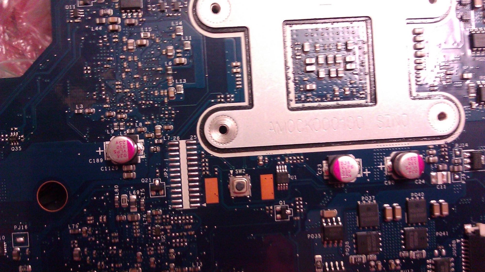

                      #210
                      Hello Somisa8v
                      Thank you so much for your reply. Unfortunately, there is no TOKEN/NEC in this motherboard. I have tried countless suggestions from the web and was very happy when I came across this forum because the issue on this thread was EXACTLY what I was experiencing, laptop works perfect on battery, but freezes either immediately or a little while after plugging it in. Consequently, I believe a similar solution exists for me since so many others on this thread have succeeded with replacing the capacitor(s).
                      I did take additional photos per your suggestion which are attached.
                      The first two pictures are each sides of the processor. I checked directly underneath the processor and throughout but no TOKEN/NEC.
                      If you could guide me, I would greatly appreciate it. If you need any additional information, please let me know.
