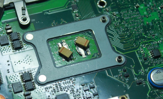

                      #530
                      Re: Toshiba Satellite - Locks up when plugged in
                      Thanks all people i have soldered my Toshiba A200 with right caps,
                      two 470uF. I have ordered them from in.rsdelivers.com [India].
                      737-2832
                      Just using a small knife i removed top layers of TEC TOKIN 0E907 without using anything else. I can't remove last layer as it was soldered to the PCB , and i put SMD 470uF caps on the conductive layer using 40 W solder iron.
                      Any more Q can contact on tapasxplore@gmail.com . Will be pleased to Help you.
                      View my attached file.
