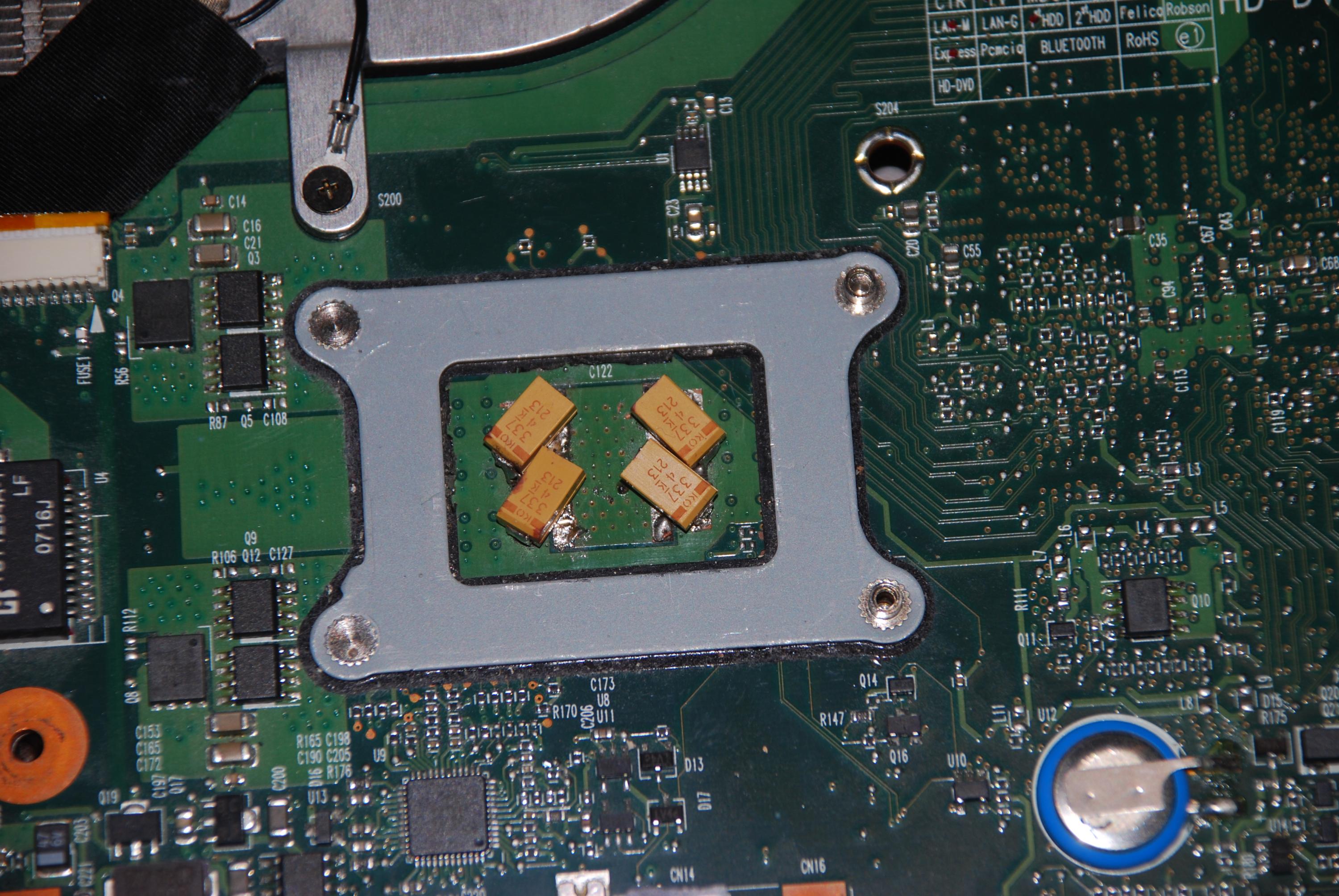

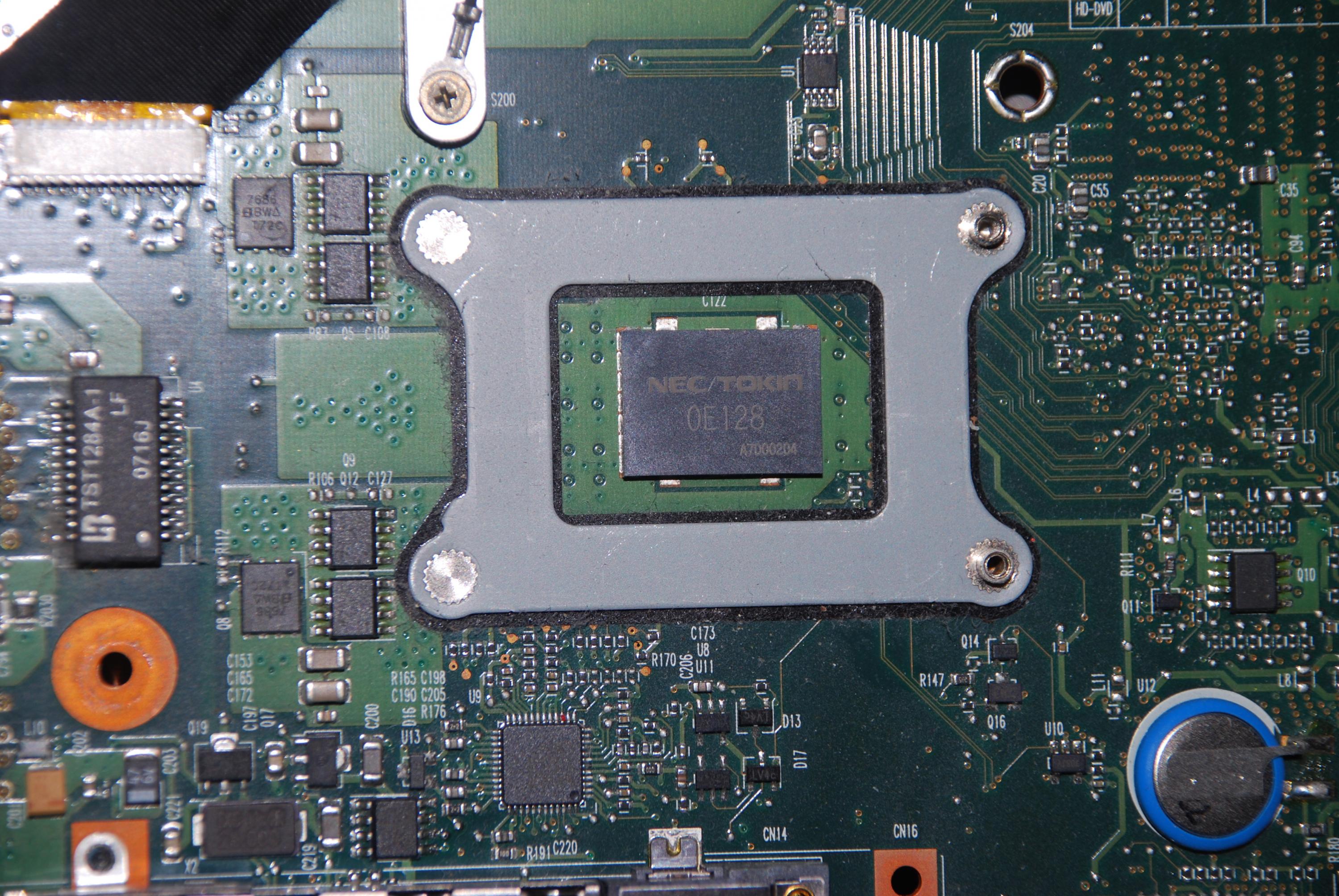

            If anyone is interested I repaired my Toshiba L305-S5875 with the help of this forum. Thank you!!
            The laptop used the NEC Tokin 0E128 and I replaced it with 4 Kemet capacitors P/N T520V337M004ATE007 from Mouser for $3.12 each. USPS priority mail is about 5 bucks and they deliver in about two days. They were 7mOhms, 4 volts at 330uF. I used the 4 volts only because they were cheaper than the 2.5 volts and it does give it a bit more voltage margin. If that even matters. $20 bucks delivered to my door and it fixed the deal!!
            Also the gap between the two conductors is rather small and it would be easy to short the cap across it when soldering. I just scraped of some of the green solder resist to exposed a wider conductor bar, tinned it and soldered on the caps almost perpendicular to the existing bars with plenty of room.
            The unit powered up and works great!!! Thanks for the help.

                            The only pictures I took were as notes for assembly. If it's any help, here is a picture of the chip that was replaced.

                                  I just fixed my Toshiba A205-S4777 by following all of the great advice on this forum. I'm thrilled to have my laptop working without locking up while plugged in.
                                  I used 4 T520D337M004ATE007 from Digi-Key for about $12 delivered to replace the NEC/TOKIN OE128.
                                  http://www.digikey.com/product-detai...57-1-ND/992090
                                  This was my first attempt at SMT soldering.
                                  Thanks again to everyone for the detailed posts.

                                      Re: Toshiba Satellite - Locks up when plugged in
                                      This is my solution.
                                      Firstly, I didn't want to take nec-tokin 0128 out before seeing inside of it. Cause since I am living in Turkey, It could be very hard to find right caps. (laptop is A205 Toshiba)
                                      Anyway, without damaging the interior parts, I cut upper side of nec-tokin.
                                      Carefully made this with a razor blade. after doing this it was obvious that problem was nec-tokin.
                                      I am sorry could not take photos (No camera). A very small area of silvery surface was yellow.
                                      Then with a quality watch maker tweezers I started to scrape the whole surface of bridge till it became black.(not more than)
                                      Cleaned with a damp cloth many times while doing this.
                                      Finally put some flux around, upper and undersides.
                                      Next day I powered up the machine which was ten days ago and my laptop is working well almost notstop up till now.
                                      In my opinion this can be tried once as removing nec-tokin may not be the only solution. (in some circumstances)
                                      Thank you very much.
