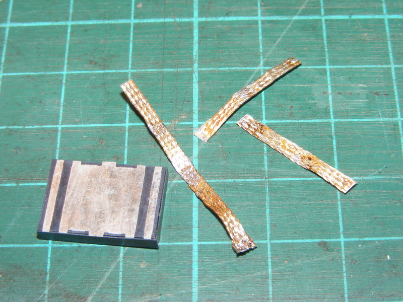

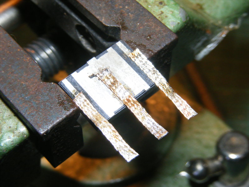

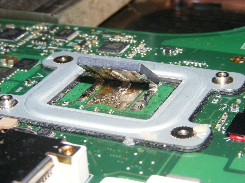

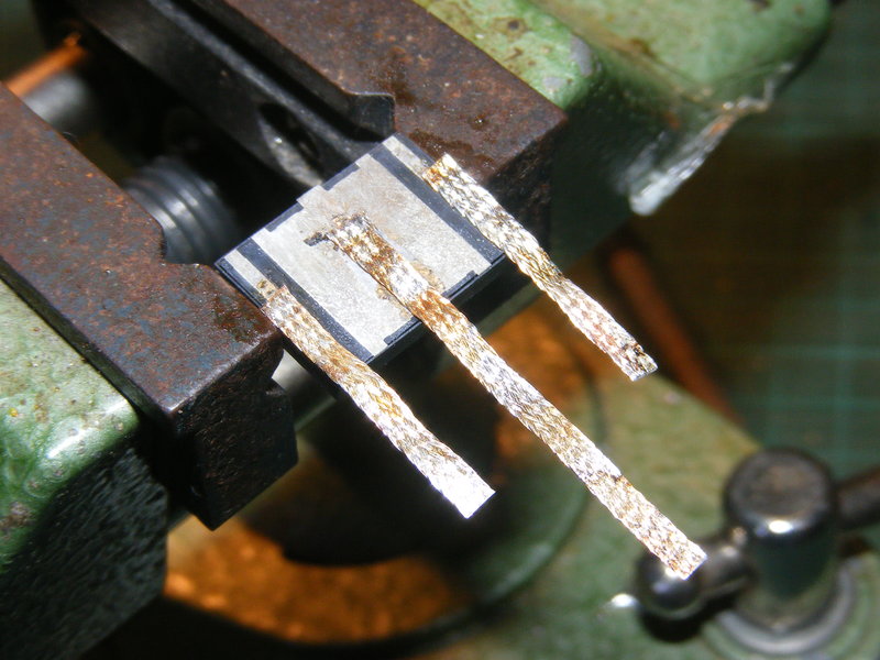

                  Okay - I've got a completely different way of doing things now, this just 'came' to me during the night, not sure how well it'll work for everyone though.
                  Basically afaik the problem with the NEC/TOKIN replacements is that we invariably cook them shortening their lives, so I went with this method to avoid that, not to mention it's easier to install.
                  1 - Take your NEC/TOKIN cap and 3 x ~2cm lengths of braid,
                  2 - Tin the pads slightly
                  3 - Attach the braid to the pads **( Yes, I know I've done mine in the middle, because I had already scratched away the solder resist, for non-resistremoval jobs just split the braid down the middle )
                  4 - Trim them up
                  5 - Fold back
                  6 - Solder to main board.
                  Helps a lot too if you can preheat the mainboard a bit. I'm using a 100W station to really get the heat down quick, but the board was preheated to about 150'C to help it all along.

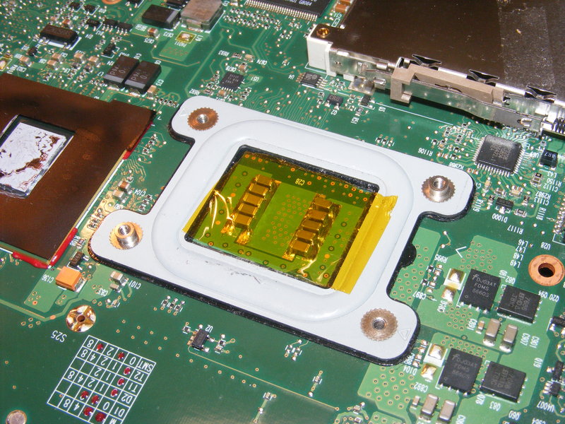

                          UPDATE:
                          Just letting you know the 10 x ceramic option works out nicely here on an A300. Very easy to install as well thanks to them being small (relative to the tantalums). The big downside is that they're fairly expensive, about $30 for a set of 10 here in Australia, so that's twice the price at least on a comparable tantalum option.
                          http://au.element14.com/jsp/search/p...15&Ntt=1601815 ( Kemet C1206C107M9PAC TU )
                          *NOTE* I did put an thin insulating barrier on the metal plate that goes above them, though there is an airgap I still didn't want to take chances. Kapton tape would work fine.

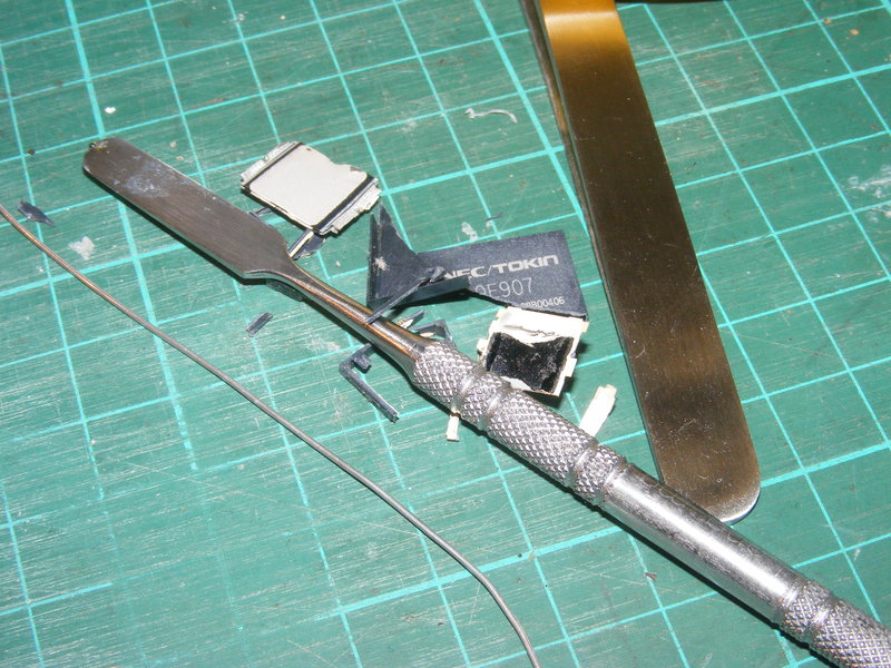

                            Today's job. Getting quite quick at doing it this way now. I find using one of those stainless steel spudgers and a 100W station with a broad tip really makes fast work of peeling off those outer cap strips that are left behind when you break off the TOKIN (the spudger is also excellent for breaking off the cap).
                            I am preferring to use the 10 x 100uF ceramic option because it means I don't have to do any awkward soldering trying to tilt-fit in the larger tantalums.
                            Kapton tape on top of the caps at the end of course because you really don't want that shorting out.
