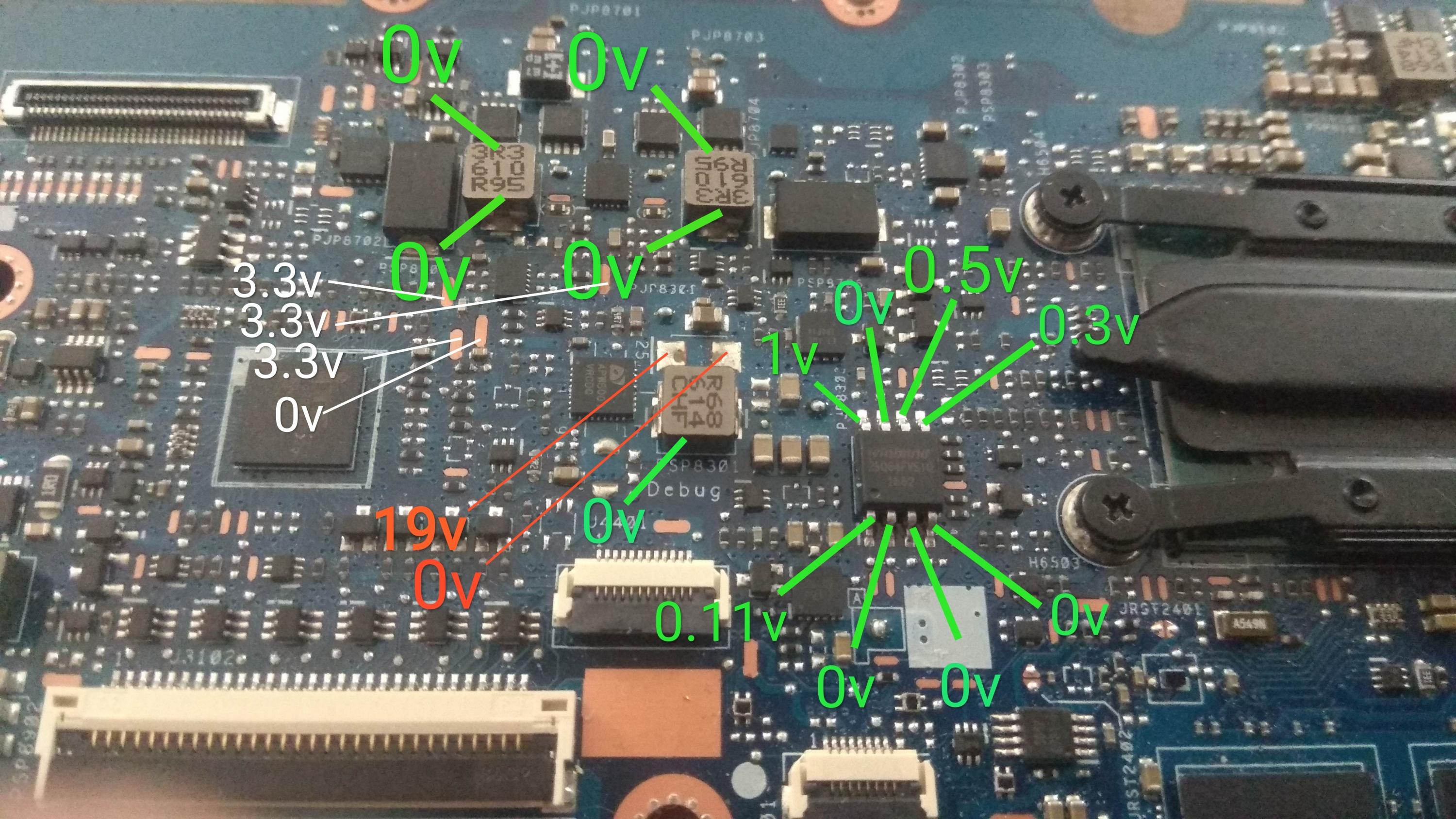

Help me repair this UX305 motherboard please
  • Clinteastwood1
    • Apr 2021
    • 23
    • France
    Re: Help me repair this UX305 motherboard please

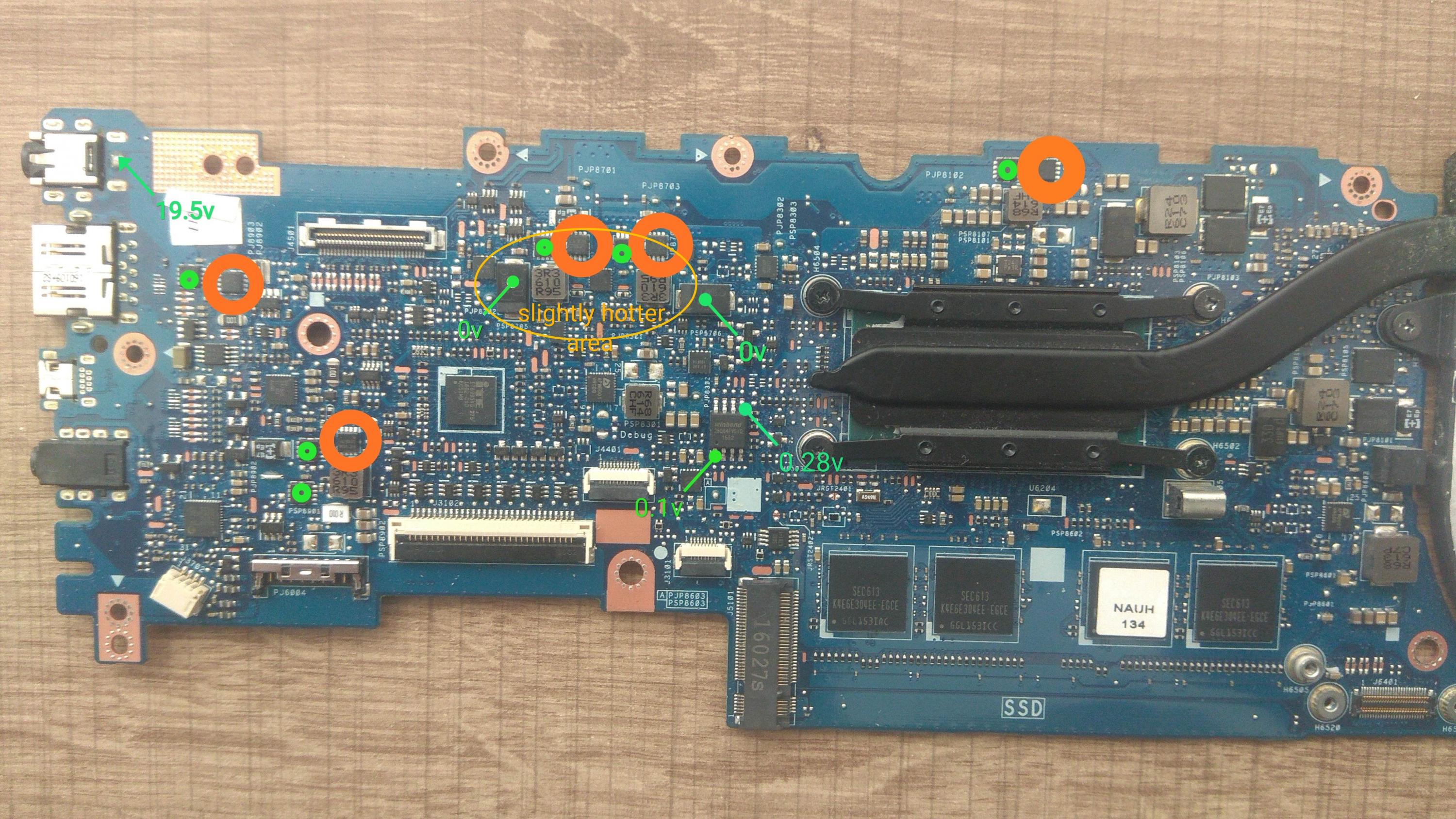

    Ok some people told me it's not reliable to use the ohmmeter to test mosfets so I took all the measures again in diode mode (testing random pins of the mosfets side by side). Please look at the pic below.
    Red circles = faulty mosfets
    Green circles=good mosfets
    Yellow area = slightly hotter than the rest of the board
    I really hope you can help me because I really do need this laptop

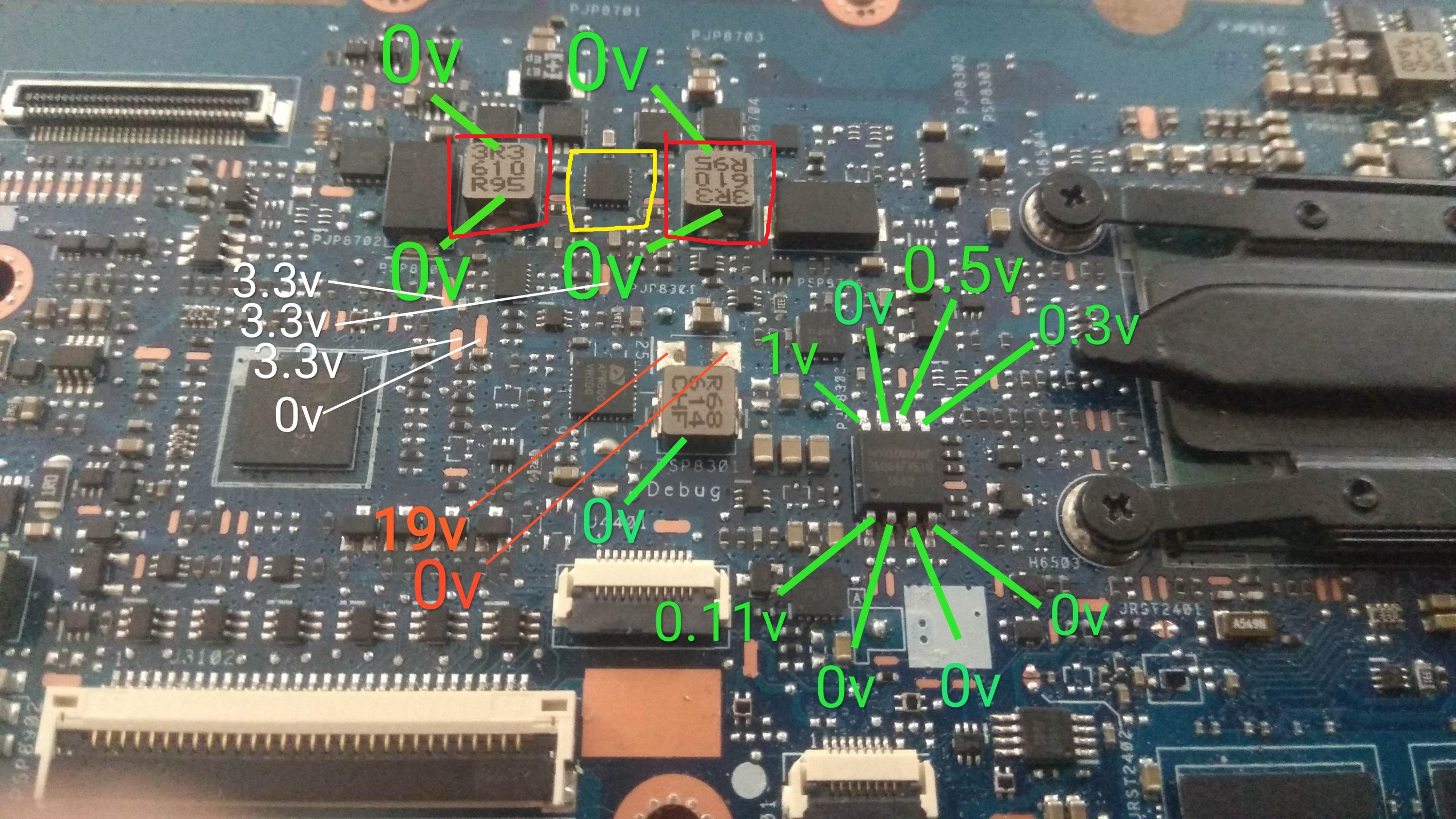

      Little mistake sorry, pin 8 of winbond bios chip is not the right one, it's the first one at the top and it reads 1v (it's pin 5 that shows 0.28v).
      It should read 3.3v I think so there is problem. Is this chip dead?
        On the flash chip, you are showing the voltage on pin #1 (pin close to the circle in the plastic housing). Then the pins count up going counter-clockwise.
        So you have measured, pin 1 and pin 5 from the last diagram.
        What is the voltage on pin 8 of this flash chip? It should be 3.3volts.
        Also good to check and post the voltages on each grey coil. Each coil is linked to a voltage rail.
        In general, each rail should work to make this laptop operate normally.
          Hi Mon2 thanks for your help. I took some measures as per your suggestions. This time I took measures for all the bios chip pins to avoid confusion. Also for coils.
          This area around the coils becomes very hot after a short moment.
          Thanks I hope it helps

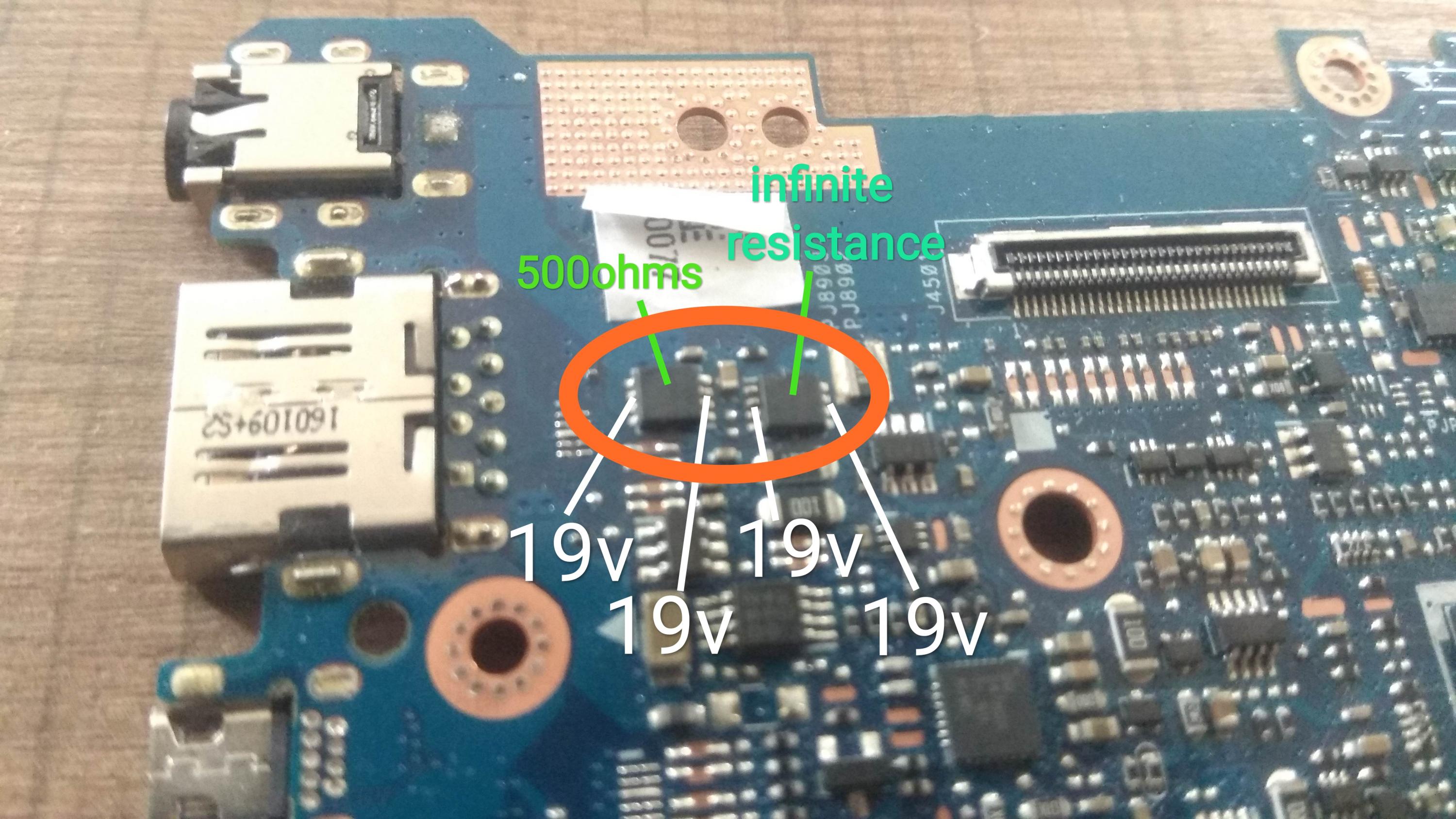

            Is this mosfet dead? Strange behavior
            I am trying to troubleshoot a laptop's motherboard, I measured the resistance of the 2 entry mosfets, and the second one seems to have a weird behavior.
            As a matter of fact, it has an infinite resistance (meaning it's dead, right?) but when I measure its voltage it shows 19v as the first one, as if it was fine...
            So is it dead or my method to detect dead mosfets is crap? ( I tried with the diode mode of my multimeter, it also shows there is a discontinuity)
            Thanks for your help guys.

                • 21948
                The best way to test mosfets is to desolder them and test on the bench. What make/model is your meter ?

                  Re: Is this mosfet dead? Strange behavior
                  Originally posted by SMDFlea
                  Your thread post has been moved from the "Troubleshooting Desktop Motherboards, Graphics Cards, and PC Peripherals" forum to this thread.
                  This thread was confusing enough with all my measures and posts I don't think it was a good move adding the mosfet measuring question, this thread is already overloaded I think and nobody still participate to it...
                  Ok thanks for your reply mate, if I desolder it I will replace it straight away no need to test it
                  I am going to replace all the mosfets on my board i guess, because I'm afraid I won't be able to troubleshoot it
                  Cheers

                      Here are my last mesures in the 3v/5v area (hot zone)

                        #31
                        Assuming you don't have a power Lab to find the short there is a alternative method give a try (FINDING SHORT ON MOTHERBOARDS WITH COMPRESSED AIR https://www.youtube.com/watch?v=AOALg_rDIZk )
                        put the multimeter continuity test the 2 coils on red and musure the readings the yellow is you 3/5 Regulate do the COMPRESSED AIR test arround this chip and see
                          Mate this tut is magic thank you !!!
                          I don't have any compressed air right now but seen in the comments that you could achieve the same with gas lighter oil or isopropyl alcohol, since I have both I'm gonna test it this way.
                          Before doing it (I'm not at home right now) and since this area on my board is very hot, couldnt we just conclude it's the chip you circled in yellow which is faulty, since coils don't get faulty, right?
                          And 2nd question, this chips reads "1285a tp 5c8 a3sh" do you know if I can replace it with this one with a slightly different ref since I can't find the exact one:
                          https://www.ebay.fr/itm/1PCS-TPS5128...b-15db0b89a2f9
                          Thanks again for this cool idea, and if this chip is making my MB faulty I surely owe you a big one my friend !

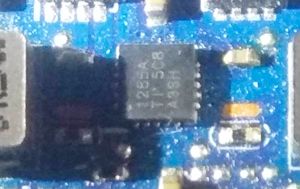

                          • Clinteastwood1
                            • Apr 2021
                            • 23
                            • France
                            #33
                            I made the alcohol test and the only chip on which alcohol evaporates very fast is this 3/5v regulator. I tested all the chips on the board and coils and mosfets and other components this is the only one causing the alcohol to evaporate in a heart beat.
                            Is there something else could test? Or I can replace this chip and hope for the best...
                            These chips are very tiny compared to the others, it won't be easy I should probably buy a dozen of them just in case
