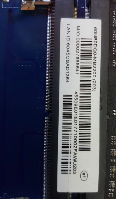

    Hello!
    Got this ROG laptop dead, with missing charging battery IC and some bad mosfets.
    Replaced everything and laptop now turns on as soon as I plug in DC power, but no image.
    Tried 2 BIOS dumps, EC IT8995VG-128/DX was replaced with a new one, but still no POST.
    Measured some signals around EC
    B7 PM_SYSPWROK 3.3V
    D8 PM_CLKRUN# 3.05V
    E8 P_SMB3_CLK 0V
    F4 PCH_SUSACK# 3.3V
    F9 IMVP8_PWRGD 3.05V
    G12 ALL_SYSTEM_PWRGD 3.3V
    M4 BUF_PLT_RST# 0.4-0.77 and changing
    So when I found BUF_PLT_RST oscillating, I narrowed it down to U2401
    PLT_RST is present as also +3Vsus, so just for testing, I shunted PLT_RST to BUF_PLT_RST
    Signal came up to 3.3V and board now takes -+ 1,3Amps , but still no post.
    Removed the short, and BUF_PLT_RST is 0V at the start, then goes to 2V after a few mins and fans start spinning full speed.
    Then keeps oscillating value...
    PCH is fairly warm, CPU/GPU coils are also fairly warm. GPU and CPU are not heating up much
    Is there something I could also check regarding clock signals or something else?
    Bad PCH?
    Any help is welcome, running out of ideas... and maybe knowledge
    Thanks!
