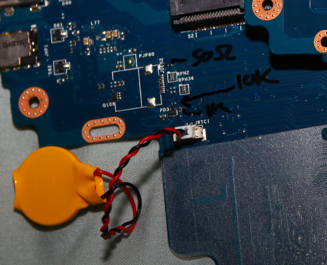

                  Re: Dell E6540 starts with Jack, but not with Power Button
                  What I don't get is why the bios battery voltage is getting through to the power button though?? That can't be normal. 2.5V is on the pb with the charger unplugged
                  Its coming as +RTC_CELL from the coin cell through PD3 -> R810. To confirm, you can remove the coin cell, it should go to 0V.

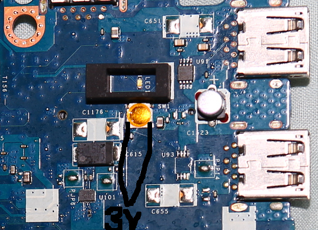

                    Hi folks, I'm really struggling here.
                    I actually replaced the startup chip from another old board which was successful but the original problem remains!
                    I have attached photos :
                    IMG8845. There is continuity between the PB and JAPS1 (6th pin down as shown). However, I can't find any continuity from this pin to anywhere else on the board. This image shows where the SIO would be (I removed it from this board to put on the board I am trying to fix). None of the pins in set A or B have continuity with the power button
                    IMG8846 shows where 3v measures on the PB
                    IMG8848 shows the fresh RTC battery and 3 resistance measurements on 3 resistors (1K, 10K and 50 Ohms). These are not labelled so I don't know if these are the R811 mentioned earlier??. None of these have any continuity with the power button
                    Can anybody help?

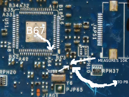

                      Per schematic you wont get continuity from power button to SIO since R811 is in series. Put your meter in resistance mode and measure resistance (remove coin cell before measuring) between power button and B67 of SIO, I would expect 10Kohm. If you measure 10K, it also means the path from PB to SIO as well as R811 is likely OK.

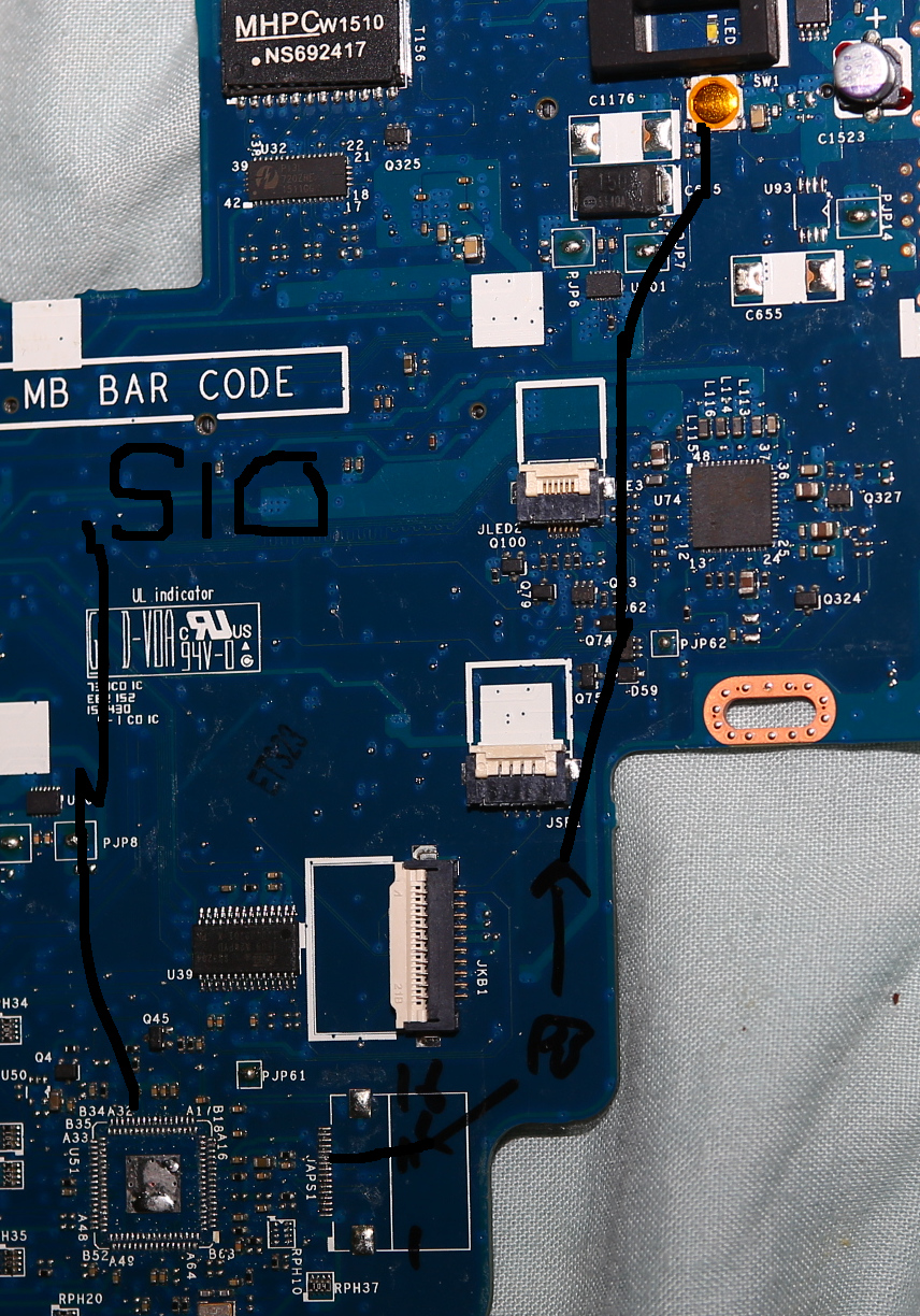

                        Hi Spider, thanks for your assistance here.
                        I managed to find R811 by pure luck - it is to the bottom right of U51 (SIO).
                        I have 2 boards, one I'm trying to fix and another which is for parts only.
                        I got a reading of 10K ohms as per schematic on the other side of the resistor R811 on both boards.
                        I could only test for continuity between R811 and B67 on my broken board from which I had desoldered the SIO exposing the layer B pins (it beeped).
                        Since R811 is literally right next to the SIO and the board looks physically very good, I would imagine there is continuity between R811 and pin B67. The problem is that B67 is not exposed on this chip - the only way to test would be to remove the chip, which I would rather not do again if at all possible.
                        Do you think that I need to do that anyway, just to absolutely confirm the path from the power button to B67 is good?
                        I think the problem may be that the SIO is refusing to start the board because of some other problem.
                        I still don't know why the voltage from the bios chip should be anywhere near the power button - normally the 3.3v comes from board power supply, not the bios chip?!! Also weird is the board starts EVERY time when plugged in even when the bios settings are saved when it should remain off.
                        Please see attached for summary
                        Any advice on what to do next? Many thanks
                                    Hi, well I managed to track down the various parts of the RTC section on the board which I had to do painstakingly because there is no boardview and many of the components are not labelled. (I also today fixed another E6540 board which had a short, so at least I now have a working board to compare against) I think I learned a lot just by trying to make sense of the schematic, especially when I found which part they corresponded to on the board.
                                    The output from PD3 (just next to the bios battery) is 2.7V
                                    CMOS1 measures 2.7V (and the associated resistors and caps). (It was on the other side of the board from the RAM slots, directly behind the BGA chip UH1) The schematic is full of different chips UH1A, UH1B, UH1C etc which I can't find anywhere on the board. There is only UH1, the BGA chip, just above CMOS1. I wonder if UH1A, B , C etc refer to particular parts of UH1?? How can you test without removing the chip to expose the pins?? I can't resolder a BGA chip.
                                    The other RTC section is near the audio chip (about an inch below the power button) and here is where I think I may be close to something. Page 30, R1084 measures 2.7V and 100ohms. This is in series with a dual mosfet Q327. The schematic suggests that 2 of the 6 pins should be ground and that is the case on my good board. HOWEVER, on the one I'm trying to fix the lower right pin is also shorted to ground. I removed the mosfet and the pin is still short to ground, so I put the mosfet back. That is as far as I have got today. If I can work out what is shorting that pin, perhaps that will solve this problem?
                                    So thanks MPC, for the RTC information.
                                    Spider, perhaps the power button not working is a product of the RTC problem? (Since the voltage from the RTC ends up on the PB by design) The PB does not register in any way with the board off, or booted into an o/s. I booted into linux and windows (no mods), but still the PB presses do not register either with a short or long hold press. I would know for certain if the PB presses are reaching the SIO only by once again desoldering the SIO to expose the pins, but I have a feeling it's the RTC fault causing the PB to not operate normally. What a head twister!!!!!
