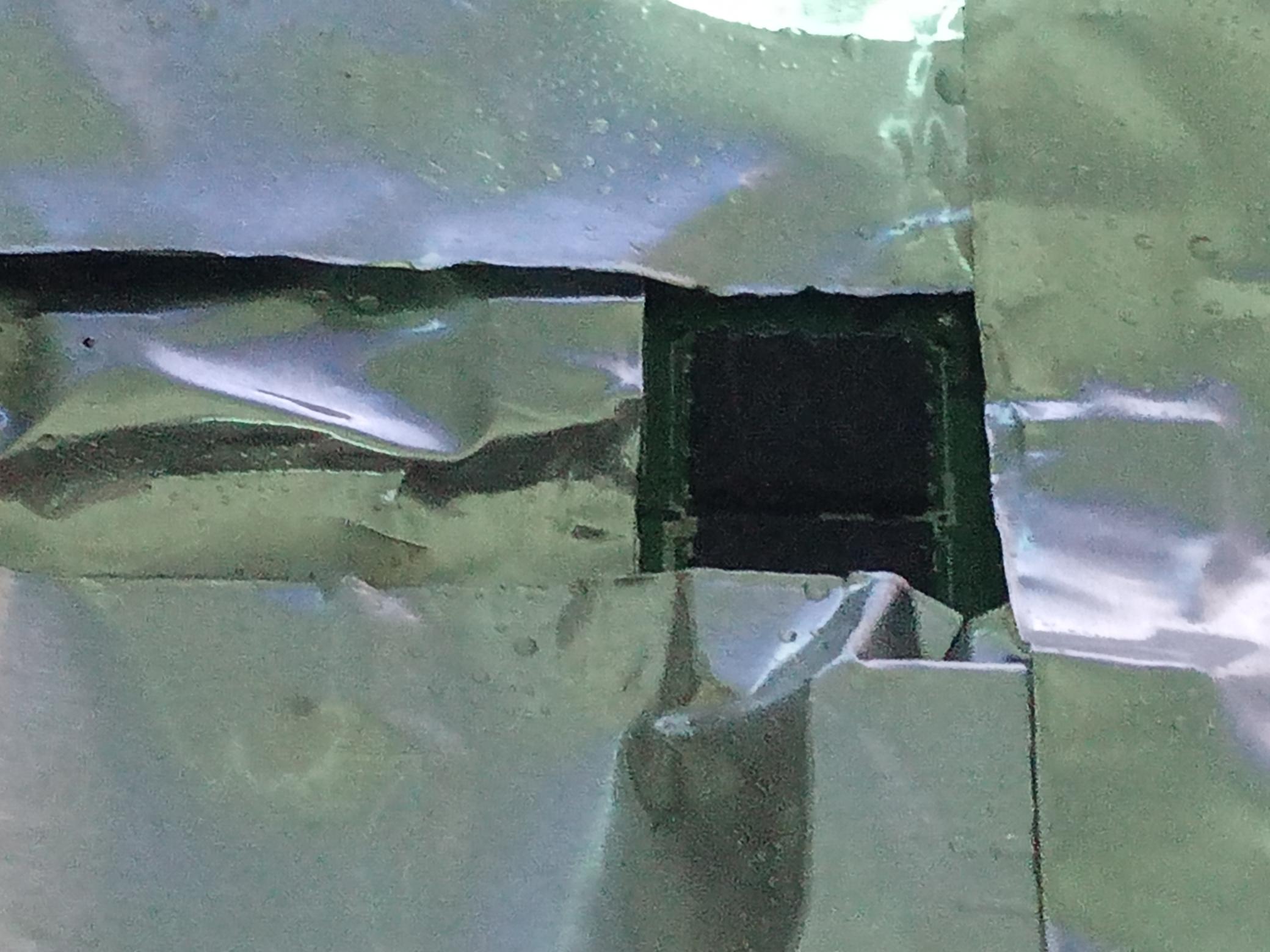

    Are some components spot-welded to the MBs?
    Because that's what it looks like. At first I followed advice from a poster here and went easy with 250ºC mid air, then lost my patience and went 500ºC full air. It refuses to come out! What is happening here?SOICs on this same MB are tough to desolder as well and I´ve only managed to remove them by adding solder blobs first. You can't do the same with this type of packages not to mention QFNs. Help

    I've thought of adding solder paste so it could reach the short pins and the pads beneath, but it's the same result. Maybe I have to dremel it out?

      use good flux, good air flow, good air temperature, and wait the required time to remove it.

        I think I'm using all of that and I've waited longer than necessary for the bloody solder to melt.

          Re: Are some components spot-welded to the MBs?
          are you using a pre heater ?

            No - they are all soldered. So most likely it is problems with your desoldering station. Which one do you have?
            I second what petewhitehall says - are you using a preheater? If not, then you really should be using one. Or at the very least get a powerful hot air station.
            So either
            1. Use a preheater, plus a cheap hot air station
            2. Use a good hot air station - I recommend the Quick 861DW (and previously I had one of the 858D so I know the difference first hand)
            Or preferably get a preheater plus a Quick 861DW - this combo will put far less stress on the PCB and components and desolder anything you are likely to find with no hassle

              Get a decent hot air station.

                No, I don't use a pre-heater. Never tried one. Isn´t that better suited for one-sided boards?
                Aren´t all hot air stations the same? I'm using a ProK DS101A - same as the 858D. It has served well. Until very recently.
                So I got your points and will do research.

                    250ºC is too low while 500ºC is too high. You need to find the sweet spot.
                    ~400ºC + lvl 7 air flow is enough for laptop and desktop boards most of the times but the ideal temperature depends on your location weather, air humidity, etc.
                    Also, the oxidation level of the board and components can influence the desoldering process.
                    The best way to find out the right temperature for your rework station+location weather combo is to test soldering on a scrap board. Never on a good one!!
                    Preheaters are indeed handy and necessary in some cases but not in this one.
                    Apply flux on the IC, pre-heat underneath the IC with the hot air gun for about 10s at a 5cm distance then flip the board and apply hot air on the IC at a 1cm distance. The solder will melt in about 20s~30s (time may vary depending on the variables previously mentioned).

                      250°C or 500°C doesn't mean anything with an 858D. Even with a decent hot air station exact temperature doesn't mean much, it depends on too many factor so you have to figure out the sweet spot yourself.
                      Which will also be very different between a cheap garbage 6 layers Compal board that can easily darken and popcorn with heat, and a 14 layers MacBook Pro board that'll sink all the heat in the power planes.
                      Only way to find out what works is practicing on worthless board.
                      Also no need to preheat under the board, just heat for a short while around the chip and then you can blast hot air on the chip directly.
