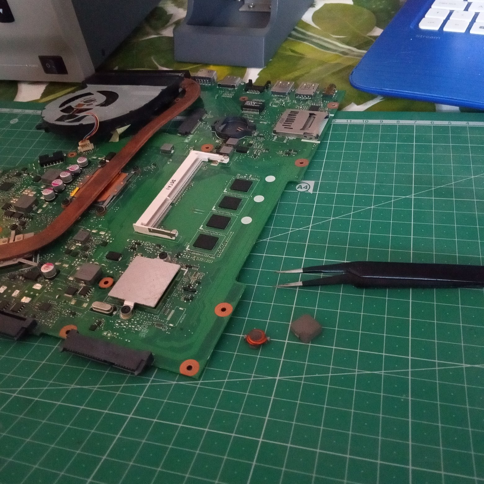

              That is what's left from the coil that the 858 couldn't remove. The "casing" which is actually all ferrite was eaten by the tweezers.
              With the 862 it took only 30 seconds. I´m amazed.
              Now, how do I get the nozzle off the handle? I think it's stuck!
                #47
                Re: Are some components spot-welded to the MBs?
                The mosfet in the ot took another 30 seconds, or less. This machine rules. I'm "blown" away. Sorry

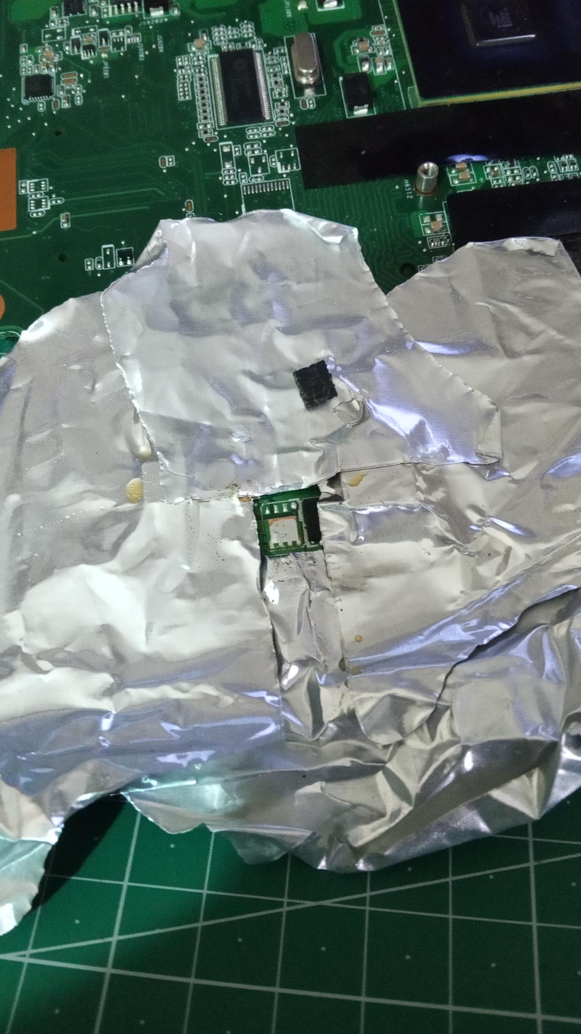

                  No components are ever spot welded in any motherboard. It can be done with RF shields, but you'll rarely find those in consumer electronics since it's easier to just use solder or bent tabs. I've only seen those in modules of old military equipment with large "Replace Card, Do Not Service" stickers, and in one HP oscilloscope.
                  Some manufacturers, depending on the application (specially in cars where there's lots of vibrations, or high amperage power supplies), they will glue components before soldering. You'll typically see it looking at any resistor or SMT capacitor, oozing out the sides. Typically a red or black glue:
                  What I think it's happening on your case, though, is that you're shielding the entire motherboard too well. You shouldn't unless there's a good reason to do so (i.e. nearby plastic connector, crystal oscillator, or electrolytic capacitor). The motherboard will soak all your heat and you could even burn off the solder mask, and maybe the solder you are trying to melt would still not reach enough temperature.
                  You need to uncover all that, apply 350º heat at 5cm (high fan speed) in large circles around what you want to remove for around 40-50 seconds. When the entire area is nice and toasty (100-140ºC) point your gun to the component you intend to pull (you can drop your fan speed to a medium setting).
                  Always remember that anything that is connected to the ground plane or a large copper pour for power delivery will be harder to remove.
                  TLDR: Unless you get yourself a preheater, you should preheat your board with the hot air gun itself before attempting to pull any component from it. Otherwise bad or very bad things will happen specially in boards with 4 or more layers. You could even delaminate the layers by applying a lot of heat in a small area, which would totally write off any vias in sight.

                    Note on the second picture the mosfet was replaced using the st862d and the shielding was still in place.
                    I've since done some rework without any shielding and I'll eat crow after insisting with another poster nearby pieces would fly off the board with the new station none has so far.
