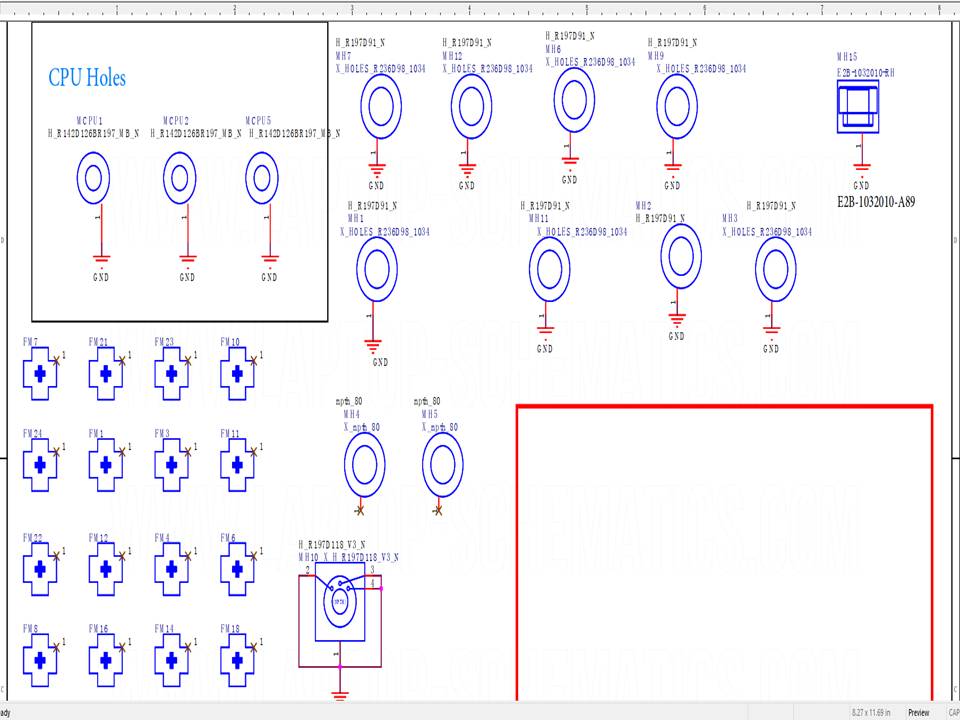

    I am in the process of fixing my laptop.
    I need some help to understand some symbols that are shown in schematic. I have attached a part of schematic doc here that sows them.
    The + Symbol (one that looks like a double plus - one inside the other), appears on MB. I believe that represents a particular +ve bus (since they are numbered as FM2, FM4 etc.), but I am not sure. Also, I am bit rusty on these symbols used - particularly on MB.
    The O symbol(a doughnut hole) also appears in schematic. I am find with the Ground/Earth presentation. But, the one where there is a small x at the end of line is a bit cryptic for me.
    The same small x also appears on the + symbols. I am not sure whether it means that they are not connected to anything (float by itself?).
    Will certainly help any guidance.

    This page on the schematic has no useful information to you if you plan to fix the laptop. Good starting point is here:

      What I want to know about + (hollow + symbol) is, is it used to indicate different + rails? There are identifying labels such as FM2 etc. Do these labels have any specific meaning or they change with the company?

        What is the platform name? The FMxx symbol should be represented on the schematic elsewhere if it had some importance in electrical meaning. You have the mainboard at hand, also i hope mutlimeter - so take measurements: are the + signs interconnected and what are they electrically connected to.
        My opinion is that they have no importance to you, maybe internally to mainboard manufacturer or some meaning in emc domain.

          This is MSI MB - MSI-16P51.
          On the MB, I do see the hollow + with a label such as FM2. But the exposed copper in the hollow + does not show continuity with other hollow + as much I have checked.
          It is possible that the hollow + is covered with a protective material after or during board etch process.
          There seems to be a short on 1.05 V bus near GPU and I am trying to find that. But I do not want to connect it to power (battery or Power pack) until I am reasonably sure that I have a location for short. Now for this, I need to know the supply rails (and there are many) including the 18V that is used to provide large current loads through local power management parts for GPU, CPU, Memory etc.

            FM* are fiducial marks used during production for the calibration of the assembly line.

              Thank you for providing that insight. That could be another case.
