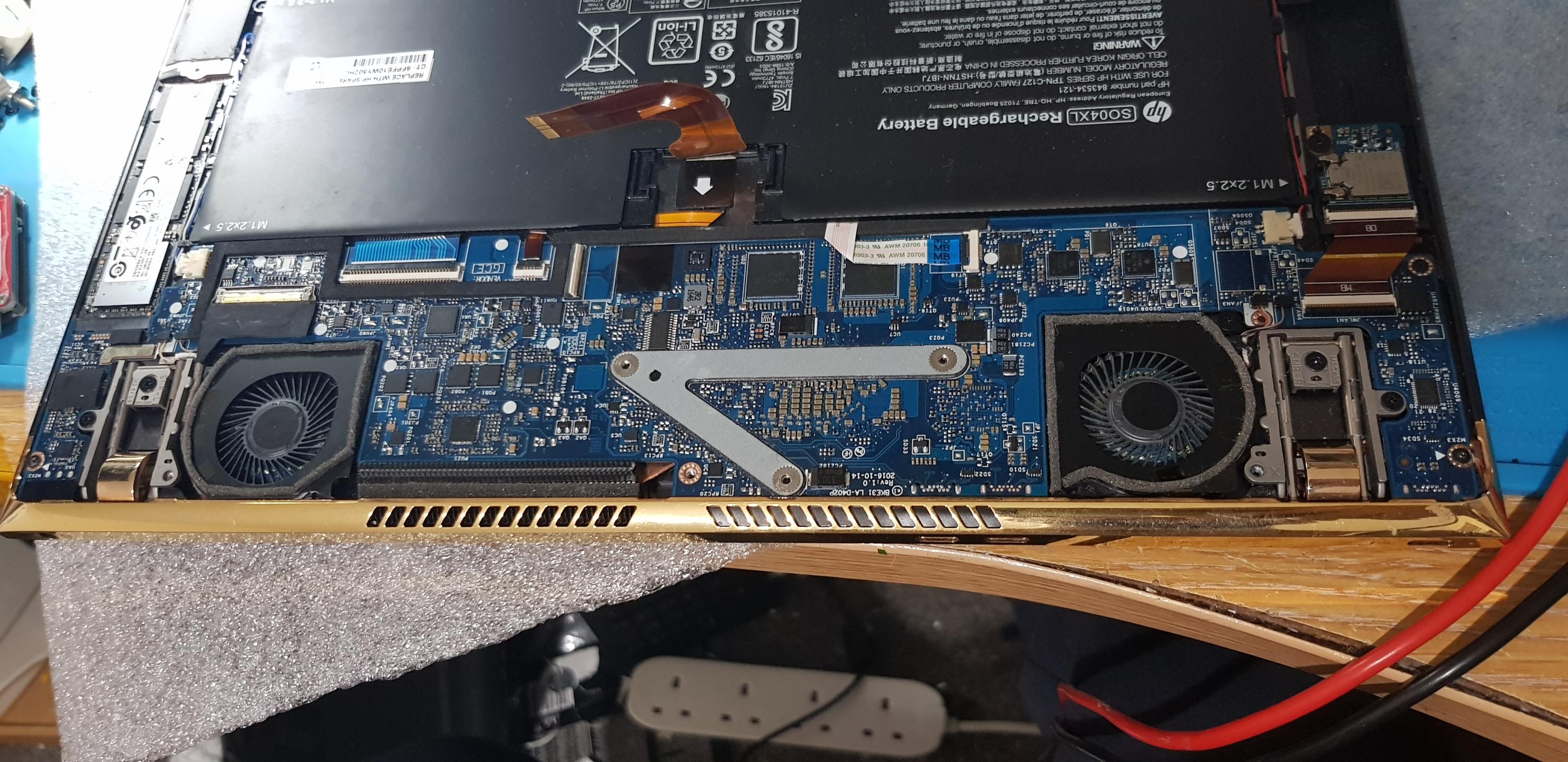

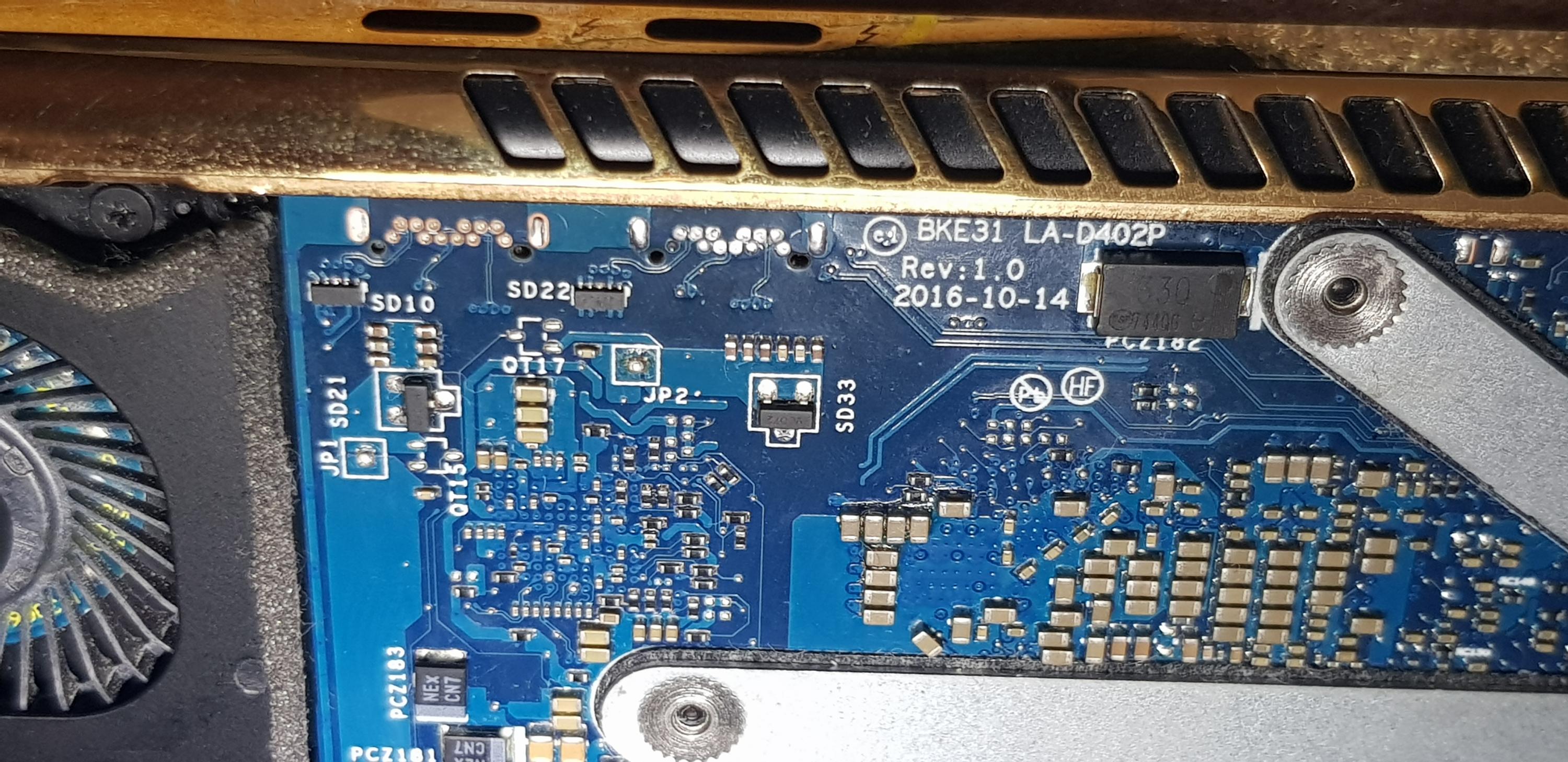

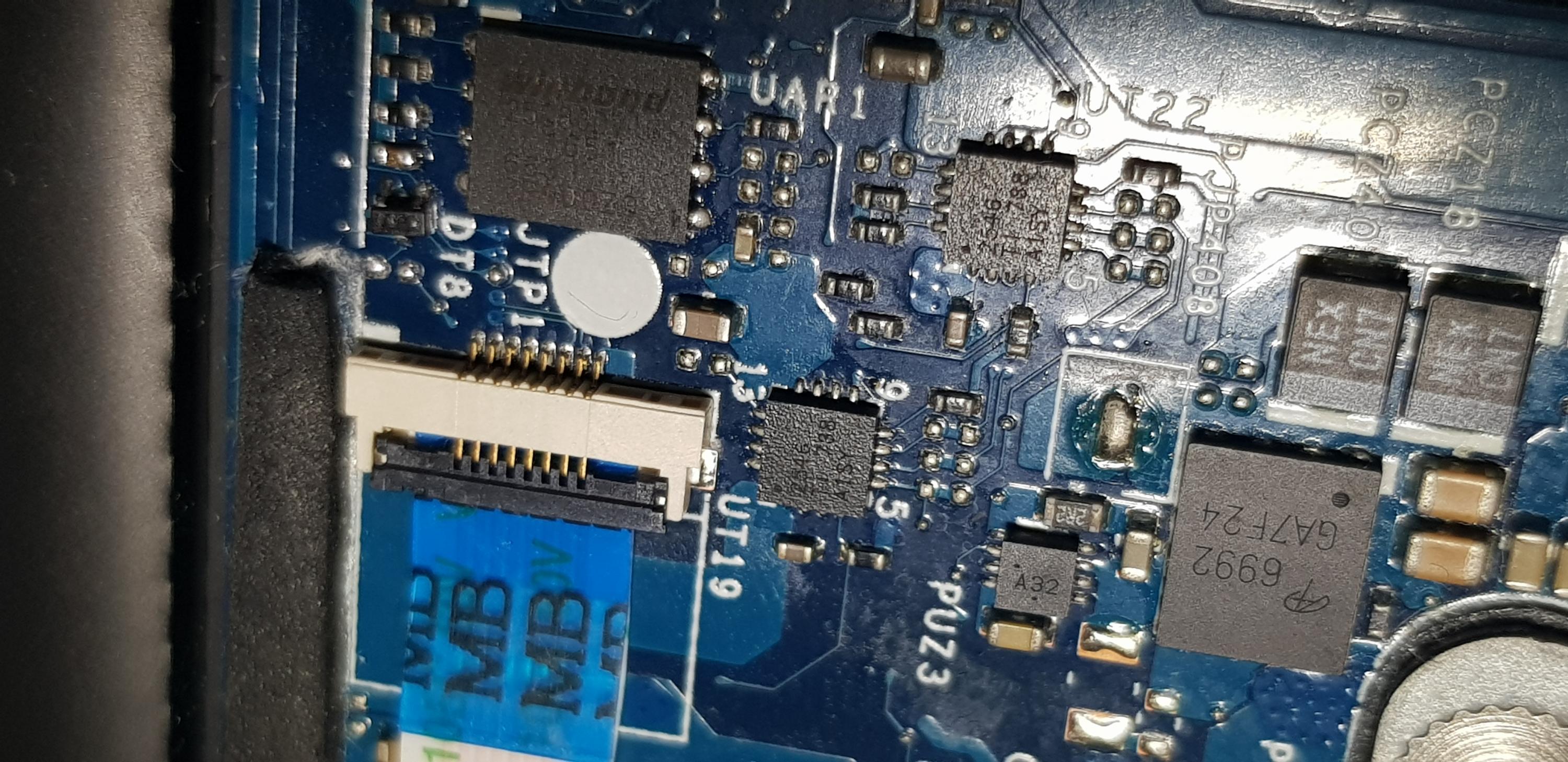

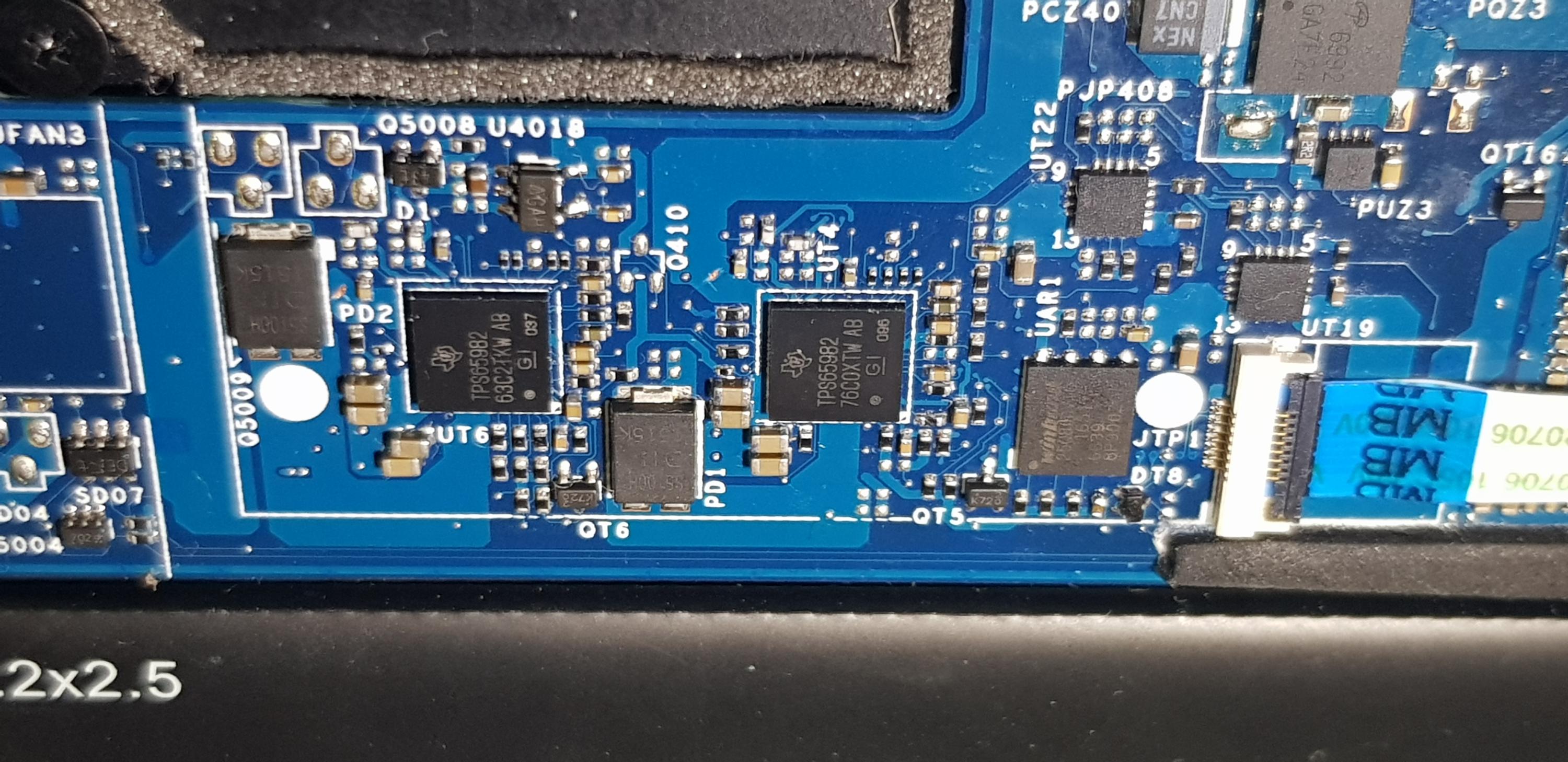

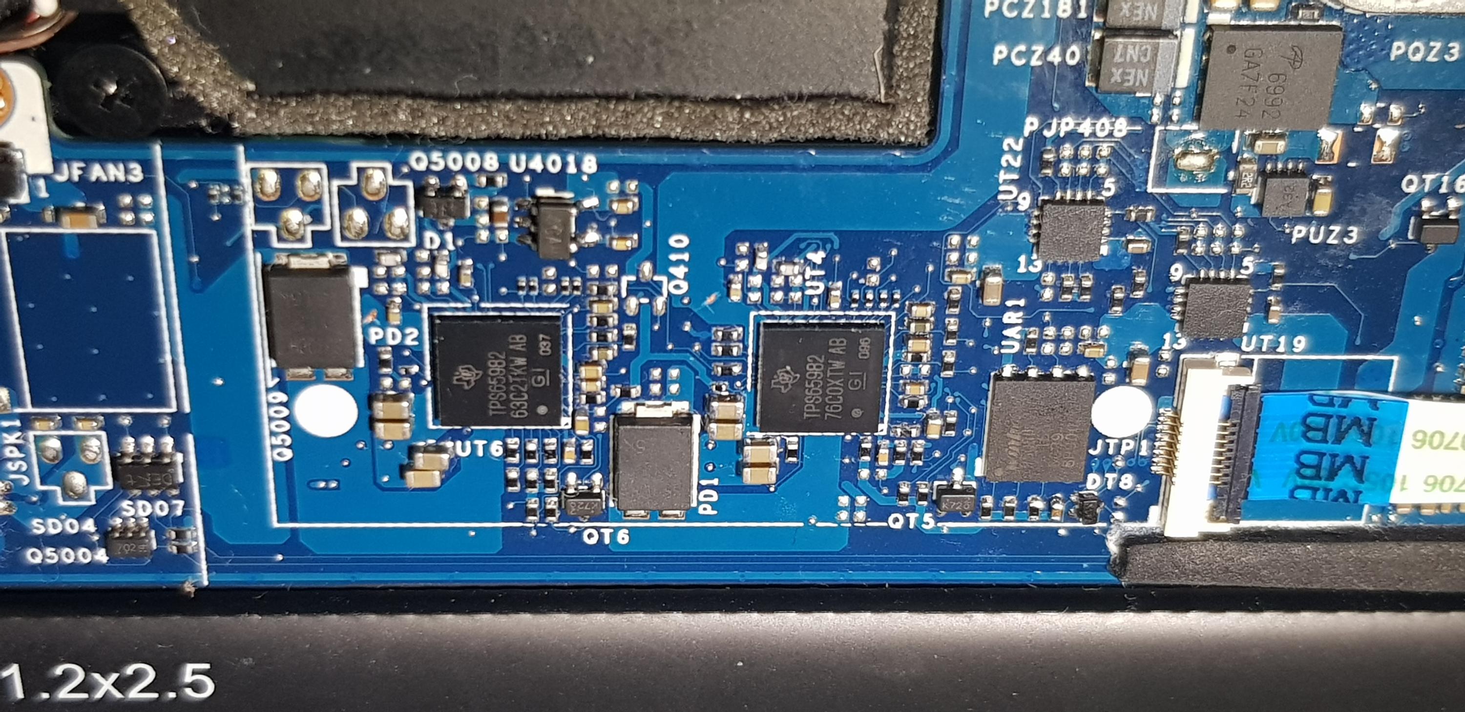

                      Re: Hp spectre 13. Charging issue. Very confusing!
                      These are some photos for the board

                          TPS65982 responsible for detecting USB-C plug orientation and switch internally according to the plug. Also I suspect that power line on this laptop similar to another spectre and looking at its schematic, one TS65*(let's say A) is kinda controlling another TS (B) even when USB-C plug is not connected to A.
                          P.S. I have one spectre right now where both ICs don't talk to power supply to get 19v but there is no short. I ordered them from China and will replace. Something tells me that the board will power on after that. The board works fine from the battery.
