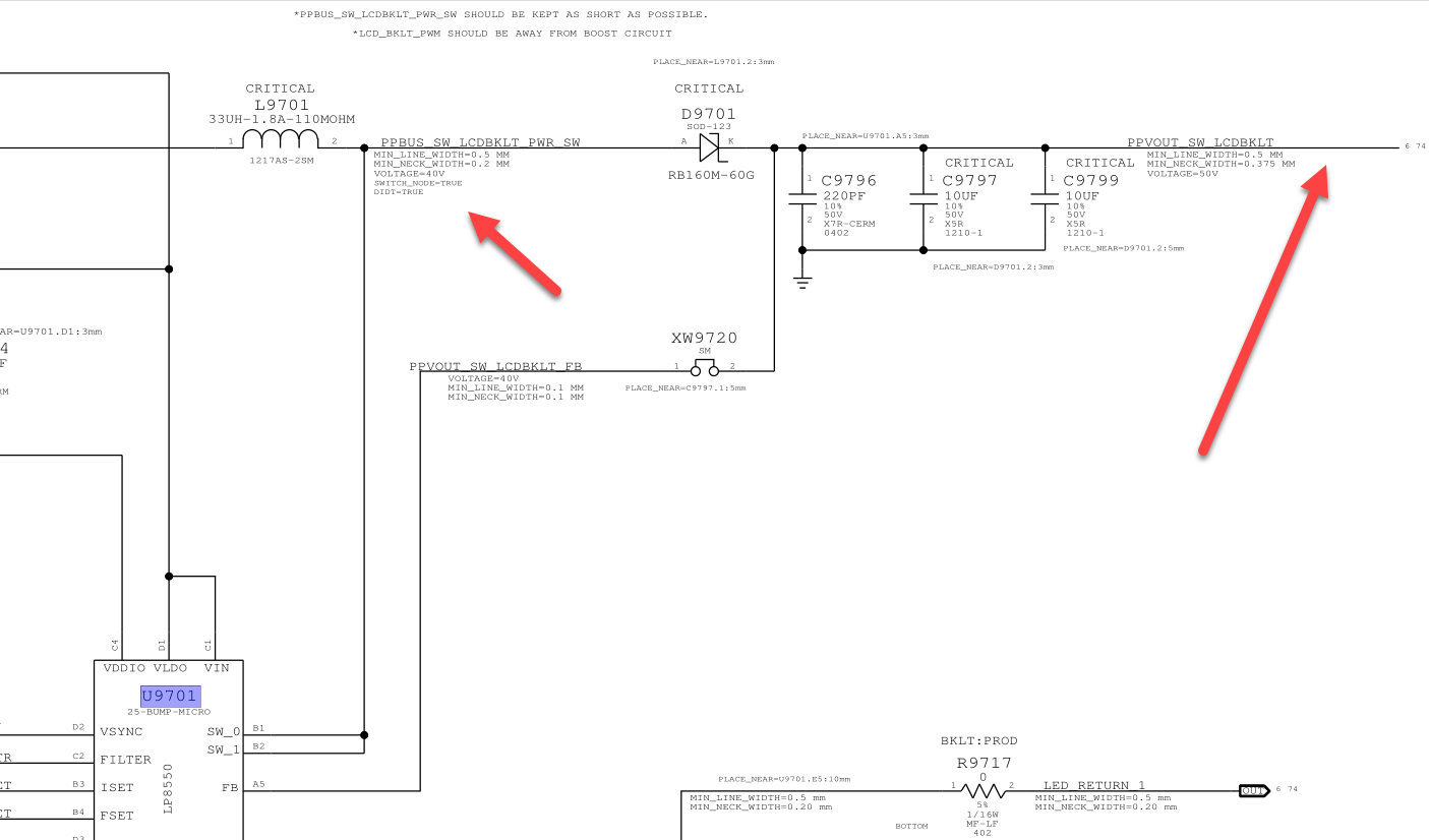

                                Leave the LVDS cable off and check the backlight voltage levels @ U9701.
                                See the attached test points. What are the readings for these areas?

                                  Friends they really say never give up .lol Finally have success. I saw your post about the Pram reset and LVDS Cable a little late.But i had already remove the bios ...took a backup and do a Cleaned Me Region on it.I powered back on again and now it works and i have picture. Guess the bios got corrupted at some point. Thanks to everyone in here for the guidance, help and tips .It was a nice learning experience for me.Will check for stability and everything as the day progress...but all the long hours on this finally paid off.Thanks a million mon2 as well.You know your stuff.Will keep in touch on the Thermal Camera.
