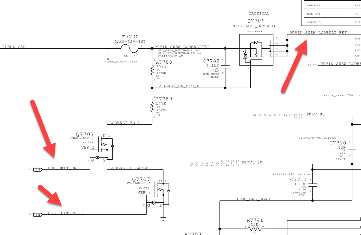

              • mon2
                • Dec 2019
                • 13940
                Re: Macbook Air 2015 no backlight
                What are the values for the attached sections of the backlight circuit?
                  Hi!!!!
                  My PPVIN S0SW LCDBKLT FET line shows 8.5v....
                  I have not measured EDP BKLT EN neither BKLT PLT BST L, because if I get those 8.5V, the mosfets work correctly and it seems that I get no boost which should be LP8550 fault.....
                  • mon2
                    • Dec 2019
                    • 13940
                    #29
                    What are the readings on the left side of the mosfet?
                    According to the schematic, should be about 12v.

                      #30
                      Never trust voltage indications in schematics.
                      • mon2
                        • Dec 2019
                        • 13940
                        #31
                        This voltage is important.
                        What are voltages on Q7706,
                        Pin 3 ?
                        Pin 4 ?
                        The left side is PPBUS_G3H. If 8v6, that is too low.
                        Believe to have the same logic board at the office.
                        Will confirm the same asap.
