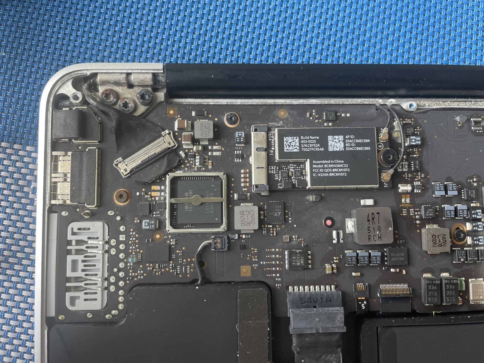

    Hello everyone.
    I am trying to repair a friend's macbook air.
    The initial problems were that there was nothing on the display.
    The board was water damaged.
    After disassembly, I noticed that the fuse was still ok but there was a burned capacitor.
    After cleaning the entire board with IPA and replacing the capacitor (L8304 on schematics), I now have the picture without backlight.
    The macbook boots and everything works, except for the backlight

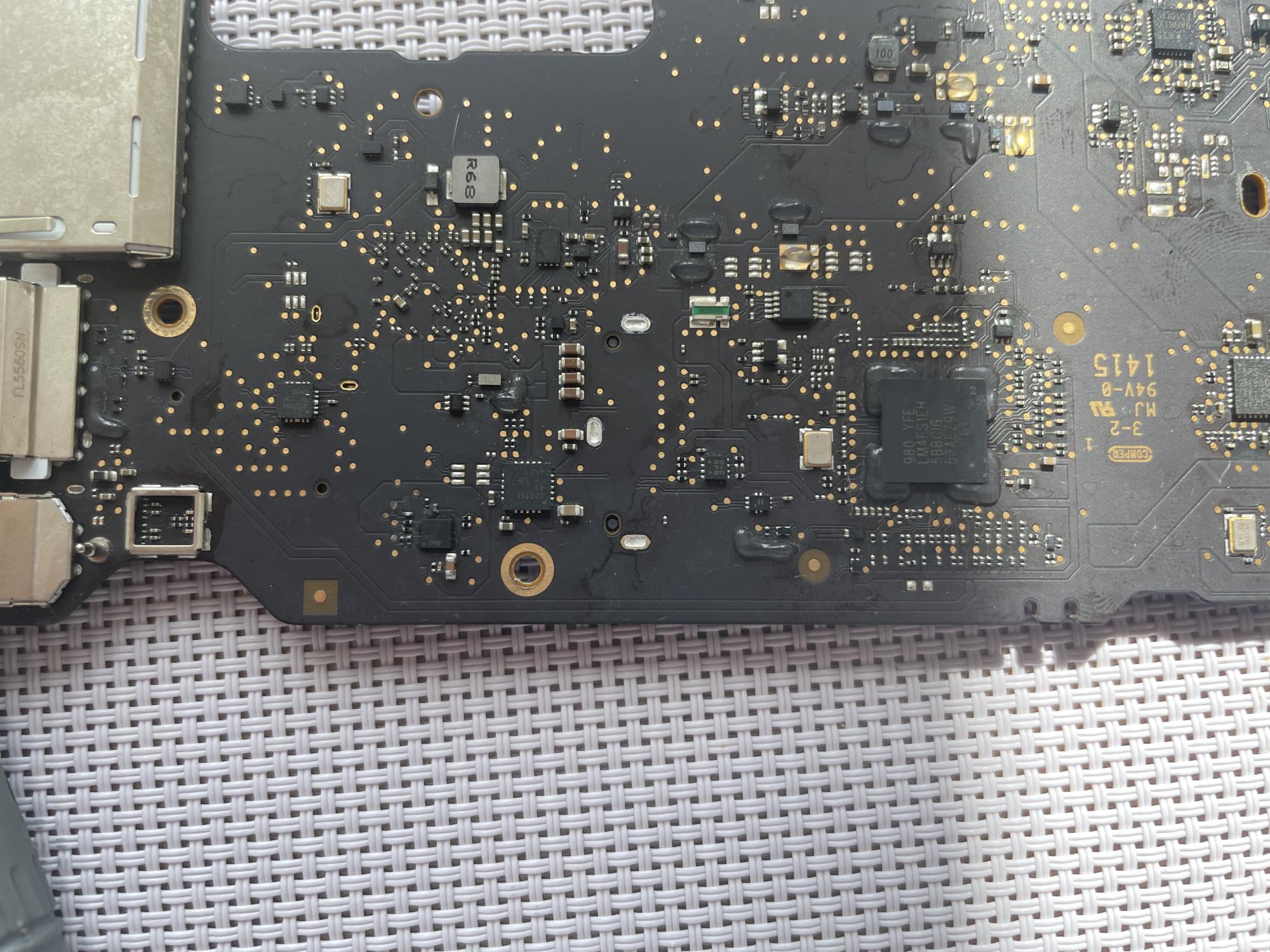

    There was considerable water damage around the u7701 chip
    I haven't repaired macbooks before, but after watching some videos and reading a few articles, I tested for voltage between L7701 and ground. I got 0.0v
    I also tested for PPBUS_G3H and found 8.58v
    I honestly don't know what to do.
    Also, I found c7711 looked a bit black, so I tested it and it was shorting to ground on both sides
    After removing, the short went away on one of the sides
    But still no backlight
    I put the capacitor back on as I was unsure if it was the issue
    That is now shorting again
    Could anyone help me or guide me on what I need to probe/replace?
    Many thanks.

    Depends where the water got to. Check the LCD connector J8300 closely for burning around the backlight pins 3/4 (on the LCD cable itself and the board connector). Usually I have to change out this connector along with U7701. BTW, check that the backlight pins aren't shorted when the LCD connector is plugged in, had one recently where the connector had also burned internally IN the screen assembly itself. F7700 would be open circuit if that is the case.
    If you had liquid damage around U7701, that's an automatic replacement as you get burning etc around pin 5. Note if you are working on the board on the bench, backlight won't be enabled without a display actually connected. You should at least see 8.6V on C7797 if F7700 is ok and display is connected. If that is the case, then U7701 is stuffed as it should be boosted to 25V.

      The connector J8300 looked fine, no burns and the screen ribbon cable connector looked fine, no burns
      There was no shorts between the pins and f7700 is working fine (I have continuity)
      I'm going to order a u7701 chip and attempt to solder it on (first time doing bga).
      What do you recommend for the other cap that I removed them put back on?

        Remove all power -> check the resistance across C7711. If the resistance is low, the part is shorted and should not be used.

          If it's your first time doing BGA, then order 5 as they're relatively cheap. Very common fault on A1466 and easy to fix. Once the chip is off, check the pads for damage (pins 5, 11, 16 most common as these pull the most current). In some cases I've had to run jumpers as the pad is often wiped out.
          That cap is across PP5V_S0, so I'm surprised it boots if that line is shorted. Normally liquid damage in this area the IC comes off, and any components where the end caps discoloured/black get removed and swapped with those off a donor. Don't bother reballing a donor IC.

              Tested a few things, found stable 3.30v to pin 2 of q7706
              With regards to c7797, when the laptop is turned on, the voltage slowly increases until it gets to 1.55v, then slowly decreases back to 0v
              What does this mean?

                  If the backlight is enabled, you should have 8.6V on the output of Q7706 so 1.5V is too low. It gets boosted to 25V via L7701/D7701/IC7701.

                    I received the u7701 chip today, and I'm going to attempt to replace it over the next few days (when I have time)
                    Because I've never done BGA chips before and this chip is tiny, can anyone give any tips.
                    • reformatt
                      • Feb 2020
                      • 1668
                      Re: Macbook Air Early 2015 820-00165 No Backlight
                      You need to work out first what temperature and air flow works best for your hot air station. This varies from board to board, your station, and the nozzle you use. This is something that takes a bit of practice, so it's best to work on some donor boards first. These boards require a lot more heat than the newer T1/T2/Mx boards as they are much thicker.
                      For this BGA, I pre-heat the board first with hot air for about 20 secs. Apply a small dab of no-clean flux on the pads, then line up the chip (correctly orientated) in the approx right position relative to the pads, and hold with tweezers. Apply a small burst of heat to get it to 'stick' into place. Release tweezers (chip should stay in place), then apply your heat proper. Solder should melt and pull the chip onto the pads. Once it moves, you give it a slight nudge to see if it pulls back into position.

                              I’m in the process of replacing the u7701 chip
                              Just wanted to let everyone know, after removing the chip, I now have over 8 volts on l7701
                              I’m going to try and put the new chip on now
                              Wish me luck!
                              • Constantinos
                                • Jul 2023
                                • 13
                                So, replacing the chip was a success!
                                The laptop backlight now works perfectly.
