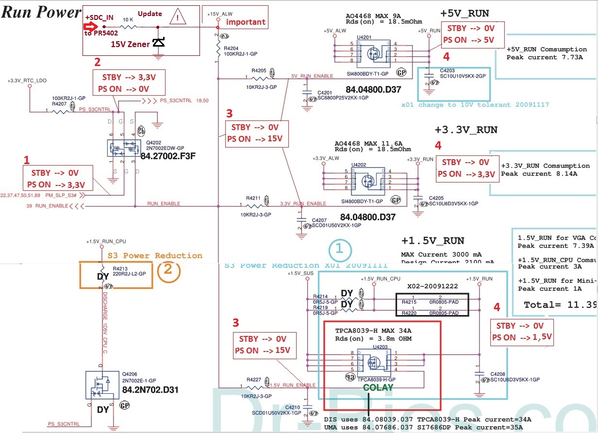

    hi
    dell n5010 power on without 3.3v ,5v run
    u4201
    D +5V_ALW 5V OK
    S +5V_RUN 1.5V
    G 3V
    U 4202
    D +3V_ALW 3V OK
    S +3V_RUN 1.2V
    G 3V
    i think problem in PS_S3CNTRL
    because r4207 pin1 3.36v ok but pin2 0v
    q4202 pin2 3.3v ok
    pin3 3v
    pin5,6 0v
    i change q4202
    and pq5003 and q1801
    help please

    U4201 simple n channel mosfet
    RDS 18.5 mohm
    If you look at schematic unless there is high voltage at gate required to switch on and generate 5vrun with fixed current peak
    C203 status ,check RDS for u4201, c4201 status
    5v run enable is not coming higher at gate u4201
    3.3V_RUN_ENABLE also not coming sufficient at ,u4202
    Hmm nice observations r4207 check ohms increase or not

            Let's start measuring signal levels
            Vgs must be high for n channel mosfet u4201
            What is voltage on r4204 both side
            C4201 voltage at pin 1
            R4205 voltage on both sides
            It should be +15v always
            Slp_s3#
            1.5vsus available?
            +V_DDR_REF(0.9V) available?

              r4204 pin1 3.14v
              pin2 14.51v
              c4201 pin 1 3.14
              r4205 both sides 3.14v
              slp_s3# on q4202 pin2 3.3v
              1.5vsus on pl5001 1.5v
              +V_DDR_REF pu5001 pin5 .75v
              thanks

                When power button not pressed
                you will have 0 voltage at q4202 gate pin 2 and left side mosfet will remain off and you have 3v at pin 5,6
                and pin 5 is gate of right side mosfet so
                at pin 5 3v turn on right mosfet and 0v reach at gates of u4201 u4202 u4203
                When power button pressed
                3.3v at q4202 at gate pin 2 of left side mosfet
                Mosfet turn on left side one
                0v reach at pin 5,6
                Pin 5 is gate of right side mosfet
                Which turn off right side mosfet
                Now 15v always comes as run enable for u4201, u,4202 and etc
                15v at gate of u4201 needed for 5v run
                Before power button pressed
                You should have 0v at gate of u4201
                After power button pressed
                You have 15 v always
                Problem: you have 3v at gate of u4201

                    15v is important, if you don't have 15v, +5V_RUN +3,3 V and others will not come out. PU4601 RT8206 voltage regulator may be defective. if you can't find it, the update in the figure can be applied.

                      Thanks for your response. +15V is present and i do understand the working principle of Q4202. Pin2 Gate is ok when powered on there is 3.3V, so logically speaking ground should reach pin6. PIn5-6 are connected together, so GND reaches pin5 making 2nd mosfet of Q4202 off-so GND from pin4 should'nt travel to pin3 and there should be 15V approx at pin3 which in turn will enable VS line transfer. AS far as theory is concerned, that's correct but despite all the correct working conditions of Q4202, i'm still getting 3V at pin3 which is wrong.
                      Q4202 replaced but in vain. R4207/R4204/r4205/C4201/R4211/C4207/R4227/C4210 are checked and are good as per schematic.
                      U4201/4202/4203 are good and checked fine as per schematic.
                      Does anyone else can tell me the way forward??

                        So you have 0V on pin 5 of Q4202?
                        And on one side of R4204 you get 15V on the other 3V?
                        Try removing R4227, R4211 and R4205 to see if something after them is pulling RUN_ENABLE low (just shift them off of one pad). If it's still low you can try removing Q3905 and Q4202 and check again if RUN_ENABLE is low.

                          @piernov, yes your observation is right. I already tried removing Q4202/Q3905 before responding here. I've not tried removing the resistors R4205/4211/4227. Will do and update the forum.

                            Thanks @piernov. Problem solved. 1.5V SUS was pulling down the run voltage.
