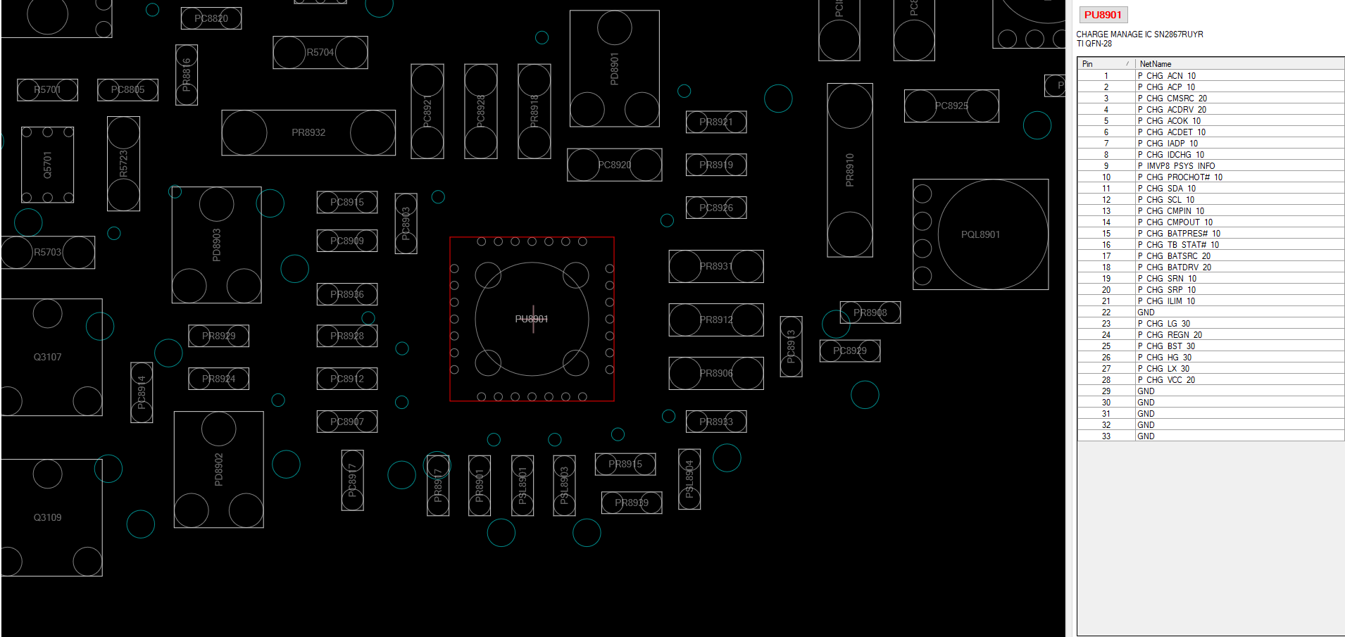

          Edit: i have attached the Boardview. Hopefully it will Help a Bit.

            Re: ASUS UX510U won't Charge after Charging IC Replacement.
            Can you share schematic
            I am outside using mobile phone 📱
            Is there any version for mobile ,boardview
              I am outside using mobile phone ��
              Sorry, afaik No schematic available and i was even not able to Open it with Android boardviewer. There is a repair Guide, but i Would say nothing helpful inside for this Case.
              Anyway No need to hurry. This repair already lasts sooo Long. So i'll be Happy If you or Someone Else Take a Look soon.

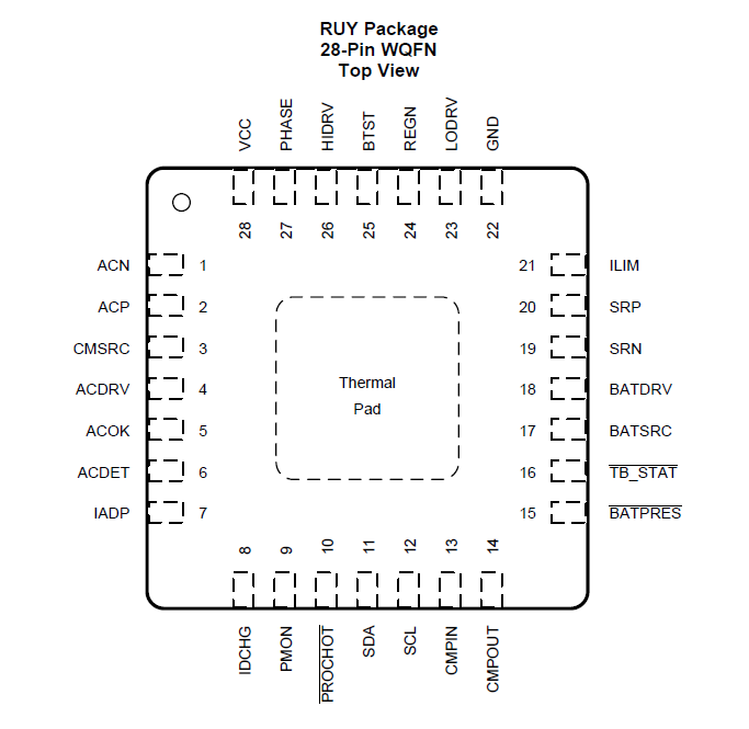

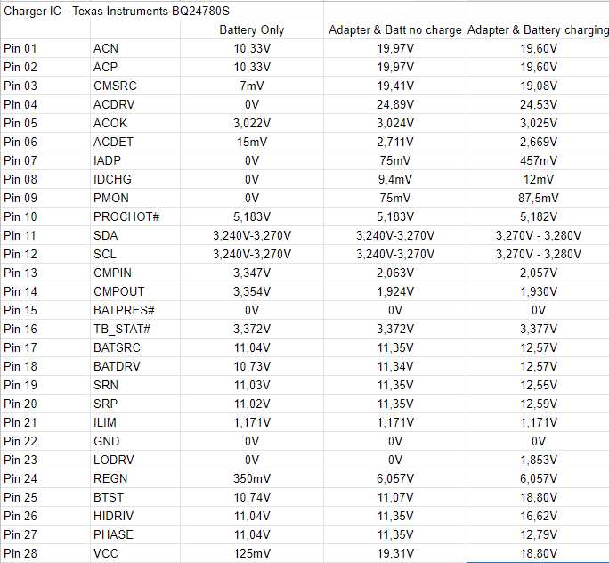

                Good evening,
                i have a datasheet and some measurements for you. I hope something obvious here.

                Charger IC - Texas Instruments BQ24780S
                Voltages with Adapter only // with Adapter & Battery
                Pin 01 - ACN: 19,94V // 19,94V
                Pin 02 - ACP: 19,94V // 19,94V
                Pin 03 - CMSRC: 19,38V // 19,37V
                Pin 04 - ACDRV: 24,94V // 24,88V
                Pin 05 - ACOK: 3,027V // 3,026V
                Pin 06 - ACDET: 2,705V // 2,705V
                Pin 07 - IADP: 129mV // 128mV (194 KiloOhms to GND)
                Pin 08 - IDCHG: 11mV // 11mV (191 KiloOhms to GND)
                Pin 09 - PMON: 126mV // 126mV (10 KiloOhms to GND)
                Pin 10 - PROCHOT: 5,184V // 5,187
                Pin 11 - SDA: 3,264V // jumping beetween 3,23 and 3,26V
                Pin 12 - SCL: 3,273V // jumping beetween 3,23 and 3,27V
                Pin 13 - CMPIN: 2,071V // 2,089V
                Pin 14 - CMPOUT: 1,960V // 1,970V
                Pin 15 - BATPRES: 0,5mV // 0,4mV (9,9 KiloOhms to GND)
                Pin 16 - TB_STAT: 3,373V // 3,373V
                Pin 17 - BATSRC: 12,65V // 11,58V
                Pin 18 - BATDRV: 12,63V // 11,57V
                Pin 19 - SRN: 12,64V // 11,58V
                Pin 20 - SRP: 12,64V // 11,58V
                Pin 21 - ILIM: 1,172V // 1,171V
                Pin 22 - GND: GND // GND
                Pin 23 - LODRV: 46,7mV // 0,1mV (209 KiloOhms to GND)
                Pin 24 - REGN: 6,057V // 6,062V
                Pin 25 - BTST: 17,49V // 11,30V
                Pin 26 - HIDRV: 12,84V // 11,58V
                Pin 27 - PHASE: 12,66V // 11,58V
                Pin 28 - VCC 19,17V // 19,27V
                Checked all resistors around the IC and all seems okay except PR8919 with 69 KiloOhms instead of 100 KiloOhms and PR8921 with 80 KiloOhms instead of 180 KiloOhms. No Cap short to ground.
                  Pin 01 - ACN: 19,94V // 19,94V. _ok
                  Pin 02 - ACP: 19,94V // 19,94V. -ok
                  Pin 03 - CMSRC: 19,38V // 19,37V. _ok
                  Pin 04 - ACDRV: 24,94V // 24,88V -ok
                  Pin 05 - ACOK: 3,027V // 3,026V. -ok
                  Pin 06 - ACDET: 2,705V // 2,705V. -seems ok check voltage divider
                  Pin 07 - IADP: 129mV // 128mV (194 KiloOhms to GND). Not ok
                  Not ok
                  Not normal
                  Prochat is active on low so ok
                  Data signal need DSO but value ok
                  clock signal need DSO but value ok
                  Pin13 cMPIN: 2,071V // 2,089V ok
                  Pin 14 - CMPOUT: 1,960V // 1,970V ok
                  Problem when battery not plugin it should go high
                  You plug or not it is same which is an issue
                  Problem
                  active on low,
                  high means boost mode is off
                  Batdrv is shorted to batdrv , batdrv should be 6v above batsrc to turn on power via battery
                  Problem
                  Vilm= 20 multiple (vsrp-vsrn)
                  Check voltage divider resistor resistance
                  Pin 24 - REGN: 6,057V // 6,062V ok
                  Pin 25 - BTST: 17,49V // 11,30V ok
                  Pin 26 - HIDRV: 12,84V // 11,58V ok
                  Pin 27 - PHASE: 12,66V // 11,58V need DSO
                  Pin 28 - VCC 19,17V // 19,27V ok
                  Check page 19 pin 10 prochat is active on low
                  You plug or not plug , nchannel mosfet is off means battery is present all the time
                  It should go down when battery removed
                  Batpress active on low, it is also not changing
                  If those high value resistor are connected to charging ic
                  Replace them and check
                  Need DSO for frequency check phase pin

                                      Good evening,
                                      now i have the time, to do the measurements. But Before, i have to tell something what i've found out and had already done:
                                      I found out, i can reproduce the following to get the Laptop charge:
                                      a) Unplug all, Plug the adapter first (Laptops does autostart) and the Battery after. It charges the battery
                                      b) Let the Battery completely discharge, till i'm not able to power it on one more time. Press the Power Button for 60 seconds. Plug the Adapter after (The Laptop does autostart). It charges the battery.
                                      Additionally i flashed the bios with cleaned ME, just to be sure. But nothing of the behaviour changed.
                                      So here are the values...
                                      So where are the obvious differences?
                                      1. The overall voltage dropped a little bit. Could be normal, because it is charging the battery right now.
                                      2. I have different voltages on the Gates for the charging mosfets
                                      3. The readings from SDA/SCL are much more stable.
                                      4. in my opinion are the readings from IADP, IDCHG, PMON and BTST conspicuous
                                      Any idea? TY in advance! =)
                                        You just found the solution
                                        I hope I am right
                                        Vcc should be same as battery voltage when with battery only
                                        All voltages are ok , your charging ic working but
                                        Two points to check
                                        First external
                                        Second internal
                                        External check. ,. In battery mode only voltage is passing from battery to the CLR side from blocking mosfet or third mosfet in DC in line
                                        Because In battery mode vcc of charging ic is battery voltage for functioning of laptop obviously not charging function lol
                                        Vcc is missing
                                        Secondly when no adapter plugin third mosfet if n channel at CLR side should have battery voltage
                                        At SDA and scl battery connector there are 100 ohm resistor attached to these , check there resistance value should be 100ohm fixed , if DSO available you can check signal
                                        First confirm this then we look at low drive drive zero
