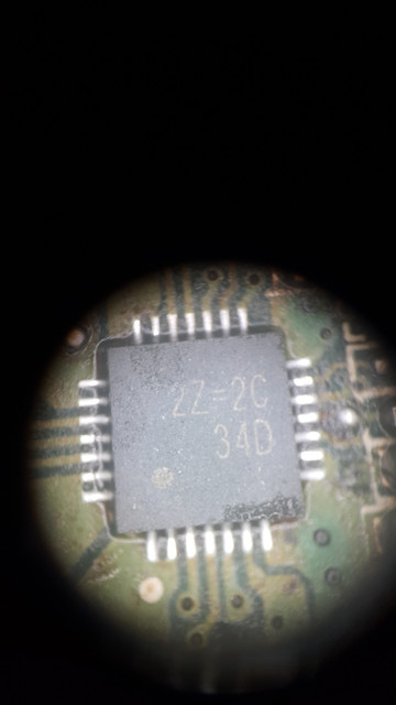

    Hi thiis is a part of a DAZHKDMB6E0 REV E MB i dont have any schematic though , if someone can help me..
    Thanks to someone can help me

    because Im getting short form PIN1
    • petehall347
      • Jan 2015
      • 4448
      • United Kingdom
      Re: Please Help Me Identify This IC?
      short to ground is it ?
      • kalilinux25
        • Mar 2018
        • 2093
        • ZAMBOANGA SIBUGAY
        yes

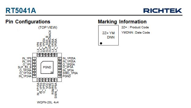

          • 22084
          See post number 2 in the "IC Marking Codes and Datasheets" sticky thread, the IC is a Richtek
          The quanta zhkd schematic is freely available it only takes a quick google search

            I'm not sure if its a SOT-23-6

              rt5041agqw is this right sir?
                • 22084
                Yes thats the right one
                https://www.datasheets.com/en/datash...ation-63421895
