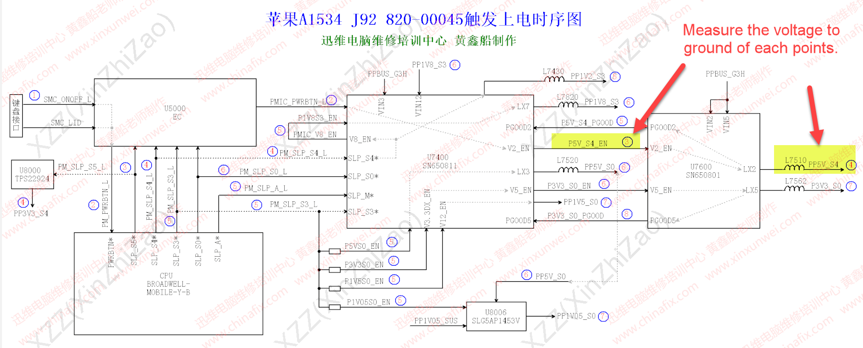

          What is the 820-**** number of your logic board? Is it 820-00045 or 820-00244 ?

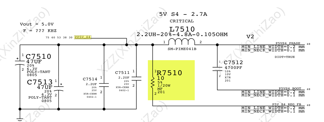

          See attached. This rail is enabled by the signal P5V_S4_EN. Check its voltage to ground to see if it is cycling or not. Note that PP5V_S4 may be fluctuating if it believes there is an excessive load on this rail. Your resistance to ground is OK and is not a short BUT the current sense circuit could be providing for the incorrect current or FB measurements. For this reason, remove all power -> meter in the lowest resistance scale -> measure the resistance of the current sense path or FB voltage leg. One meter lead @ L7510, pin # 1 and other meter lead @ R7510, pin # 2 - to confirm that the FB resistor @ R7510 is of the correct value and is not defective.
          P5V_S4_EN will be difficult to probe since this signal STARTS under a BGA and ends under a BGA. Review the resistance of R7510 first.
          Update - sorry - meant R7510 = should be 10 ohms and is the FB resistor.

              Ok - we are referencing the same schematic. Personally this is one of the boards I hate as the parts are incredibly small. Ironically, we are shifting to build products using 0201 with our machinery but it is different when you have the joy to service a finished product with such tiny parts. Hope your eyes are better than mine or at least have a good microscope.

                L7510 pin 1 to R7510 in2 10ohms
                PP5V_S4_EN 0.2mv
                • mon2
                  • Dec 2019
                  • 14659
                  Great. Carefully check if this enable pin (P5V_S4_EN) with the power adapter connected is pulsing or not. Measure the voltage to ground of the same test point that you have found.
                  • Der Schwede
                    • Sep 2022
                    • 21
                    • Sweden
                    No, not fluktuating but only 0,2mv
                    Is that mean that i have a problem in u7400? I Have an sparearts board due i bought 2 same A1534 with about same issue. But i dont know if the u7400 chip is good from the another board.. And i dont have bga balling equippment, so i hope its not an issue with the u7400 chip.
                    • mon2
                      • Dec 2019
                      • 14659
                      Not at my desk but this is an active high enable pin. If a logic ‘1’ then the mentioned missing power rail will enable. On this note, the missing power rail should be 0 volts or very close to it and not turning on / off. Since the enable is a logic ‘0’, this local power rail should be off.
                      wait on other comments but the fault may be a corrupt bios. Bios reflashing may be required but do check if the bios has a voltage that is stable to boot the board. Would you have flash programming tools? You must back up the current flash first. Check its power rails and also the Spi lines for a voltage.
