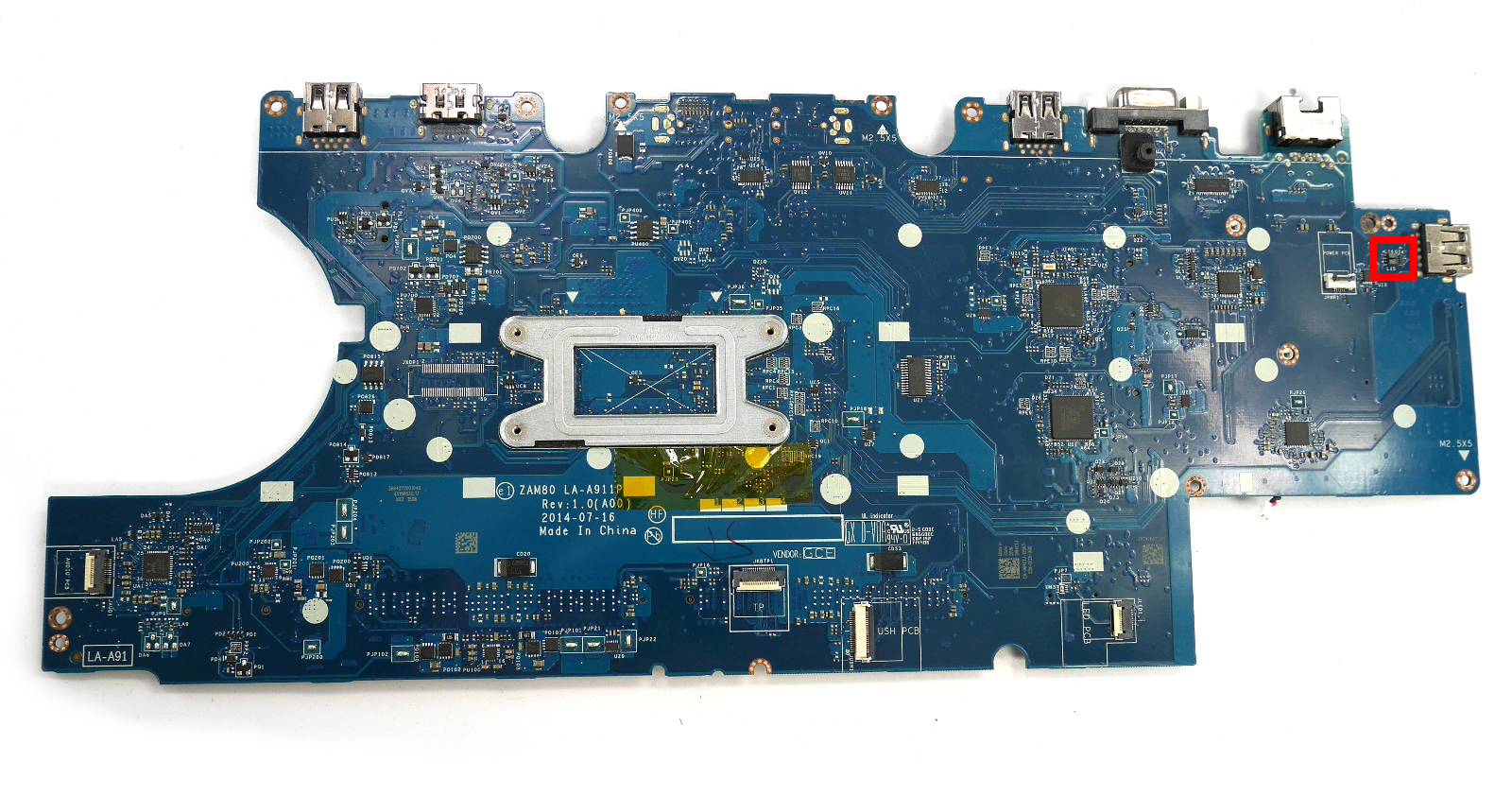

    I have a Dell Latitude E5550. I don't know the history of the PC. The battery is missing. BTW I am not too sure the laptop will boot at all with mains but without a battery. Can someone confirm this laptop can boot without a battery attached?
    At the moment, here is the behavior:
    If I plug the charger and I have a USB led lamp plugged in, the lamp turns on steady (Happens with only one USB port out of 3). When I press the power button, nothing happens. USB lamp stays on, but nothing happens.
    If I unplug the CMOS 3V battery, the lamp in the USB port will turn on for a split second then off. Just then the power button LED will turn on for a split second. Then off. If I press the power button, the power button light will turn on for two seconds then off.
    Any idea? Short in the motherboard? Bad CMOS battery? Bad BIOS?

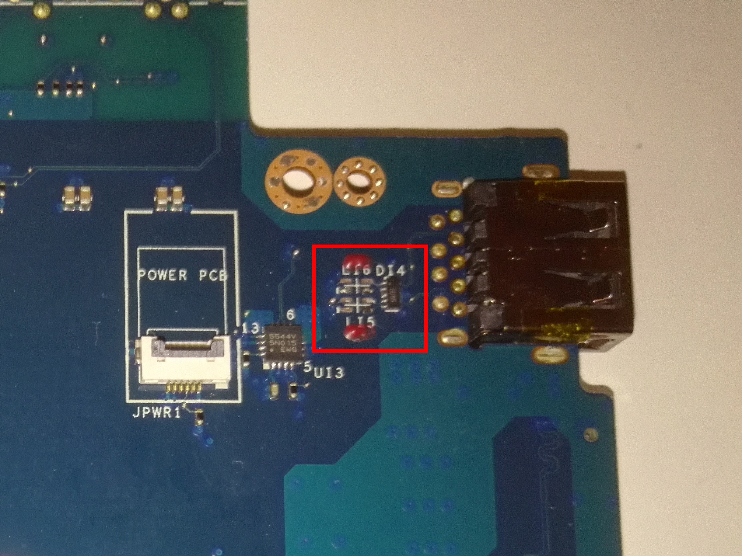

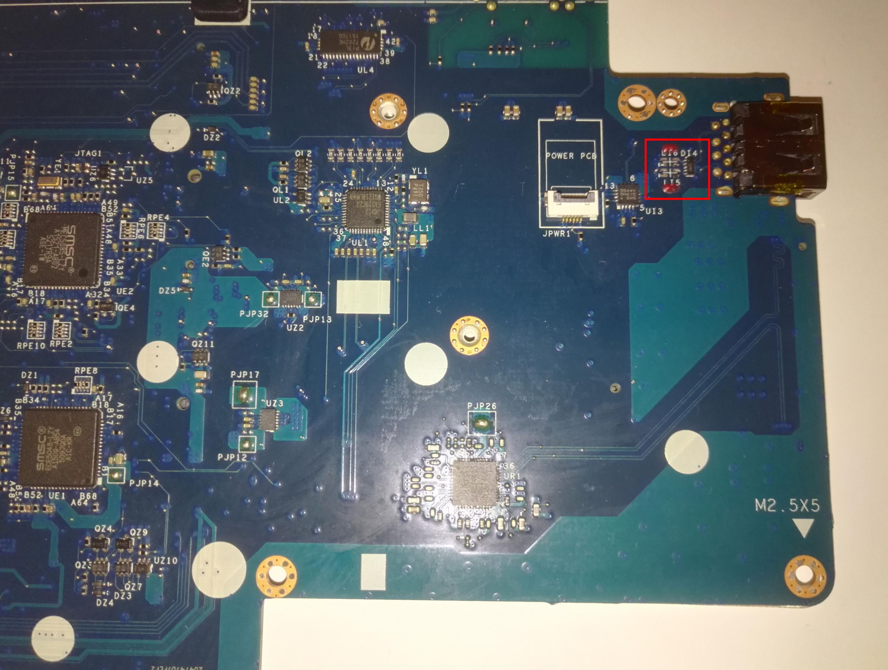

              I have had a close look at the mobo. 2 chips are missing in LI5 and LI6 (see pictures attached).
              According to the Schematics (attached) the parts are DLW21HN900HQ2L_4P.
              They are Chip Common Mode Choke Coils (datasheet is attached).
              I have no idea what these chips are (lol). Instead of replacing them, can I possibly bridge pads, just to see if the motherboard will boot?

                  Re: Dell E5550 (LA-A911P Rev 1.0) - strange behavior
                  Hello Techtiger,
                  I have looked for pictures of the motherboard and the coils are present on a factory motherboard (see picture attached). I definitely think they are missing on my motherboard. Having said that, I have no idea if the missing coils are responsible for the motherboard failure.
                  The USB port with the missing coils is the only one that will turn on a lamp led steadily. On the other two USB ports the lamp will only flash for a split second when charger is plugged in.
                  I suspect there is something wrong here and I would still like to bypass those coils if it's safe (jumper wire?).
