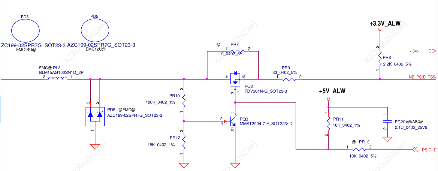

        What is the voltage to ground of PR9 - check both sides of this resistor.
        Remove all power. Check the resistance to ground of PL3.
        Check the resistance across PR9 resistor. This should be ~33R = 33 ohms.
        PQ2 may be defective. This is a common fault. First confirm that the PL3 side of the circuit is not shorted due to the TVS diodes @ PD5. If there is a low resistance to ground on the PL3 to ground then remove PD5 and check the resistance again.
        If the resistance is ok and you also see a voltage on PR9 then consider to bypass PQ2 but only for testing. Download the datasheet of this mosfet to study which pin is source / drain for the bypass testing. This mosfet is acting like an over voltage crowbar. If the power adapter voltage is too high, the gate pin will force this mosfet to power off. Best to replace PQ2 if the bypass test works for your case.
        Update: Confirm that you have a stable +3.3V_ALW rail.
        Click image for larger version  Name:	PSID.png Views:	0 Size:	105.9 KB ID:	3319724
