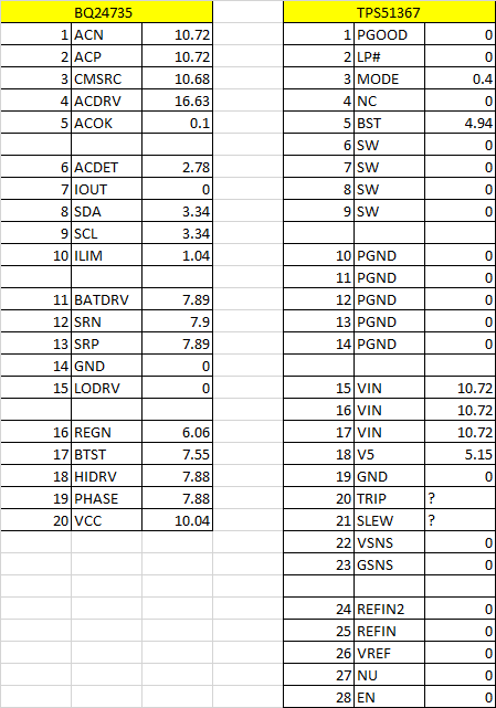

      Hi, thank you for your reply!
      I further analyzed the situation.
      Today, with battery attached, the behavior of the motherboard was (somehow) a bit different.
      Infact, the "hot" components never become hot, and sometimes it was not necessary to simulate the power button to make 5V and 3.3V show up. When this was not the case, 5V and 3.3V were present right after the power cord was connected, and then went to 0V in some seconds.
      I checked the voltages at the two ICs (image attached).
      Basically TPS51367 is not powering on ... EN is 0V and VREF is 0V (well, this is actually not really exciting ...).
      BQ24735 seems fine, i think that ACOK is 0V just because it seems there's no pull up resistor.
