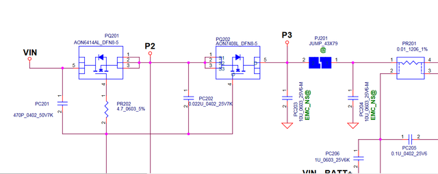

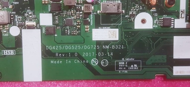

    Hi this board has no power if I plugged the charger but If I put voltage over the P2 section it will power on the unit , I already change the PQ6414A (pq201) but it wont pass the voltge to the pin 3 ,
    those the PU201is faulty ?
    how can it be identified?
    Link to schematic -> https://www.badcaps.net/forum/showthread.php?t=116545

    What is the voltage on PU201 pin 28 6 4 6 5

      You need to measure BQ24780s pins specially ACP/ACN/ACOK/ACDRV/ACDET/VCC/REGN/PMON/ADP_I pins.

        First check if PQ202 is shorted drain/source/gate.

          pq202 not shorted from pin 1 and 4
            pin 28 20v
            pin 6 2.8v
            pin 4 1.3v
            pin 5 no voltage
            pin 1 1.5v

              ACDRV is low PIN 4 1.3V it should be arround +22V above & PIN 5 ACOK +0V what is the voltage on pin 24 BQ2478 check PC214 for any fault & PR202/206 ?

                SORRY but id fount out the big problem it created a shorted on its board direct short to be exact, its not in the component problem now, its a trash board , but thansk fotr the help every one, Gob Bless .
