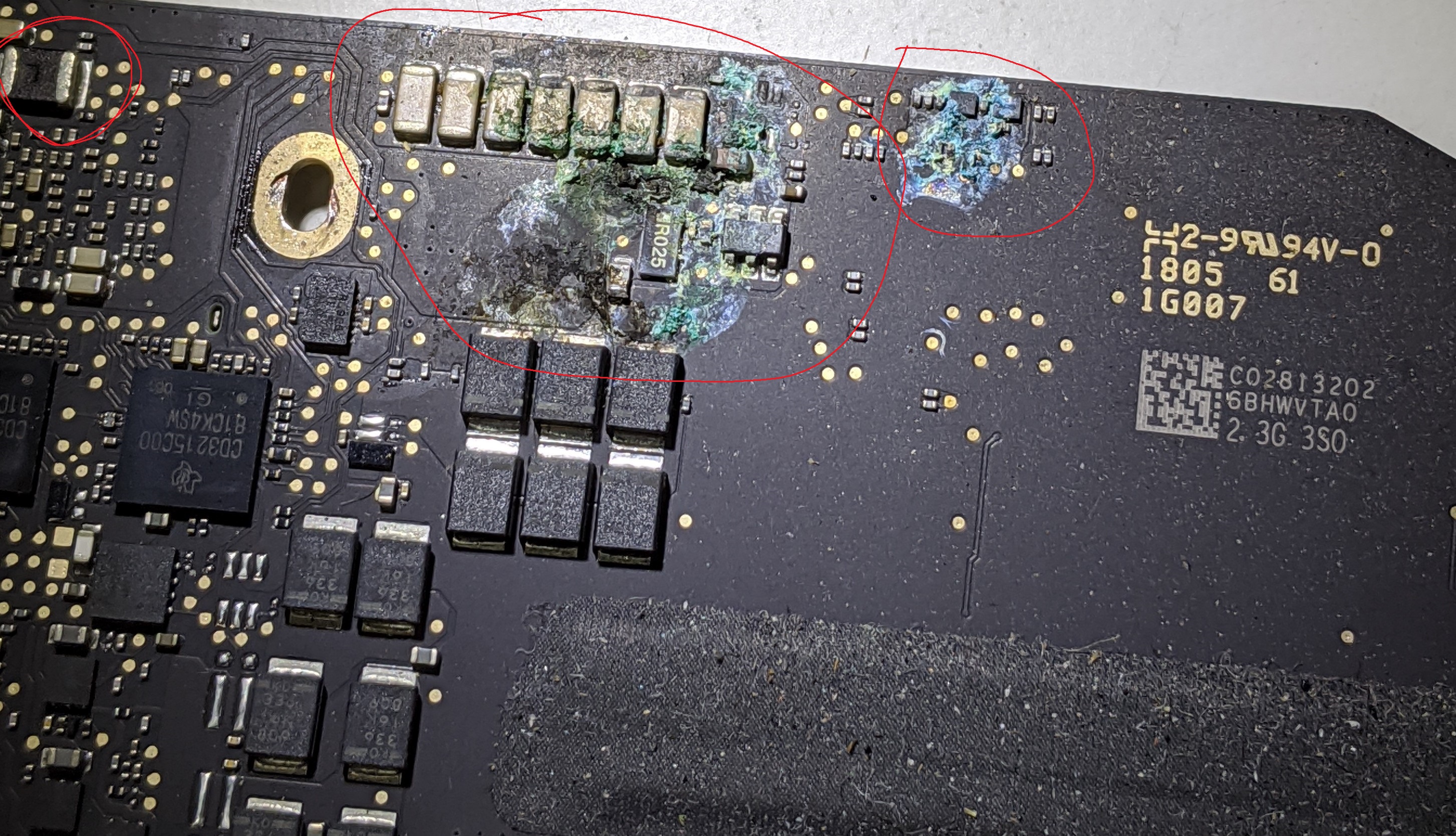

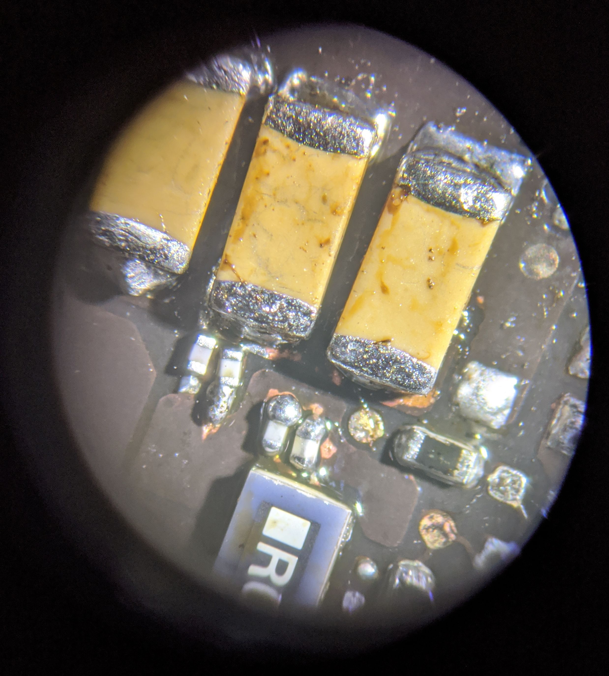

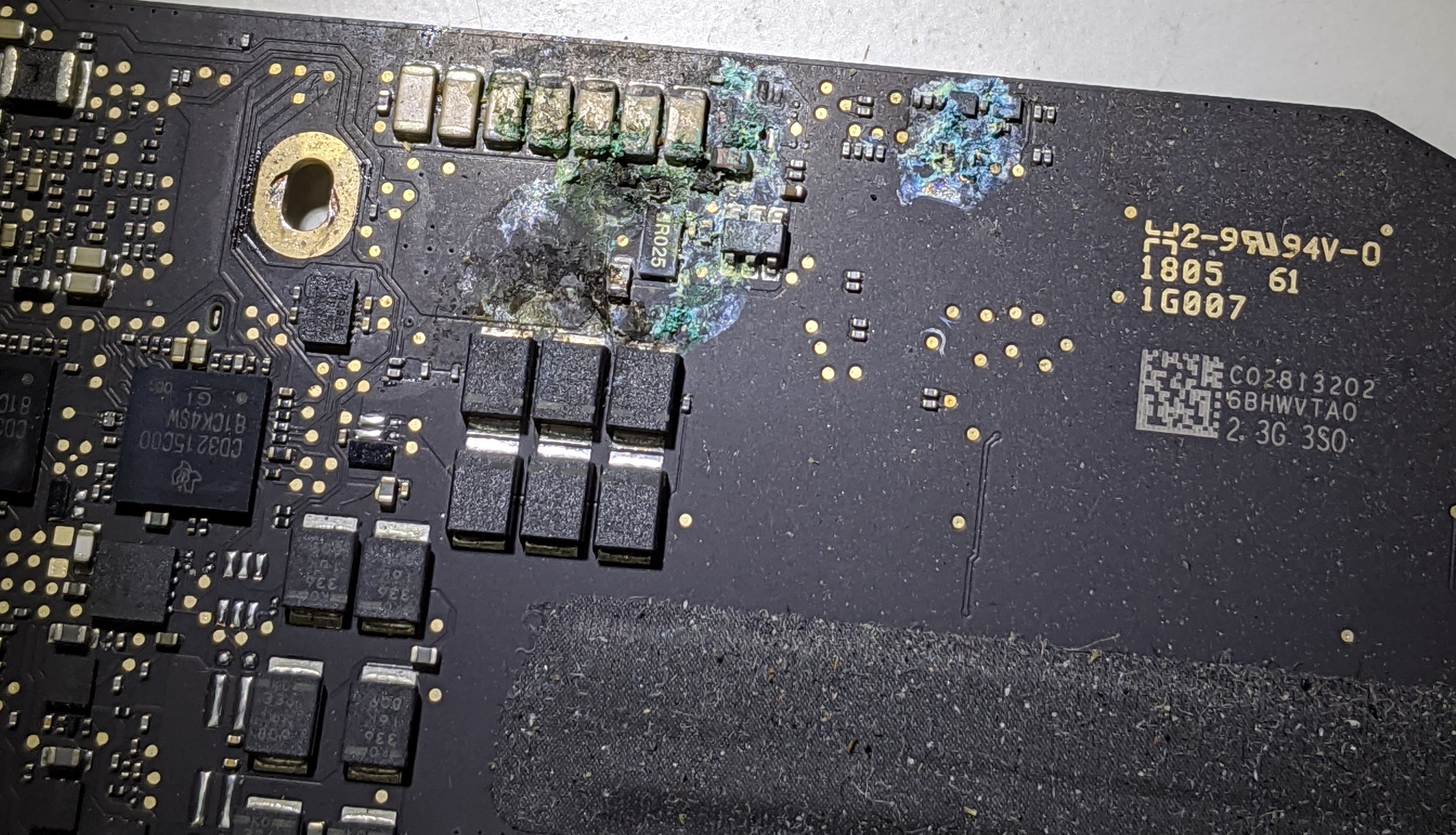

    820-00840 with liquid damage. System powers on and works with external display but no backlight or image on built in display.

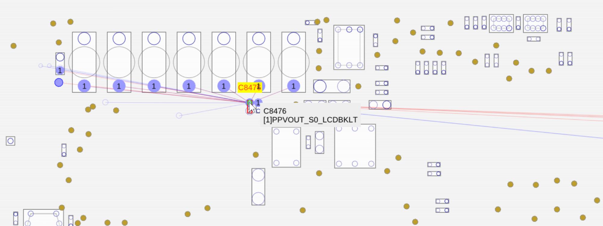

    Damage was concentrated in backlight area of the board, in particular C8476 PPVOUT_S0_LCDBKLT which was completely melted and trace damaged.

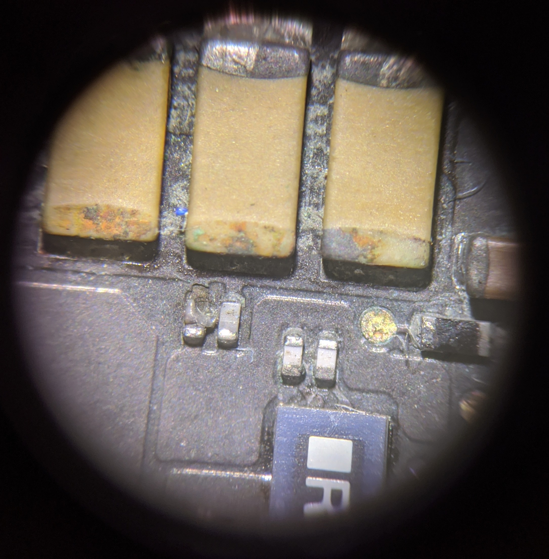

    On the bottom of the board I've replaced the following damaged components:
    C8475, C8763, C8460, C8462, C8465, C8468, R8401, C8412, R3893, R3894
    On the top of the board I've replaced:
    C8473, C8474, C8478, C8479
    Wondering if maybe Q8400 is bad, but it looks OK after cleaning.

        Re: MacBook 820-00840 Liquid Damage
        clean the infected are with water spill with isopropyl alchool like we always do. then with a microscope check carefully if any track on resistor, chip is ok or gor ripped of after corrotion.
        remove temporanely some component, apply flux and fresh solder on the pads and see if they are ok. solder component back and check the voltage that supply lcd backlight to the screen.
        on the picture there are at least 2 area that need carefully be inspected.
        check very well under scope or big magnifier marked zone for any broken track
        check also component on top left marked in red if it's ok...
