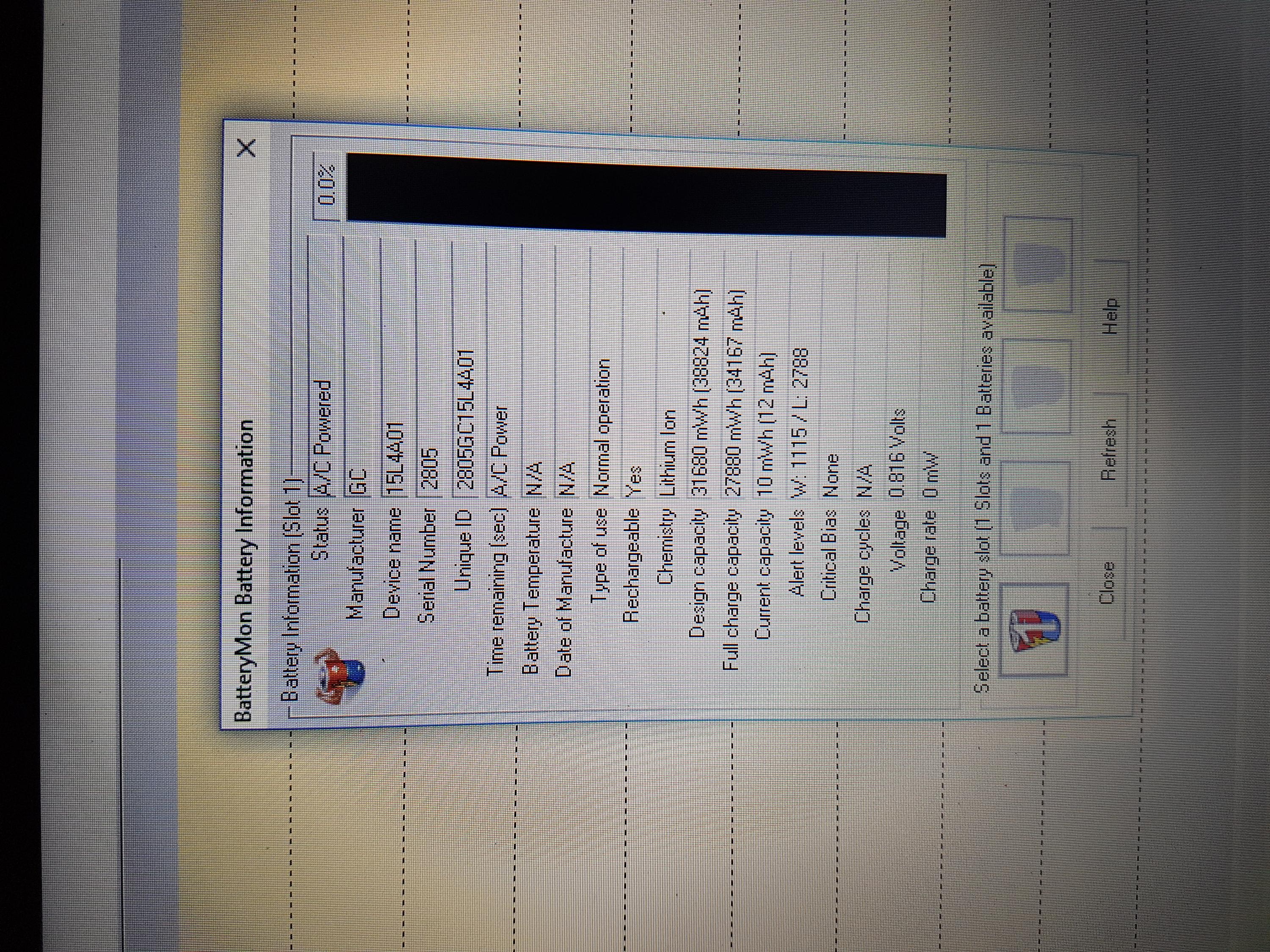

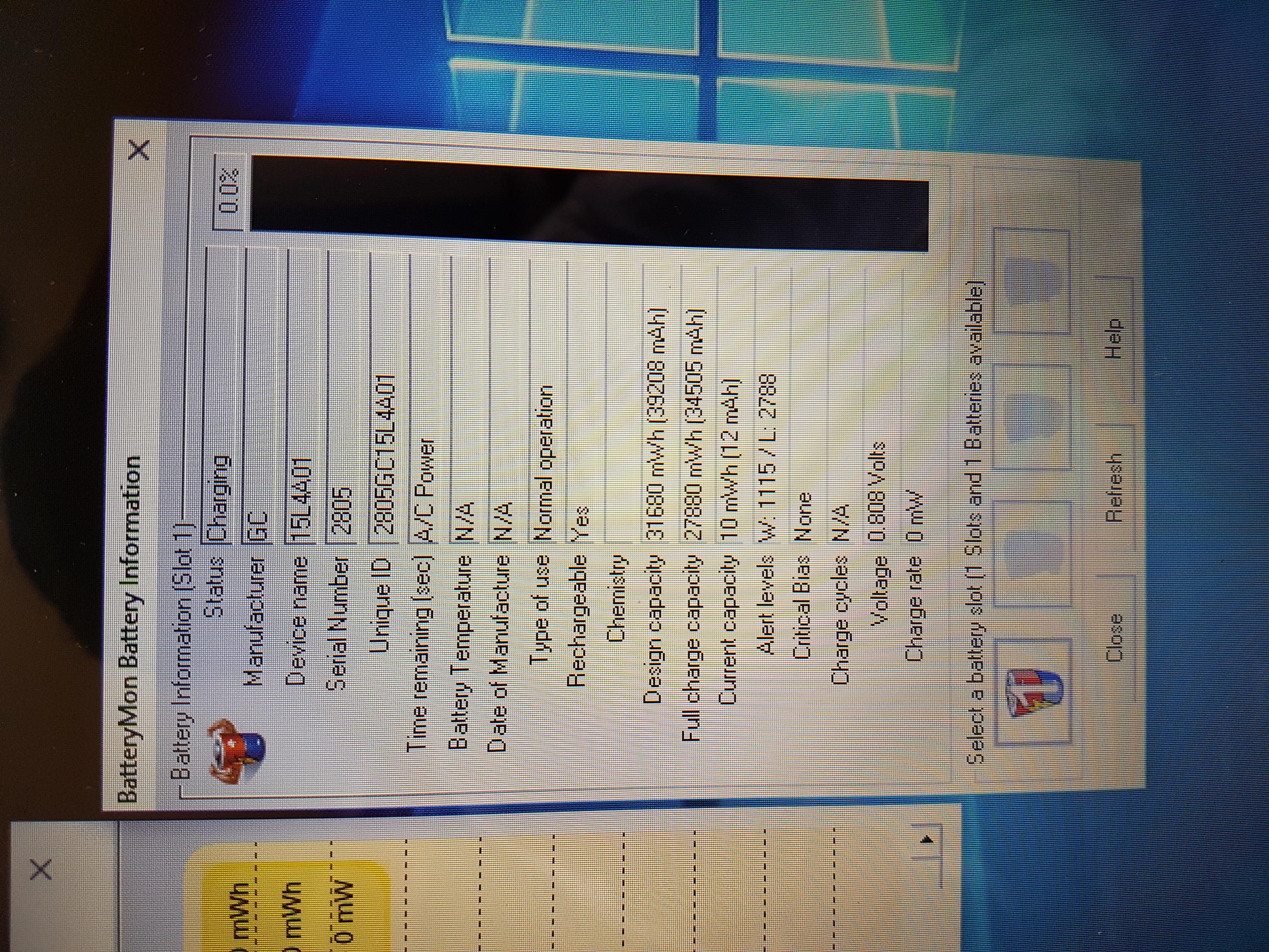

                        Re: Lenovo ideapad 100-15IBD battery issue
                        Please find attached picture of battery monitor results.
                        Plugged in and charging -> result when windows first loads
                        Plugged in not charging -> result after 30ish seconds

                              Battery voltage = 0.808V.... This battery is just dead and needs to be replaced, try with known good one.
