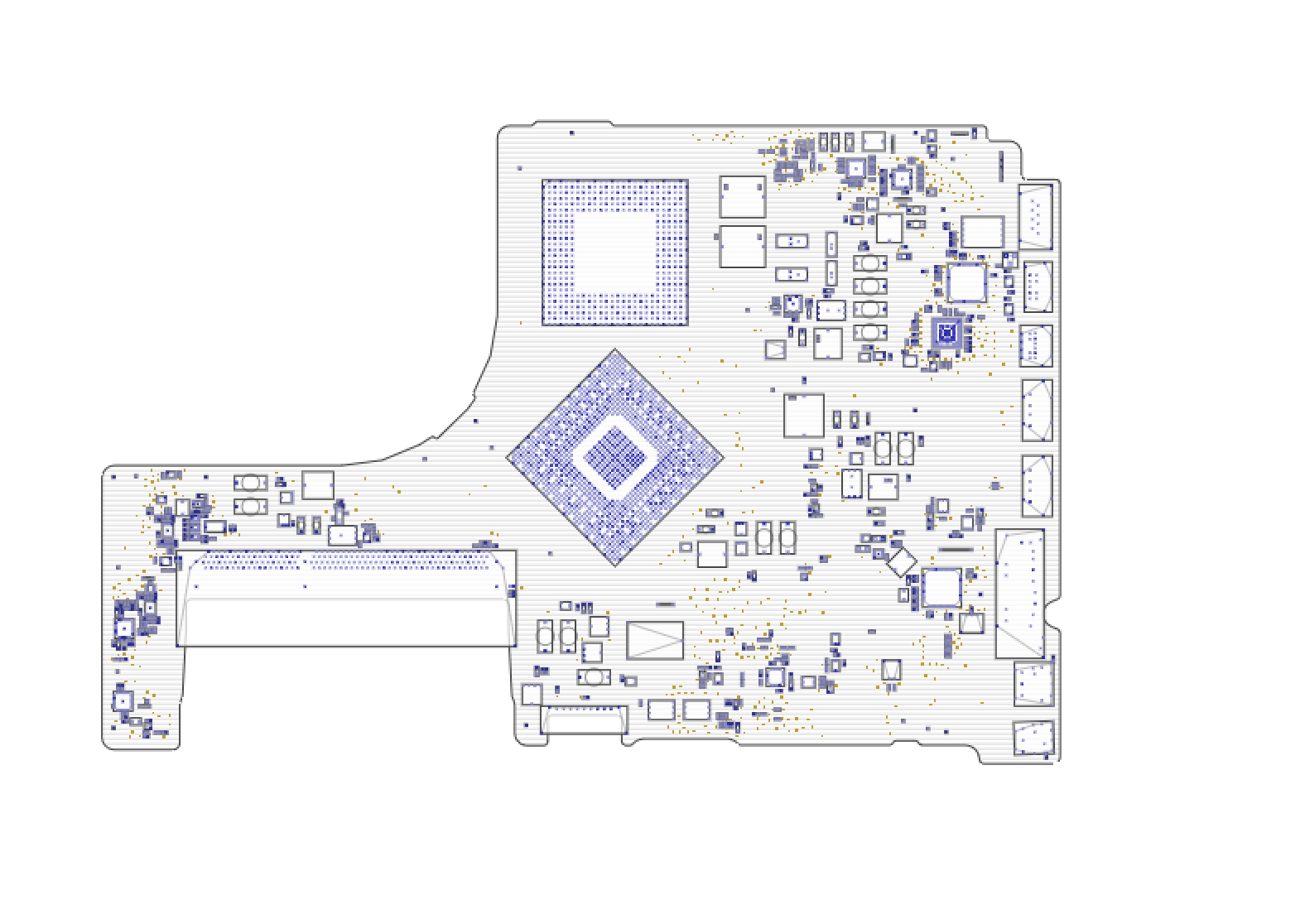

    Dear all,
    When I try to locate components, Openboardview shows other side's components making me very difficult to locate the components needed. The board I am trying is 820-2533. The file is attached herewith.

        Re: Openboardview shows other side components
        Thank you but flipping or mirroring does not solving the problem. Just check the image given below
          You didn't flip the boardview.
            I have it looking correct on my screen. If I click mirror then flip it looks like your image.
            Clicking mirror then flip gets it back to looking as it should

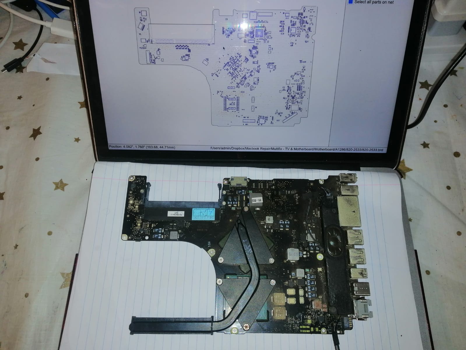

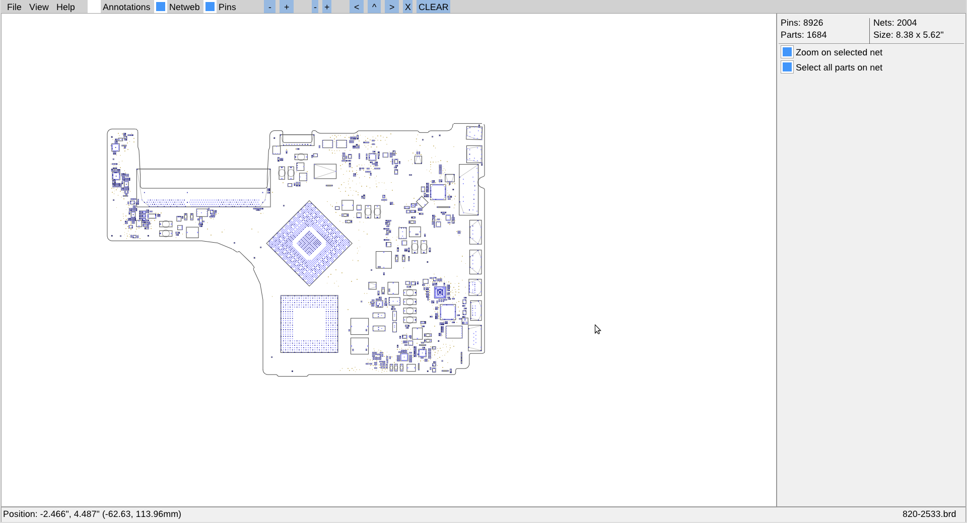

              Sorry. Flip gives this (see attached).
              I am using the mac version. Is that the issue.
                Got it right with a combination of mirror, flip and rotate. Not sure which order followed
