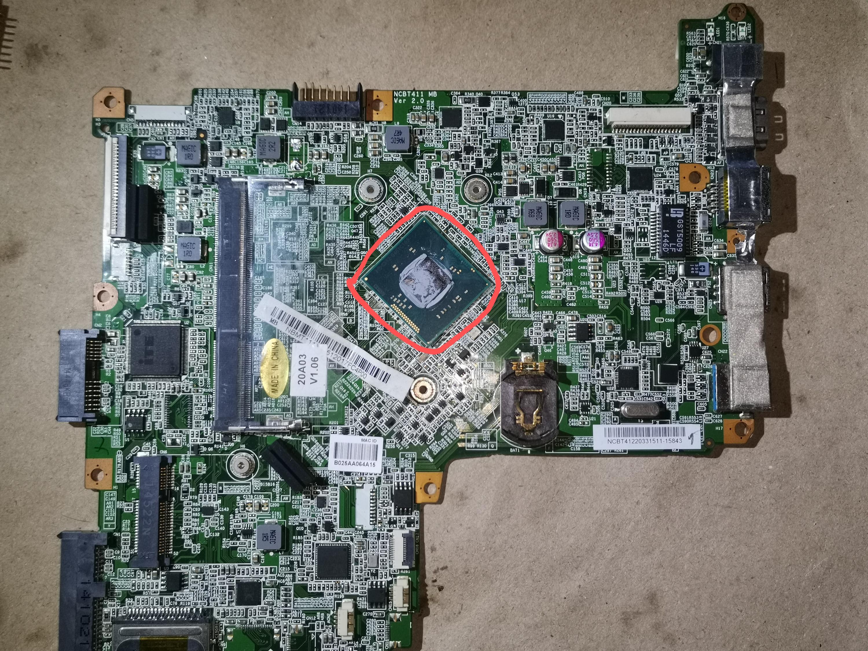

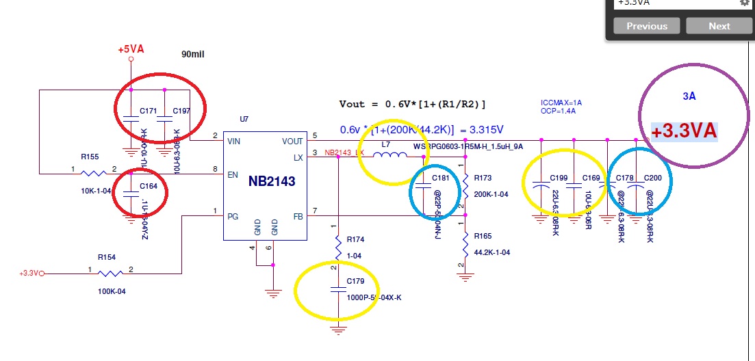

    Good day everyone. I have an Acer One 14 (Z1401-C9JN) with board model NCBT411 ver 2.0, that's missing 3.3va. It has a 5v to 3.3v converter which is supplied by 5va.
    As you can see in the image, 5va is present on red circle c171, c197 and c164. But no output on L7 coil. Found out that output rail is shorted to ground. I removed c179, c199 and c169 cirlced in yellow but short still remain. components circled in light blue is not present (na). It's still shorted even after I removed ic u7.
    Does that mean I need to check all components that is supplied by 3.3va to find short? For the start I removed ic u20. Short still there.

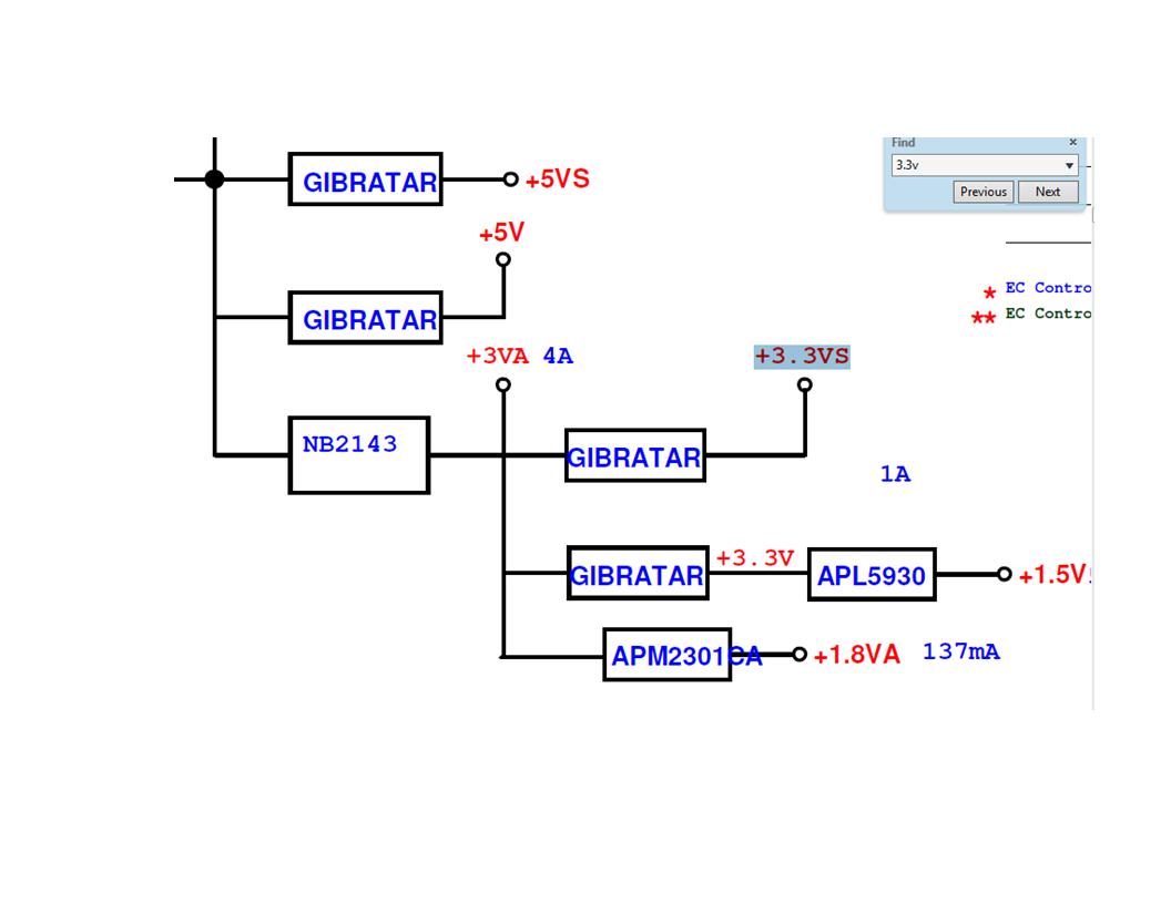

    I have attached schematic here. Hope to hear some advice. Thanks

    locate shorted component by injecting 3V 2A and check for heating component by hand and if u locate area pour some IPA to locate burning component
    if u cannot locate area go higher with current because if u have shorted big IC it can dissipate a lot of heat

        in my opinion for short circuit i started first with 1v 1A oncrease the wattage as you progress too much wattage can burn off small pcb tracks .. trace all the circuit that uses 3.3v

          not needed to start with 1V on 3.3V rail. this voltage u r using only on main 19V rail when u dont know if u have shorted highside mosfet so u need to start on 1V because of CPU and GPU
          1Vx1A= 1W that is way too small heat to feel it

                        Only the processor is installed on this motherboard. Please check image.
                        I got new development. I cleaned motherboard with 90% isoprophyl. Now 5v and 3.3v are present. When I press power button laptop turns on but turns off after 10 to 12 seconds initially.
                        I'm checking diagram for power sequence to see if any voltage missing. I'll get back soon. Thanks. Spider.

                          Your board is NCBT411 and schematic is for NCBT419, are they similar?
                          Glad to hear you have 3.3V again though. Any history of the laptop? Was it water damaged, etc?

                            So far everything looks similar and also I found this pdf here but its difficult to navigate as it redirects to some page.
