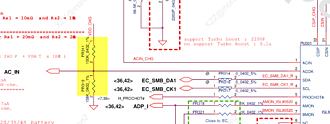

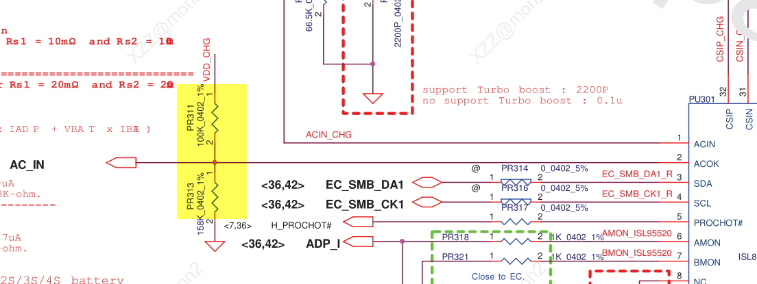

                                  AC_IN 0.05v
                                  Review this. This is mated to ACOK on your charger IC pin # 2.
                                  Measure the voltage on PR311.
                                  Remove all power. Measure the resistance across PR311.
                                  ACIN pin #1 has a valid adapter voltage (ACIN_CHG = 4.50v). Based on this voltage, ACOK should be floating since this is an open-drain output. When the line is floating, the 2 resistors @ PR311 & PR313 will build a voltage divider to park this floating line. At this time, the AC_IN signal line is @ 0v. If the charger truly does not like the adapter voltage, the charger IC will pull this line to the logic low = 0v but to me, it is ok and there should be a valid voltage here unless the parking resistors are missing or of the wrong values.
                                  Click image for larger version  Name:	ac_in.png Views:	0 Size:	114.4 KB ID:	3691265

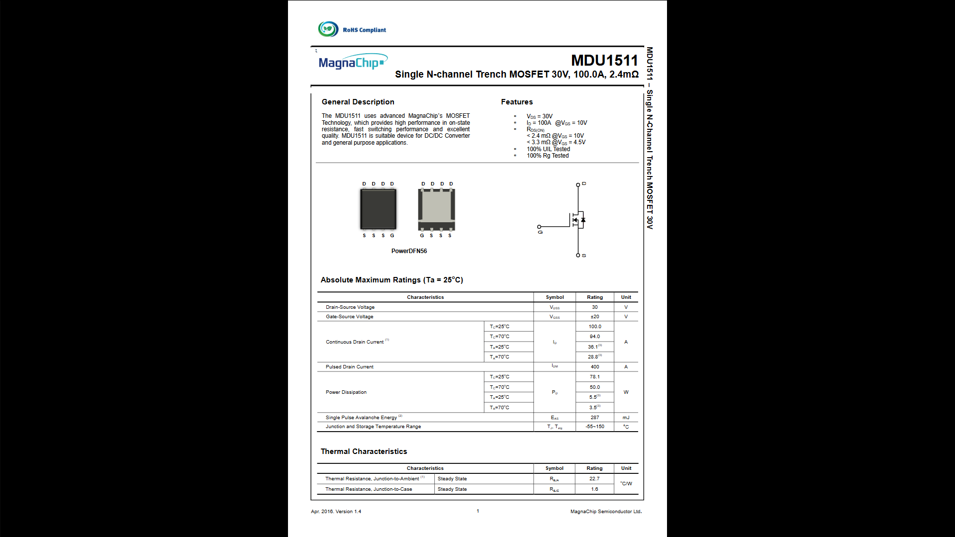

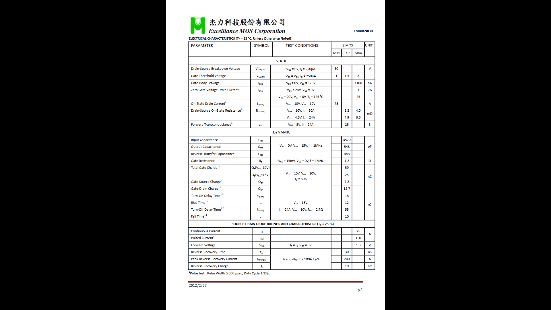

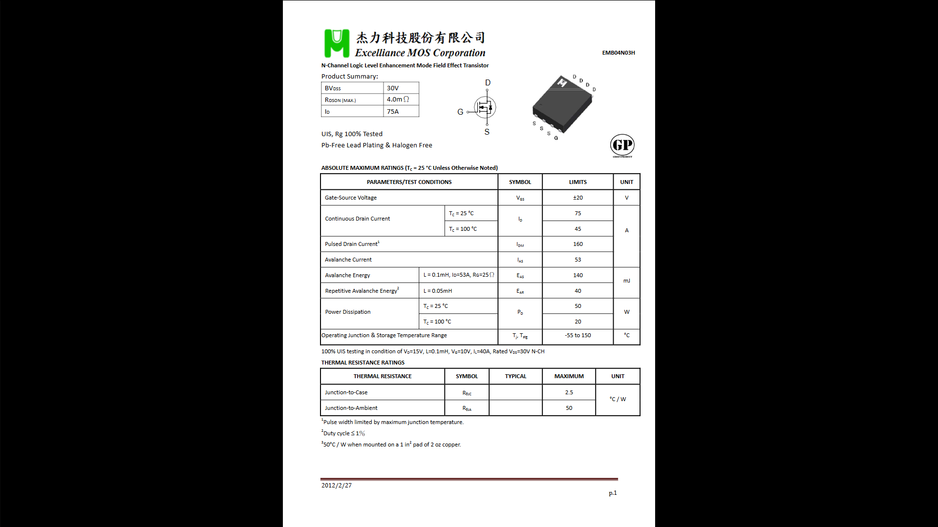

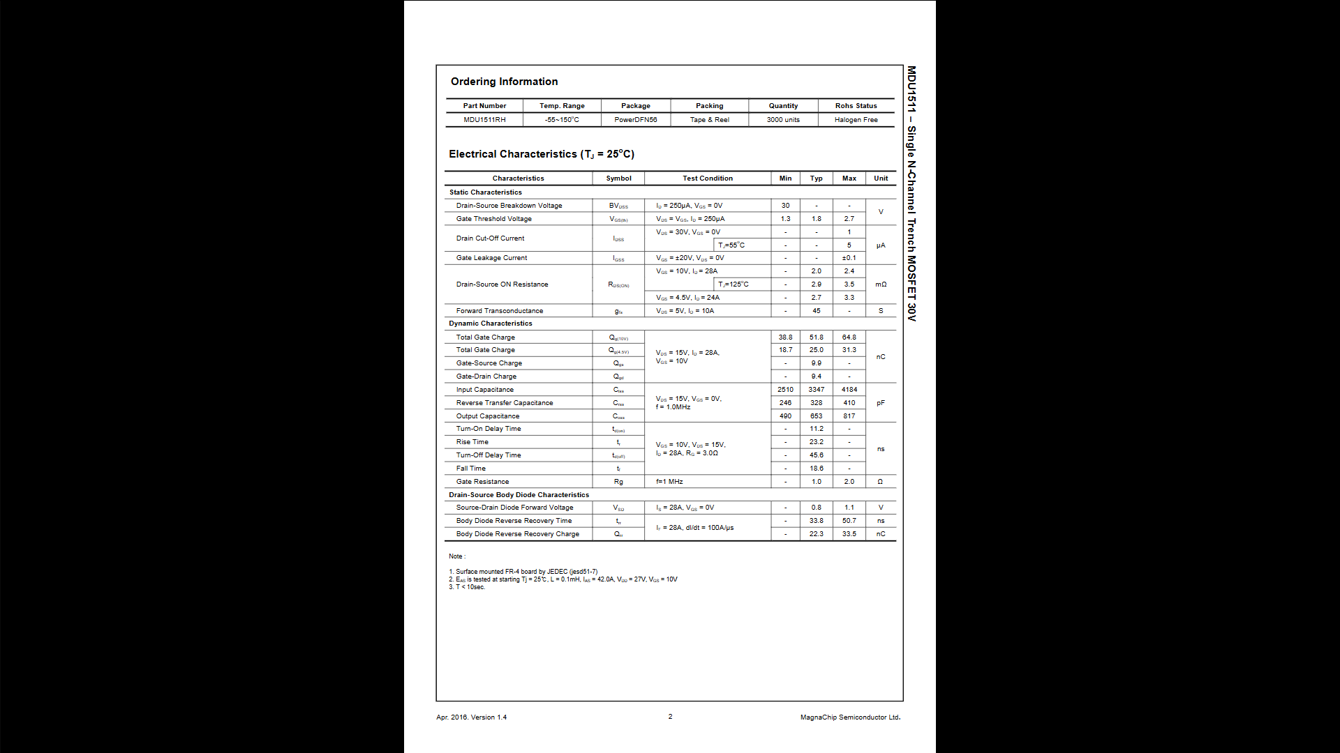

                                    Sorry for the confusion on my post. +3VLP and +19VP were present before I found a jumper wire below the first mosfet. I replaced the mosfet, and now 19V is not passing through the first mosfet. The problem I have now.
                                    I use mdu1511 to replace EMB04N03H. I don't really think if this is compatible.
                                    I attached value of each mosfets
                                    The resistance of PR304 is 0 ohm, and PR305 is 1.5 ohm. The measurement of VDD to ground is 90k ohms.
                                    Is it that one of the resistors is faulty?
                                      PR311 reading is 65Kohms
                                      in ground 95K ohms in both legs
                                      • mon2
                                        • Dec 2019
                                        • 14662
                                        Confirm that VDD_CHG is present on the one side of PR311. This is important. Measure this voltage to ground.
